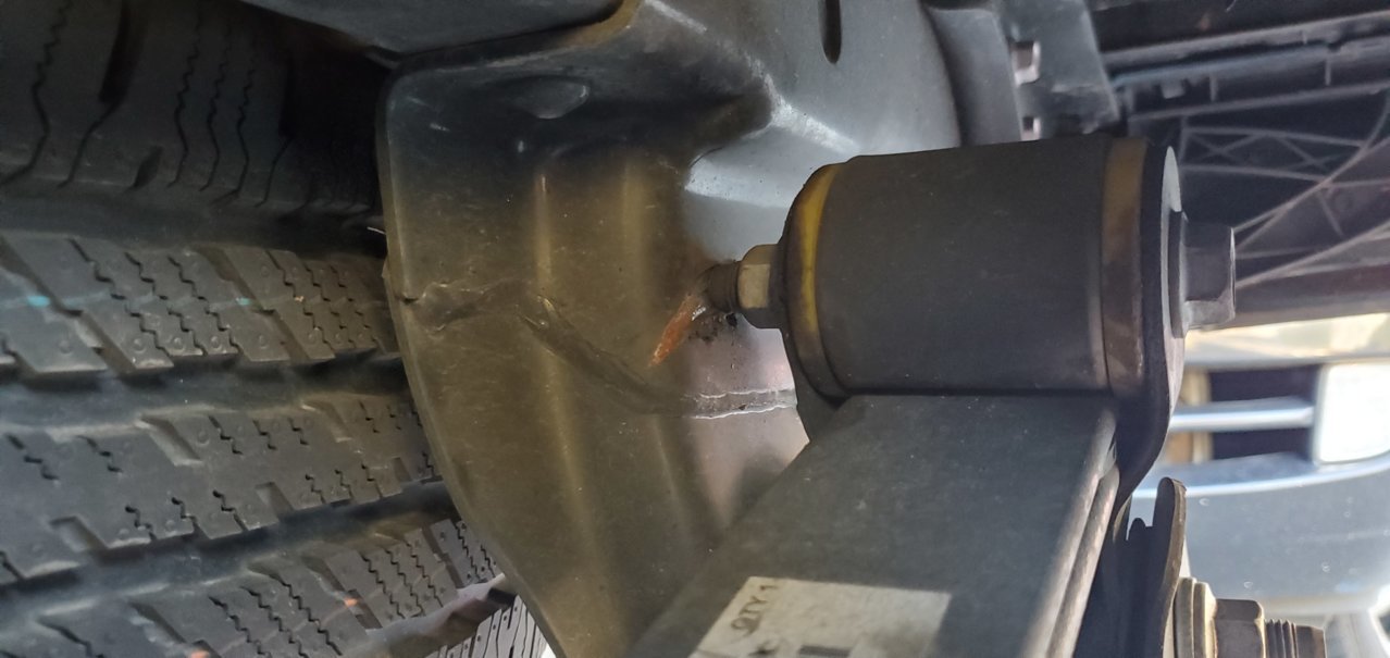

    BudFriendguy
    BudFriendguy [OP] TRD BRGLR
    Feb 5, 2021
    #355148
    3,403
    Zak
    Portland, Oregon >> Cleveland, Ohio
    2021 TRD Sport ACLB 4WD 6MT V6 Voodoo Blue
    Found this a few weeks later:
    Anybody see anything... off... there?
    Such garbage work it truly feels malicious.

    #66
    Sonofliberty92
    Sonofliberty92 T O Y O T A
    Sep 20, 2021
    #377626
    1,066
    Mark
    Maryland 4 South
    2014 DCSB TRD OR, 2005 Tundra V8 4WD
    The frame weld joints on my 15 have surface rust in many places. Though my truck lives in a salt state and is 7 years old. They weld these frames together and don't clean the welds properly. The paint will flake off over time and cause surface rust. Fluid Film it yearly. It will stop the rust and repel water/salt.
    As for the body paint peel and rust, I haven't seen that on such a new vehicle before.

    #67
    DTaco18
    DTaco18 Well-Known Member
    Oct 20, 2018
    #270030
    1,029
    2025 TRD SPORT DCSB 8AT CSM
    Wow. That's crazy.
    You'd think they would have heard/felt the bolt rubbing when they put it together, and then flipped it around...
    Looks like the gouge is pretty deep now.

    BudFriendguy
    Feb 5, 2021
    #355148
    3,403
    Zak
    Maybe just a bit, yeah:rofl:
    I laugh so I don't cry
  10. Jan 26, 2022 at 9:48 PM
    #70
    BudFriendguy
    Feb 5, 2021
    #355148
    3,403
    Zak
    I can't imagine you wouldn't notice that the second the shackle resisted the install. Nothing a few ugga duggas and a fuckit bucket couldn't solve, apparently...

    #73
    ImBAVID
    ImBAVID Well-Known Member
    Sep 3, 2021
    #376127
    104
    David
    Utah
    19 Tacoma Pro
    Dobinsons MMR 3" Suspension BAMF Front Bumper UpTop Bed Rack Desert Armor Tank RTT Baja Designs Lights All Over Cali Raised Rock Sliders
    just an fyi, the bending of those panels up front is required to get that long uca bolt out...horrible design from toyota. This is the first time I've read or heard of someone possibly cutting the bolt and reversing it in place (not sure if that would be easier with the limited space you have in the wheel well). But every shop and video I've seen shows you this and tells you that's how you do it. And that bolt for the leafs, that's an oversight from the suspension manufacturer. Dobinsons is the same way and someone brought it up to their attention on here and it seems they fixed the bolt length because I've got about an inch or two before the bolt can touch the gas tank after doing my install last month. But after seeing that rust on the panel up front, I'm definitely going to check mine..because it was an absolute pita getting those bolts out and I ended up just having to man handle it without any worry of scratches. It also requires hammering the panels back in to straighten them out.

    ImBAVID
    Sep 3, 2021
    #376127
    104
    David
    Utah
    19 Tacoma Pro
    I'm not trying to defend that shops work at all. I'd be pissed too. But that uca bolt is the standard practice for removal.

    Matt Sierra
    Matt Sierra Well-Known Member
    Nov 14, 2020
    #346723
    236
    NorCal
    2020 TRD Pro MT
    Maggy SC, C4 Overland front bumper
    I don't think the OP was upset about the panel bending, mostly about the battery leak caused by battery box being tightened down by a guy who must have done the oil drain plugs at Jiffy Lube in his previous job.
    About the leaf bolt, I can see it a couple of different ways, but if I dropped over 2 grand for a shop suspension install, I'd want them to at least give me a heads up if a bolt in the kit seemed missized. When I do something myself, at least I know when something doesn't fit quite right and if I ignore it, I'm (at least subconsciously) accepting the consequences. Seems to me like shops should do the same, particularly when it's likely to cause some suspension noise. The shop I worked with to rebuild the 22re on my '90 was very communicative, I pretty much always went with their recommendations, but I liked being given the choice.
    Feb 5, 2021
    #355148
    3,403
    Zak
    I ain't no expert by a long shot, but I believe the bolt is backwards, not a manufacture defect.
