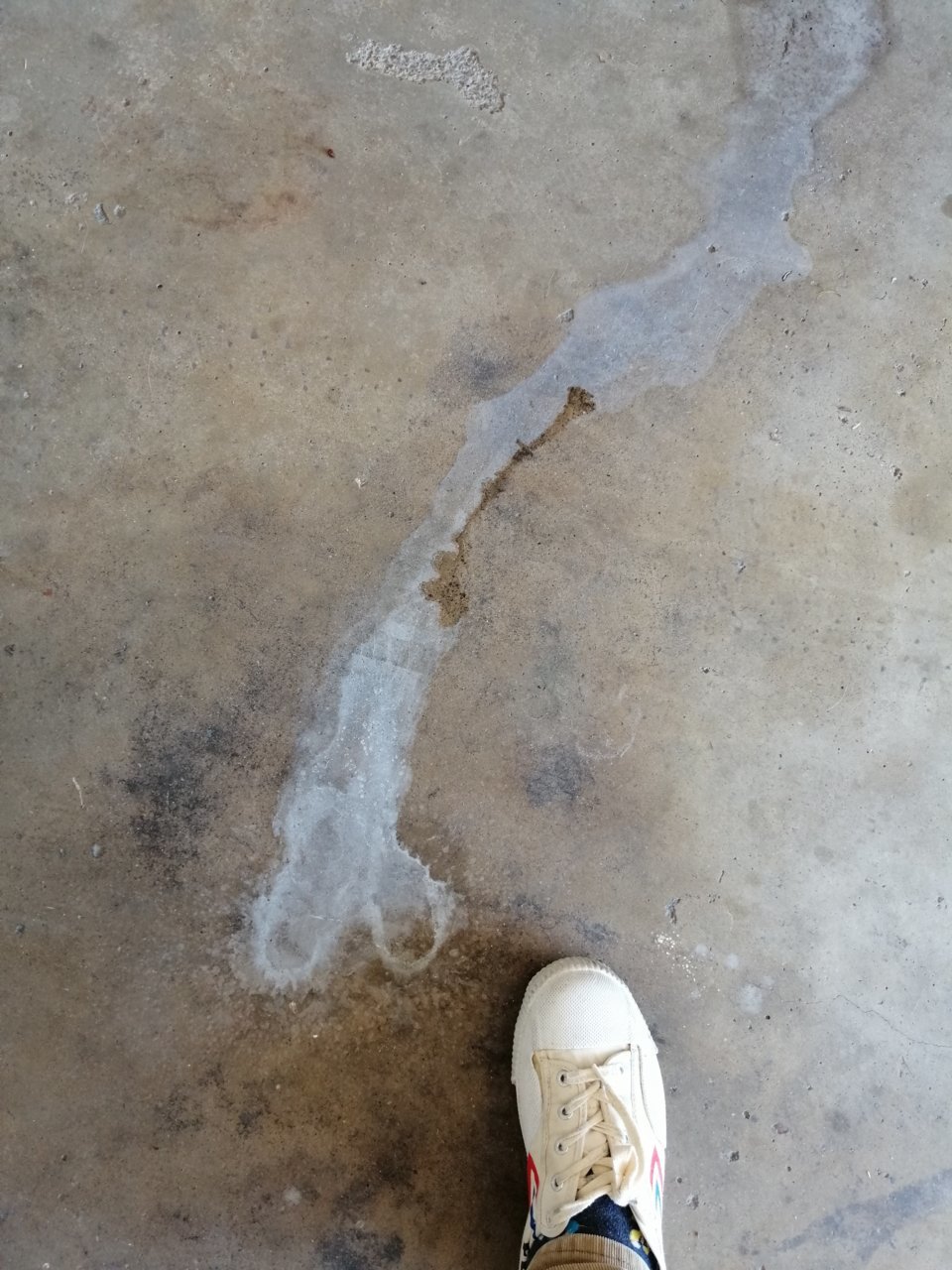

    Hello there! I recently bought a 2021 Tacoma SR 4 cylinders. About 10 miles after leaving the dealership the Check Engine Light turned on. I brought the truck back the following day and they "fixed" it in about 20 minutes. That same day the Check Engine Light turned back on. I took the truck back to the dealership again for a second time. They kept it at the dealership over the weekend and I don't when I'll be getting it back. Has anyone experienced this? Any ideas of what's happening? As a matter of low confidence and frustration, I've been reading about the Lemon Law.
    In addition to this, I found this dried stain in my garage. I remember the truck leaking water from using the heater but I became concerned because of the white color to it. The leak came from the bottom of the passenger seat. Some where around that area. Isn't the AC filter and components inside the glove box? Any thoughts about the stain?
    Thanks for your help.

    Looks like dried coolant. Could be a coolant leak and low coolant throwing the CEL.

    As for the leak, that just looks like water to me but again it's anyone's guess as to where that came from without knowing what fluid it is or seeing where the leak on the truck is at.

    a loose gas cap will throw a ‘ CEL ‘ 1
    check ALL fluids & caps to all .........
    not sure about the stains onUr garage floor
