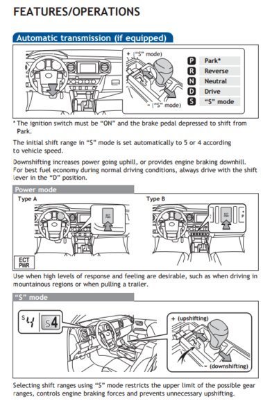

    The 3rd Tacoma AT is different than most other vehicles out there, 5th and 6th are both OD gears whereas most 6 speed transmissions only have one OD gear. Some people will change the transmission logic with OV tune but that doesnt change the gear ratios. Below are the ratios for 3rd gen trucks.
    1st gen trucks have an OD Off button on the shifter to prevent the transmission from accessing the OD 5th gear, S mode on the 3rd gen trucks can limit one or both OD gears depending on the situation. According to the manual, putting the truck in D is recommended for optimal fuel savings so the transmission logic will always try and select the highest gear. I consider D as an ECO mode so I use it for flat highway at speeds that dont cause the truck to toggle between gears. If the truck can't make up its mind what gear to be in due to headwinds or terrain, I bump it to S5 or S4 and remove one or both choices. The manual even states to "use S mode to reduce unnecessary upshifting."downloadfile.jpg
    The transmission is configurable whether you like it or not, throwing it into D may not be the best configuration for every situation unlike most other cars you've driven in the past. Once you learn the different combinations using Smode and the ECT button the truck's performance starts to shine. If it's not something you're willing to learn or put up with then sell it for something that has a single OD gear and drives the way you're used to.
