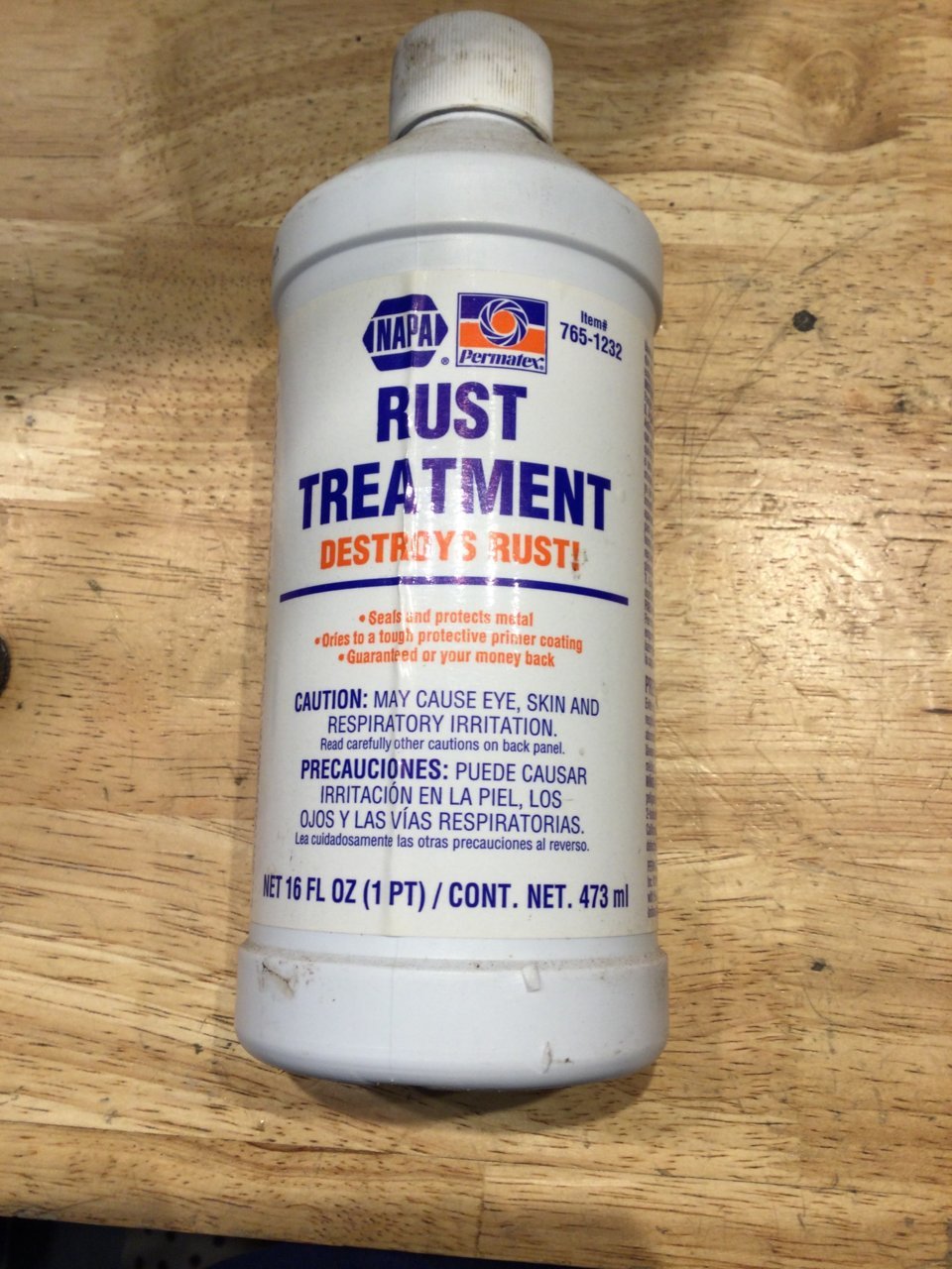

  20. Aug 25, 2023 at 10:28 AM
    #60
    Captqc
    Captqc Well-Known Member
    Mar 5, 2017
    #212458
    5,150
    Tigard, OR
    2017 Tacoma 4x4 TRD AC Off Road
    This stuff works by chemically changing the rust. Been using it for years with great results.
    TacoFranz[OP] likes this.
