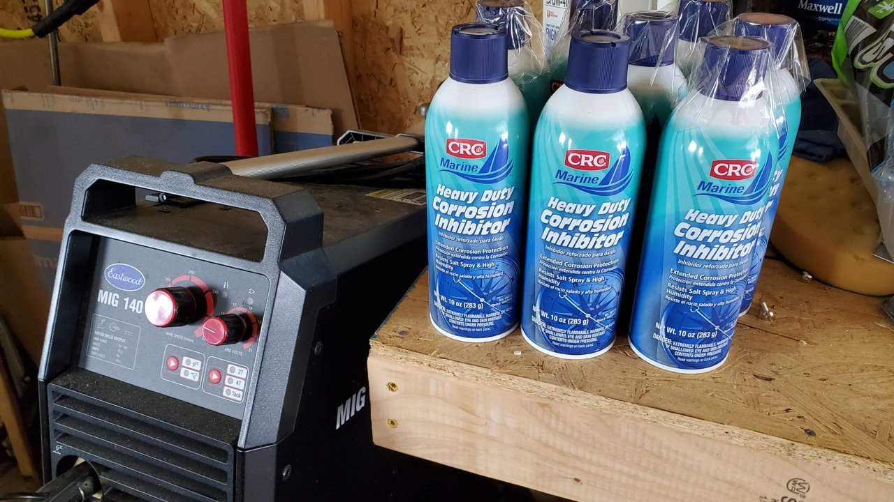

    Don't forget about the CRC stuff!

    nice, thanks for that suggestion. And you are using that stuff? I learned that if you use the right stuff, it turns corrosion black, and then you leave it and it will never rust again... Well, if I remember, like 30 years ago I treated an old VW Bug bumper with some pink stuff and it turned all the rust spots black...

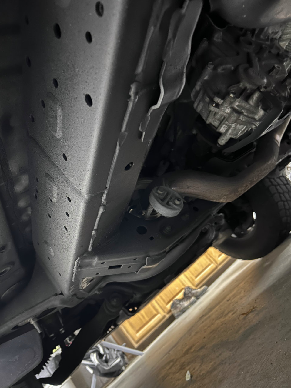

    That's what I used on my 2021, and after two winters my truck looked great underneath.
    Already have more to do my 2022.

    my gosh, that looks awesome. Beautiful. Thanks!

    It does (and any other Cosmoline product) require touch up here and there, but nothing like Fluid Film or the like. Trick is to scrub down the underside thoroughly and let it dry completely before applying.

    Invaluable information. Thanks. Nobody can say there isn't enough info, although sometimes it could also smother you. I pic the CRC option - seems nice and clean. I probably won't even waste my time now to go into my Toyota Dealership Service Department - that's so painful anyway. Pretty sad actually. They should be thrilled to help us TOYOTA enthusiasts. Heck, TW is worth more than the $85 bucks Toyota Service Department Consultation Fee. And it's free!

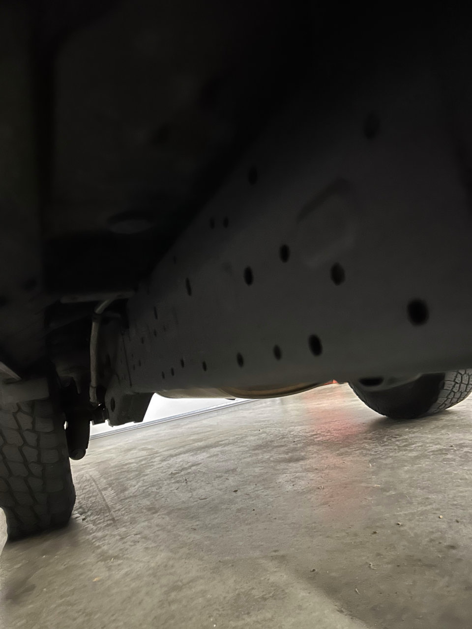

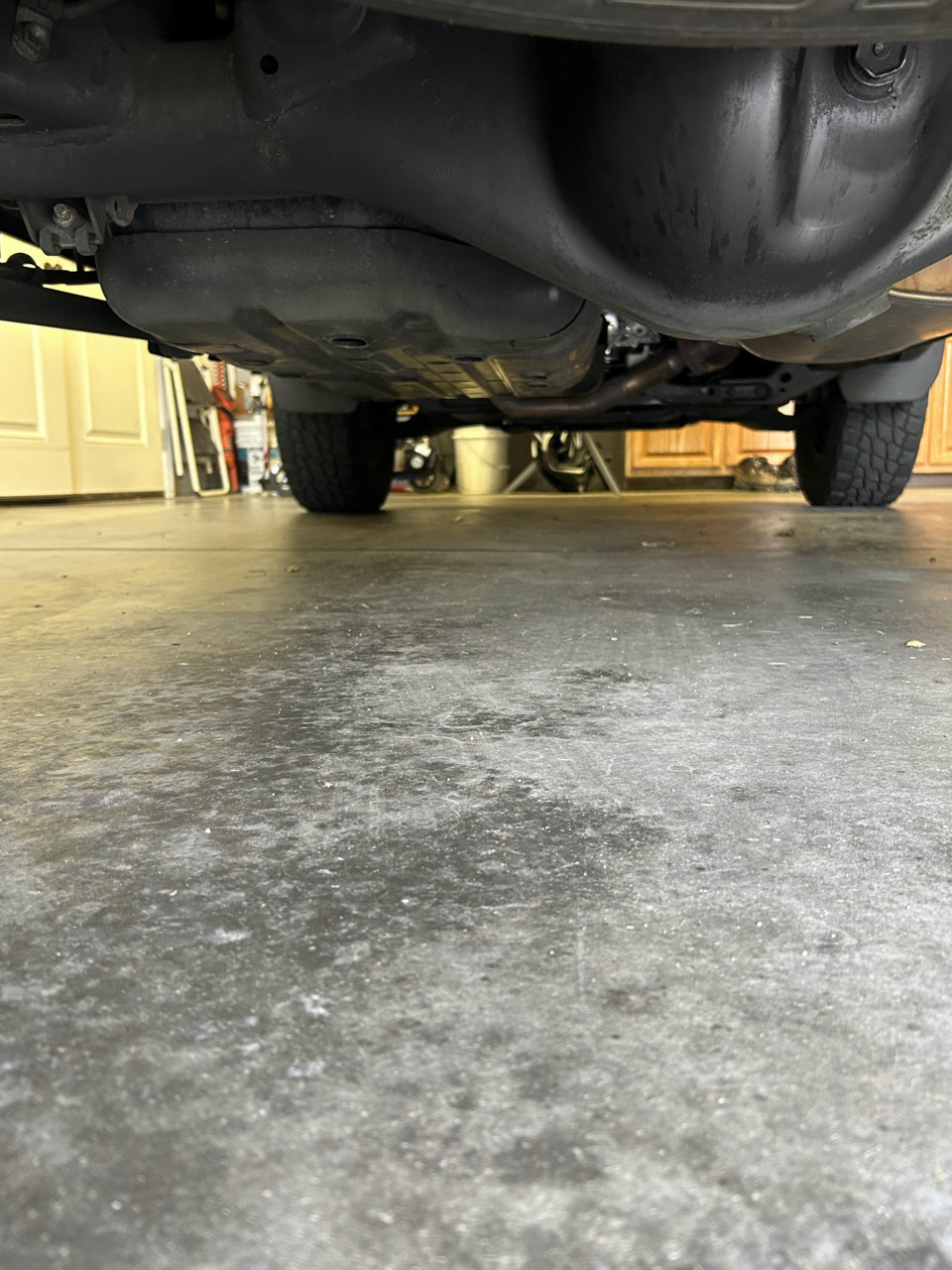

    Here is my 2017 4R with Fluid Film applied/touched up every year for the last 5. I need to hit it again this fall. I have double duty since the Tacoma is going to get sprayed down as well. I think the Tacoma is going to do most of the winter duties this year. In my opinion you really can't go wrong with any of the rust inhibit products.
