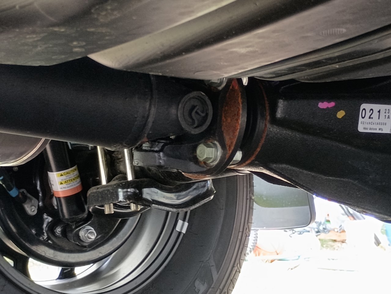

    First day , car did nothing but parked in dealership. They took of plastic covers in front of me and car had barely 10 miles when I purchased it. Its crazy how parked car got rusted, it was not painted there.
    It was only surface rust, but I don't want single dot of rust on my truck after I lost my beloved 2003 4runner due to chassis rust , no other problems on perfect car. Took me 20-30 min to get it all off with sandpaper. Its crazy really.
    What I do now is always sandpaper that rust slowly off welding areas. Then I paint it and after few days I fluid film it. I also pour fluid film in frame holes, tail gate, basically in any area where salt or water can get in and sit hidden from my eyes.
    I also use rubber covers on my bolts, I don't want no rust on my frame.
    But I usually check them every every 2-3 month or so to make sure its not trapping moisture and rusting from inside.

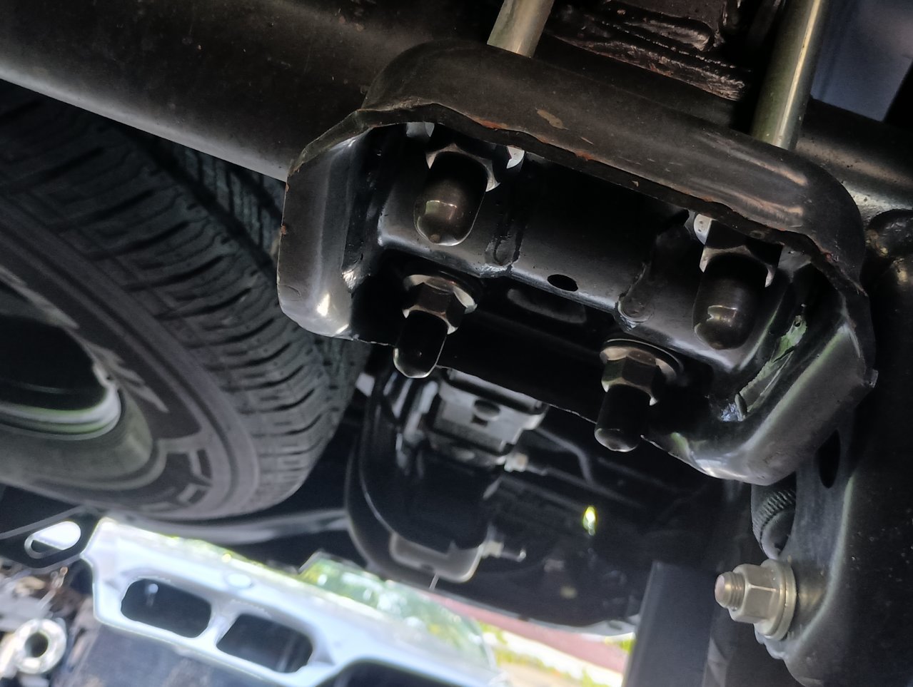

    what are you going to do about the bolt shanks themselves?

    No, NHOU is a mineral oil based undercoating. I know better than to Ziebart it. Thats what Toyota did to my 05 Tundra when it was recalled.

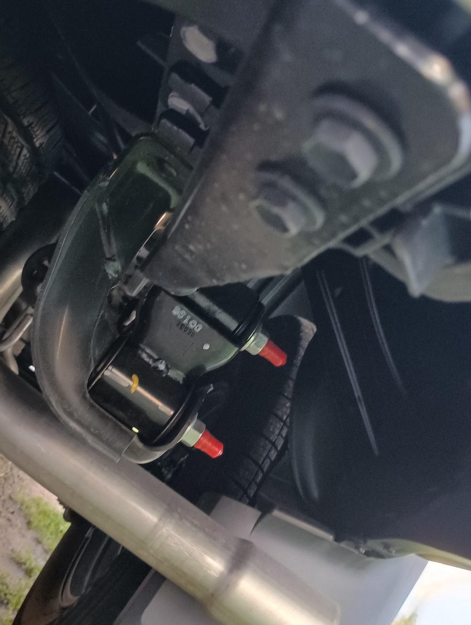

    I could not find anything for it, what I will do for those in winter is fluid film. I was thinking painting maybe but not good idea probably. I also had idea for water proof tape, that I will be reapplying time to time.
    I have packs of fluid film to pour it inside frame holes, places I can't reach to check and so on.
    The good thing on rubber for bolts is that you can remove and see, on rubber coating you can't really remove the paint.. so it will rust inside without you seeing it, however on this rubber covers, its removable and its rubber, its not paint. Moisture can not get inside it , neither water nor salt

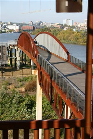

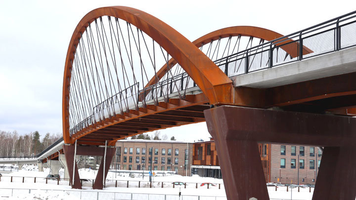

    Sorry @TacoFranz but it sounds like you jumped into a pot of boiling water that you were already aware was boiling. Toyotas are known for rust more so back in the day.
    But I wouldnt let your paranoid thinking get the best of you.
    Suggest you go in parking lot to inspect the sruface rust on other vehicles before purchasing if you are worried about this.
    But without sarcasm- and for what its worth. Steel can still perform as intended even with "rust" or corrosion.
    Please look up "weathered structural steel" structures all around the globe.
    Not apples to apples but the point being steel is incredibly resilient and can endure atmosphere without hindering its performance.... And under much more considerable loading than your two little C channels and their welds.

    There’s a big difference between thick structural steel and the garbage sheet metal that Toyota uses on their frames. Same with old vehicle frames. A frame from the 70’s sitting in a field will have surface rust but still be structurally fine. A Toyota’s will turn to dust.

    Would be great if out truck frames were made from weathering steel, but unfortunately thats not the case. Weathering steel is engineered specifically to only surface rust made for high structural needs.
