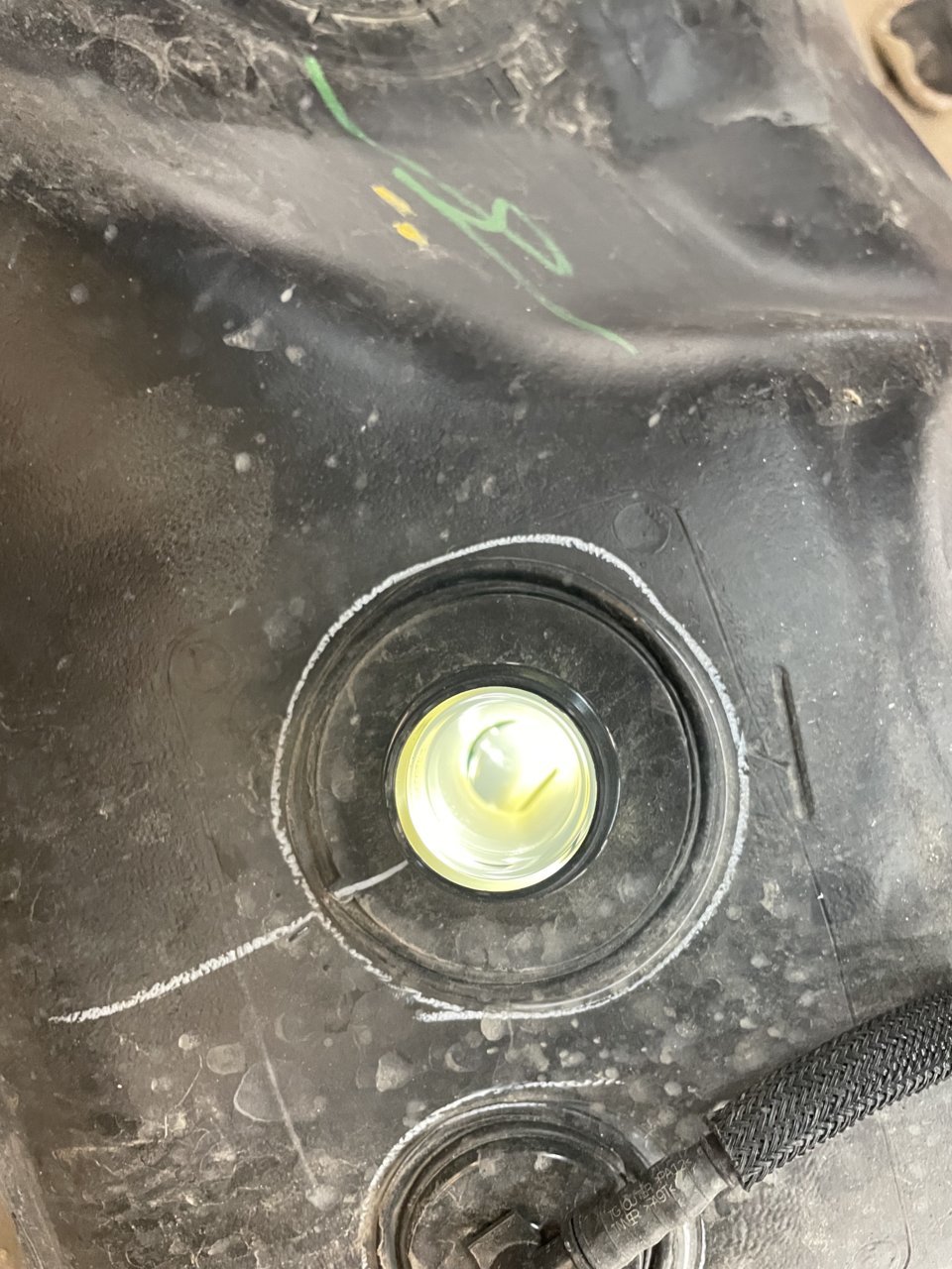

    Bishop, how hard is the damage to miss? This is exactly the information I was looking for. Does anyone have a picture of a damaged flapper?
  2. Aug 28, 2023 at 6:48 PM
    #22
    Bishop84
    Bishop84 Well-Known Member
    Dec 17, 2015
    #172494
    12,091
    Simply you wouldnt catch it unless you filled the truck up.
    I've seen it on rentals and trade ins where people want to recoup the fuel before giving up keys. But you need to puncture the flapper first.
    My dealer would treat this seriously with the video lol. We all have borescopes and experience to deal with this.

    Ding ding. This was a previously a rental vehicle.
  4. Aug 28, 2023 at 6:52 PM
    #24
    northwoodstaco
    northwoodstaco [OP] Member
    Aug 25, 2023
    #432072
    18
    I have not specifically told them to inspect the flapper valve with a borescope. I may try that now. Previously they just went and filled it up, said they didn't notice anything, end of conversation.
    That was last done in April, I may give it another shot now that I have more information.

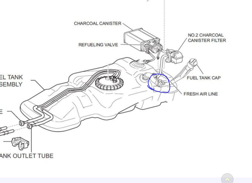

    So now that you mention this flapper valve, I'm not seeing it on the diagram I posted previously. Is there another diagram, or am I just missing something obvious?
  9. Aug 28, 2023 at 7:01 PM
    #29
    Bishop84
    Dec 17, 2015
    #172494
    12,091
    It's built into the tank the last time I saw this. They are not cheap and usually back ordered.
    So here's the trick, warranty has to prove it was vandalism and not a defect, so limit how much you disclose and have them diagnose it.
    It could be a stuck flapper, why is just heresay.
    RustyGreen and Canadian Caber like this.
  10. Aug 28, 2023 at 7:05 PM
    #30
    northwoodstaco
    Aug 25, 2023
    #432072
    18
    Understood. So my understanding is that I will be looking for an obviously punctured or stuck valve? I'll likely do my own inspection first before taking it in.

    The valve should be shut and will appear to be bent or stuck open. The camera shouldnt be able to get far in the neck.

    Yes unfortunately they'll only take it to their partner stations to test the refueling, which of course never produces the right result. Maybe due to the boot, or something else. I'll be the first to admit their pumps are unusual. But again, there's a problem with the fueling system regardless of it not spitting fuel back out at other station brands.
    Seems like this should be the location of that flapper:
    I'll see if I can get a borescope down to that tomorrow.

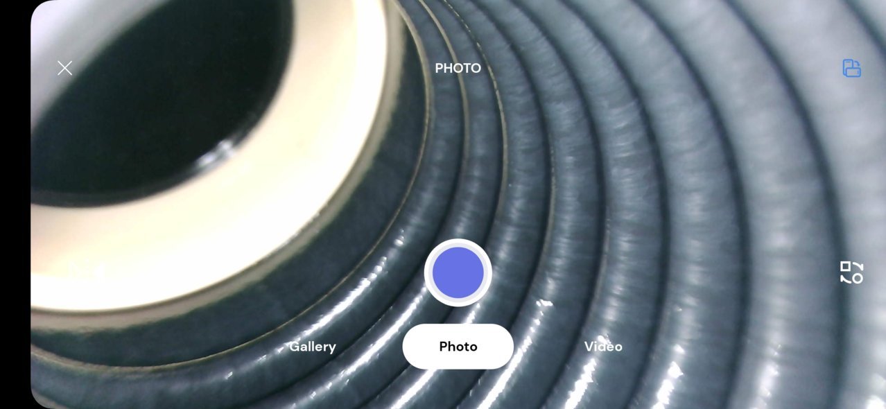

    I read that thread a while ago, but evidently I didn't read it that closely. Rereading it and yes they've said pretty much the same thing we concluded here. Inspecting with a borescope should do the trick, as we've discussed I should be stopped around 18" down the pipe. Assuming the flapper valve is the obvious cause I'll take some pictures and present them to the dealer, with a request that they inspect this issue and fix it. No speculation on what may have caused the issue. For all I know it's been there since the factory.

    Forgive the image quality and poor angle. This was the best I could do with the endoscope I have available at the office.
    My understanding is that instead of the black void, I should be seeing a white flapper valve, similar to bottom.
