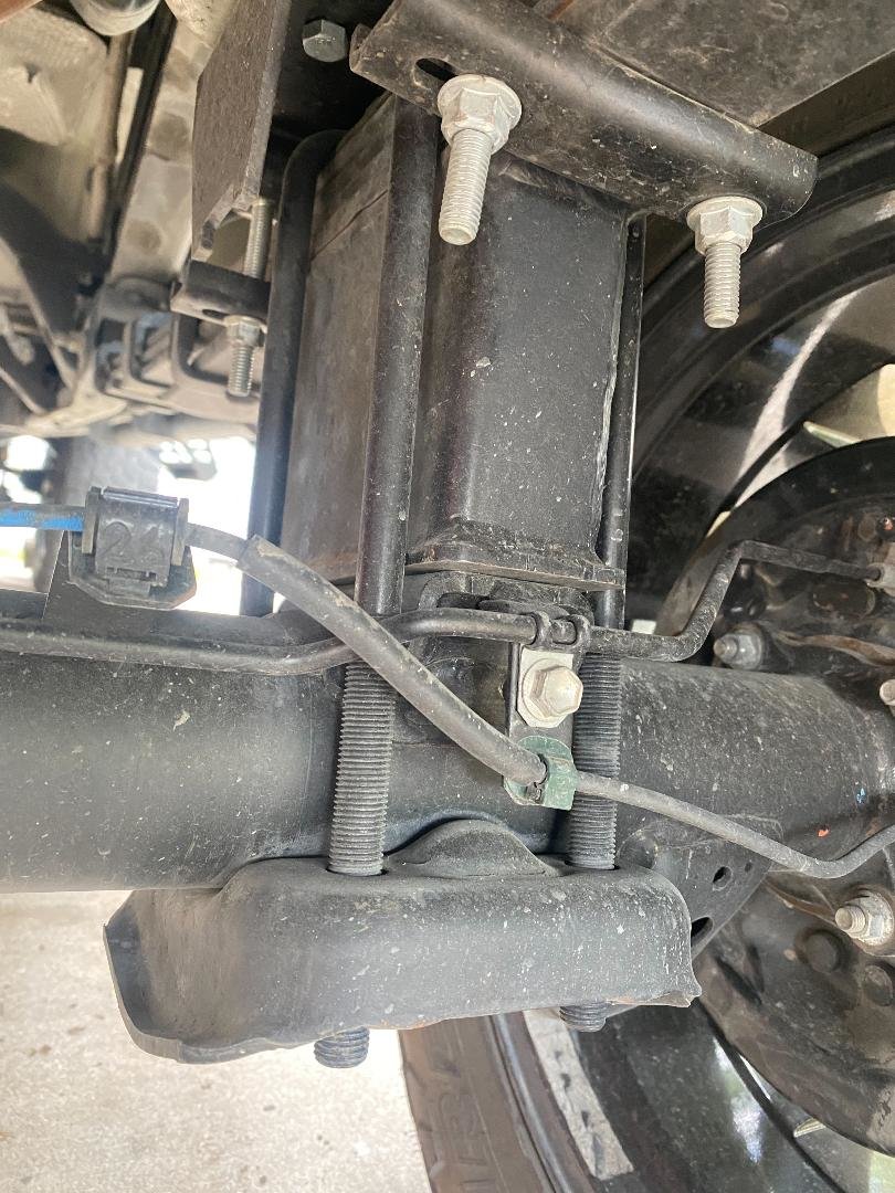

    I don’t see any. Not unless the blocks are degreed?
    But I don’t think that’s your problem. Degree shins are for vibrations not whining diffs.

    I was just adding to your post. In my experience if the noise is under load, a bearing is done.
