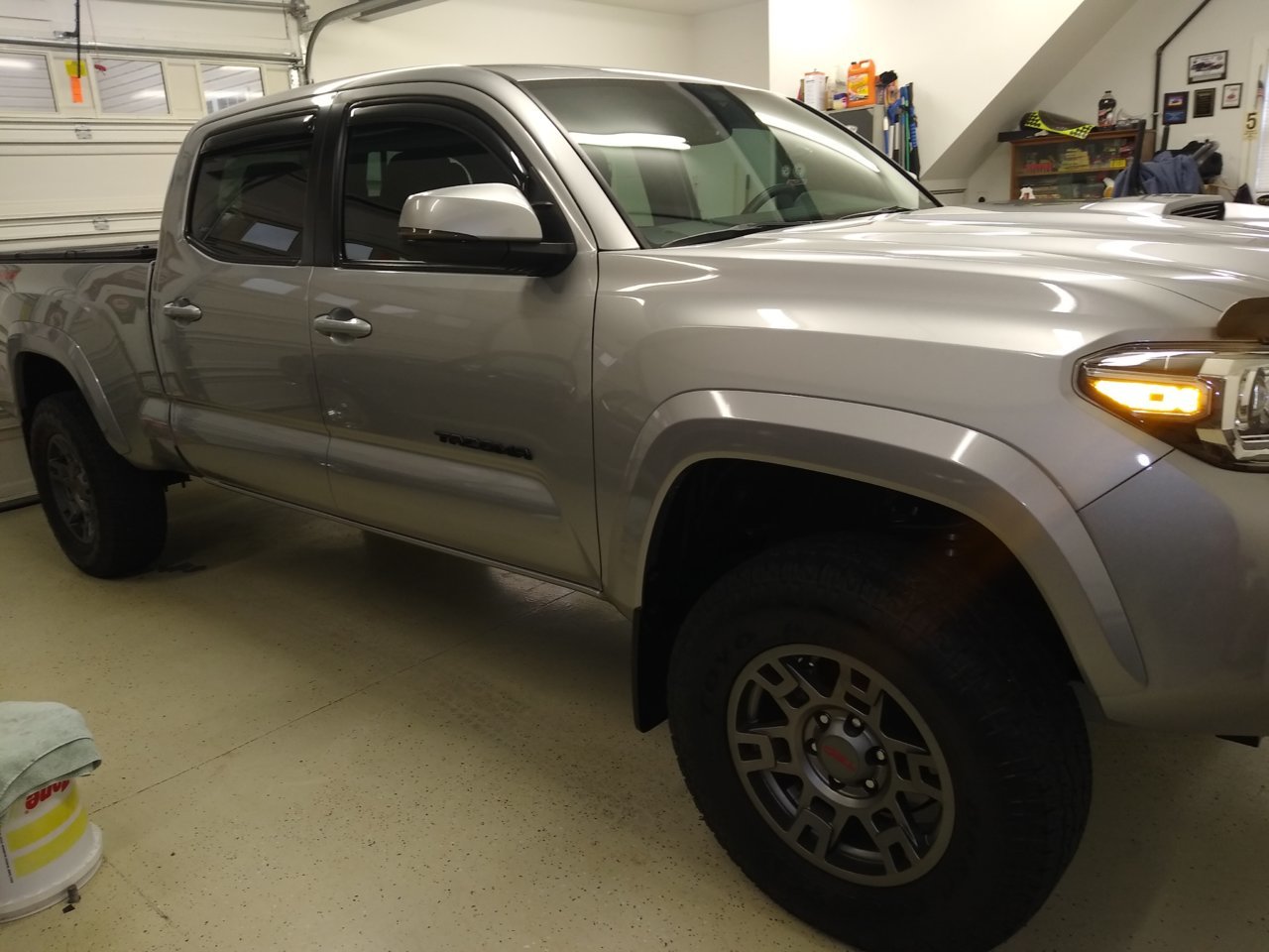

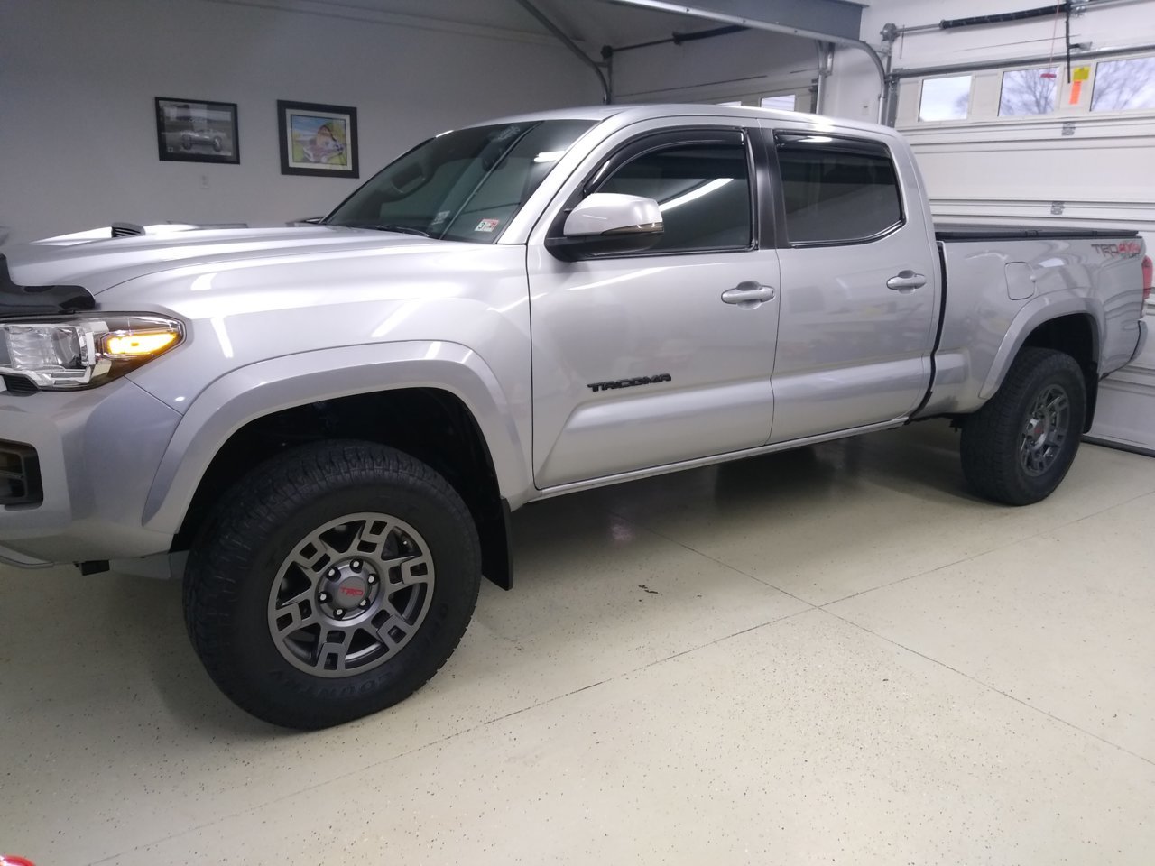

    IMG_20210210_144320390.jpg Yes, 5100s front on the 4th setting and rear, 1 1/2 inch tapered block, front diff and rear carrier bearing drop, 1/4 shim for the taco lean and ECGS clam shell bushing, OEM Pro grill and no issues for almost 3 years. One thing with this kid is no diff drops to keep things in factory specs, the needle bearing is going to be best to replace while the front end is apart, it's preventive maintenance. You need a shim that's not included in the kit. Its cheaper to do Bilstein and the dealership isn't.going to do a cleamshell bushing or the spacer and if they do it's going to be expensive. Plus loosing your fogs is a joke.IMG_20210207_141143096.jpg IMG_20210207_141125769.jpg IMG_20210207_141143096.jpg IMG_20210207_141120369.jpg IMG_20210207_141104998.jpg

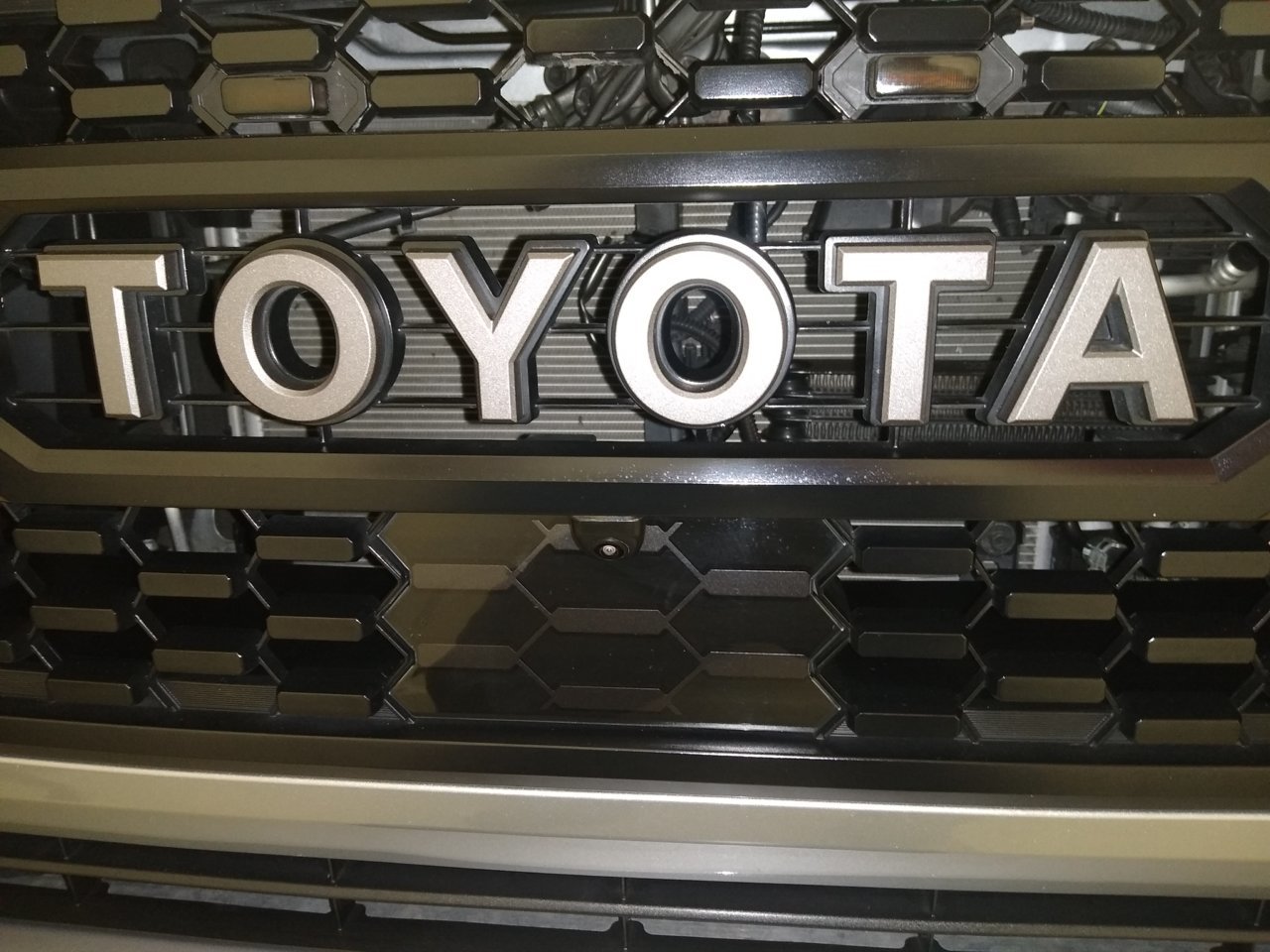

    lot people wants the pro grill, Toyota add the grill to sell higher price. Tactically pro grill will help the tss because the location of the sensor being drop like 2 inch anyway.
