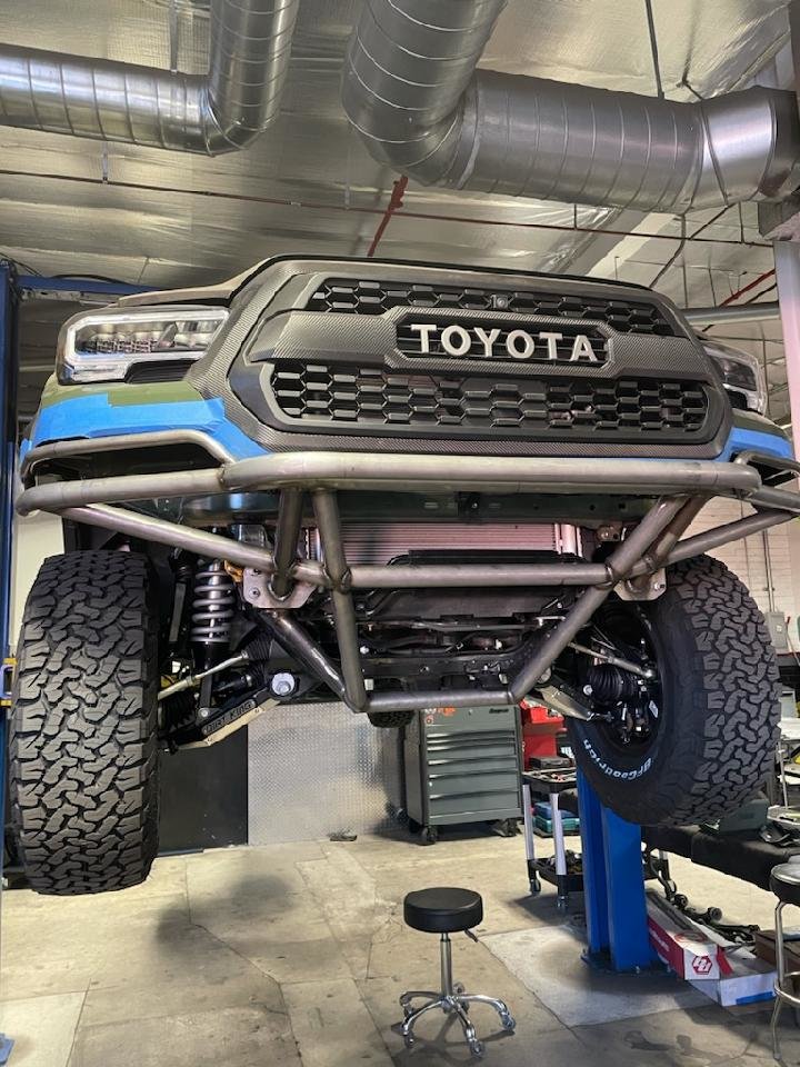

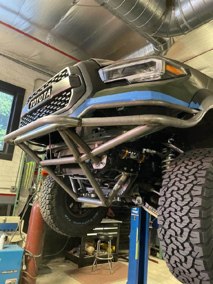

    I gave Steve the green light to digitize it and make it available as bolt on. This one was about $4K. Maybe he gets it down to $3K
    Plus another $2K to Baja Designs

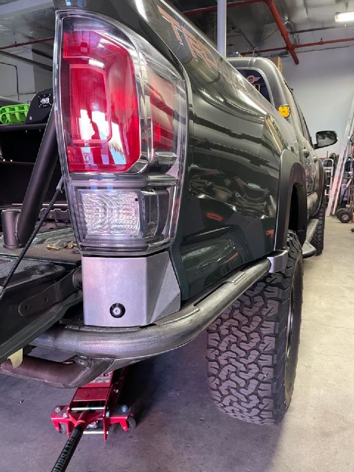

    So here is our approach. It doesn't need much of this except for the stiffener. The caging was a Baja thing..bedcut1.jpg

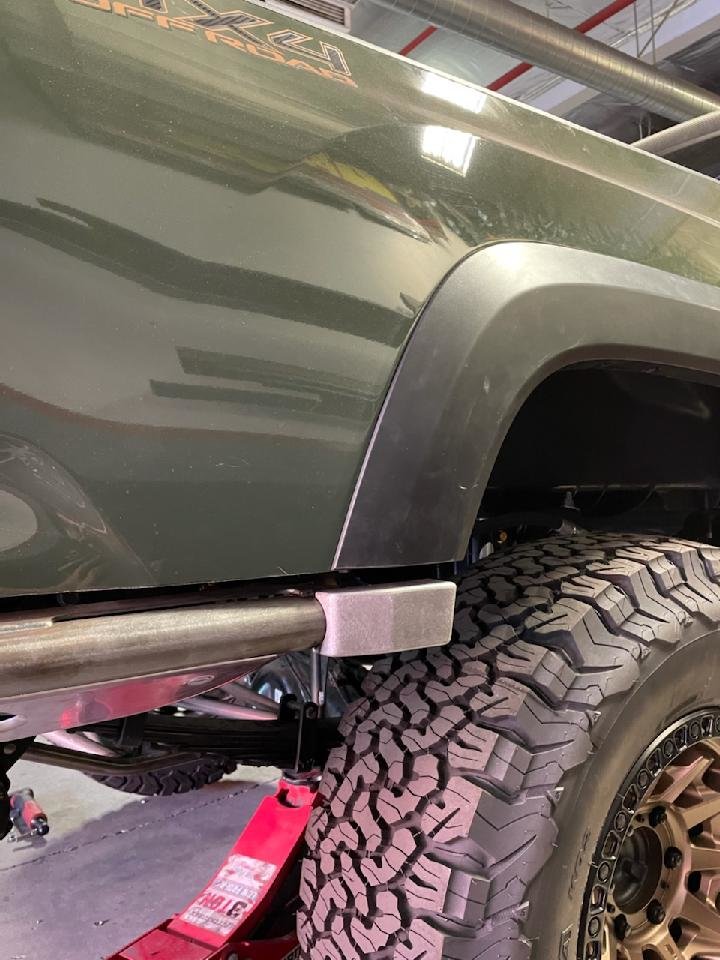

    Tacoma: mid-travel on 33s LC: 3.5” lift on 35s

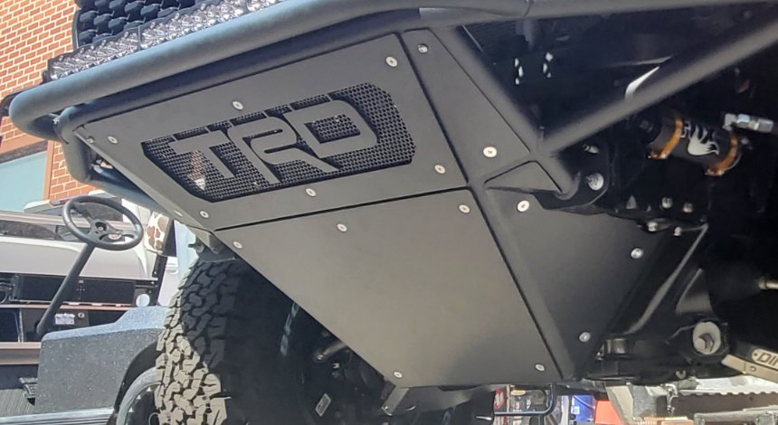

    How are the plates attached to the tubes? I dont see weld beads but do see dots at the corners. Curious how they did it.

    The box mounts to the bed. The cage mounts to the frame. They do not mount to each other. Is that what you mean?

    Is this what you mean?

    Looks like they are bolted on and not welded. What was the decision process on that? Also, is there potential for the top plate to be replaced for a winch bracket/fairlead?

    The motive behind mounting hardware is to work on various parts of the truck without removing the whole thing.. Here is the sub-straight. I would defer to Steve on load bearing and what add work ( if any ) would be required. Absolutely could happen. Check out the front winch design on Bandito. Pretty clever
