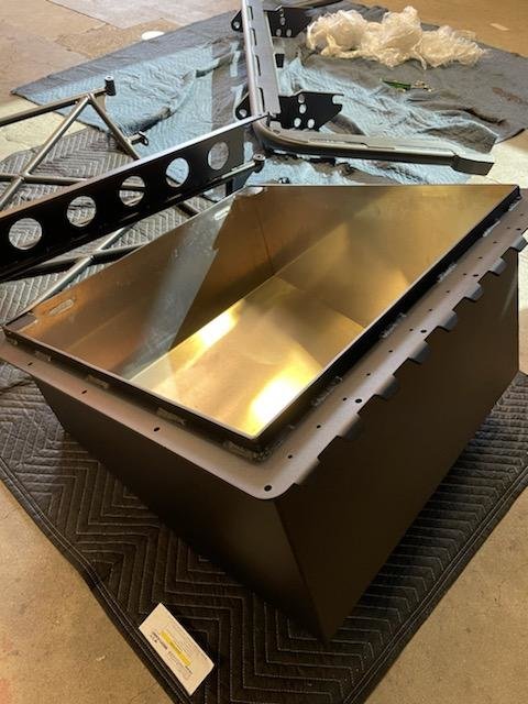

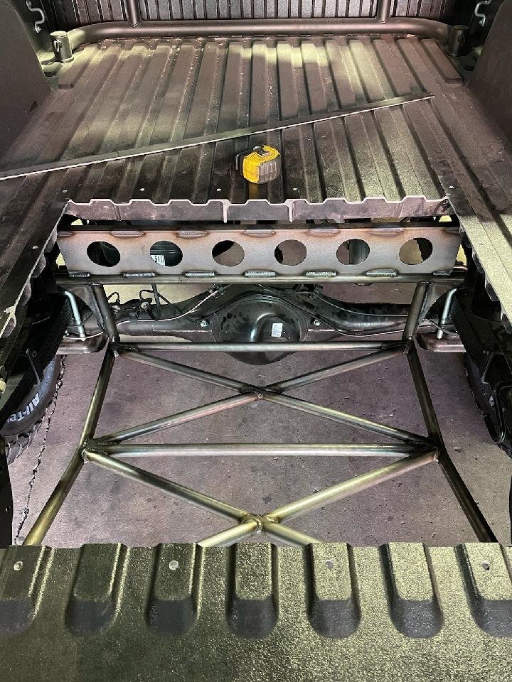

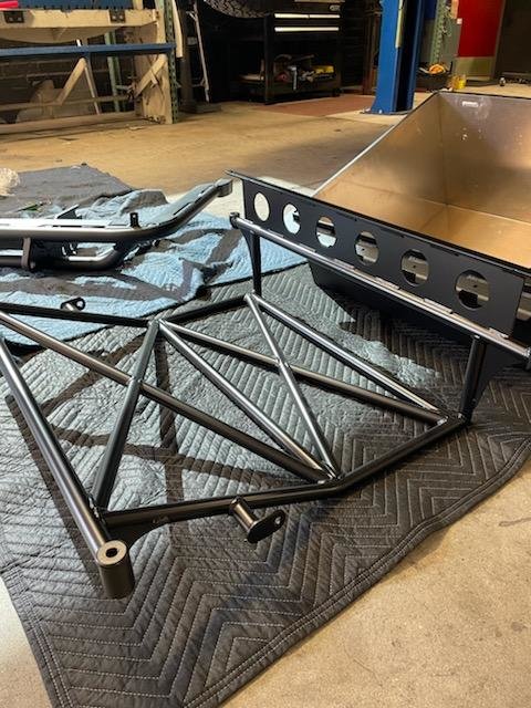

    So the cage for the rear box, that's just a bolt on?
  5. Aug 12, 2021 at 2:07 PM
    #125
    SanFelipeRat
    SanFelipeRat [OP] Well-Known Member
    Mar 31, 2021
    #361256
    136
    Tony
    2021 TRD Off Road / Crew / 4x4 / long bed / Army Green
    5:29 Gears, Cat Back 3" exhaust

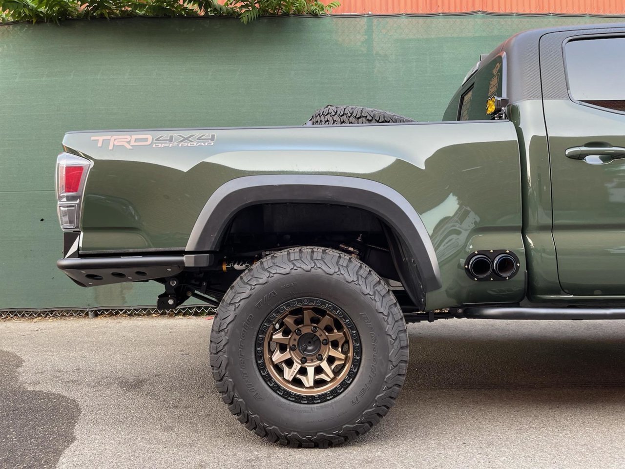

    Damn, I want to reroute my exhaust out that way, gives me more space to throw things under the bed.

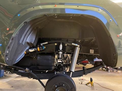

    Did you notice the sag here? Steve found an extra inch of cycle in the rear end, so we bought +1" shock mounts. bought some sag.
    phase2motortrend.com
    great guys, good stock of size/color. Quick WillCall in Ontario, Calif.
    We used the 2.25" for the stock FOX 3" DSC kit resi mounts.
    I had to hog out the relief where the hose clamp recesses into the resi mount because the aluminum clamp was a fraction wider. Just FYI, but easy..Eve4.jpg

    The exhaust pipes are sick, I would love to do that on mine but I'll have to see if there's room on a shortbed.
