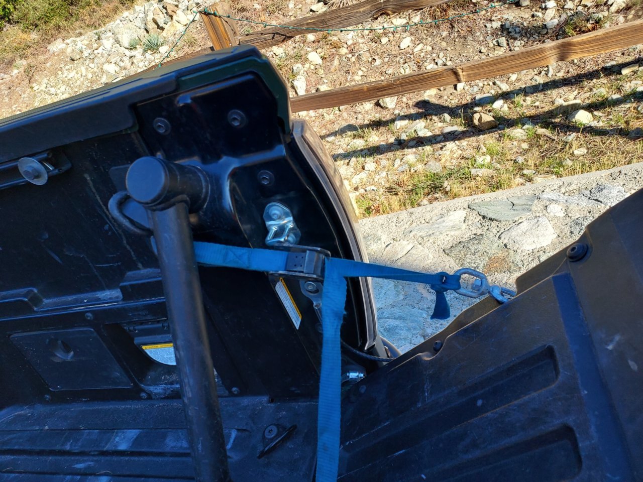

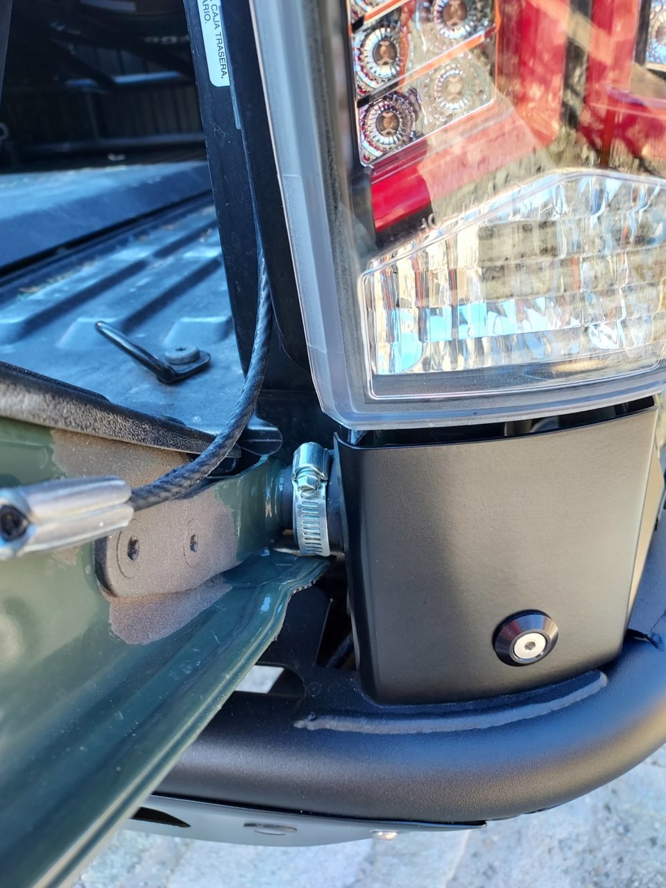

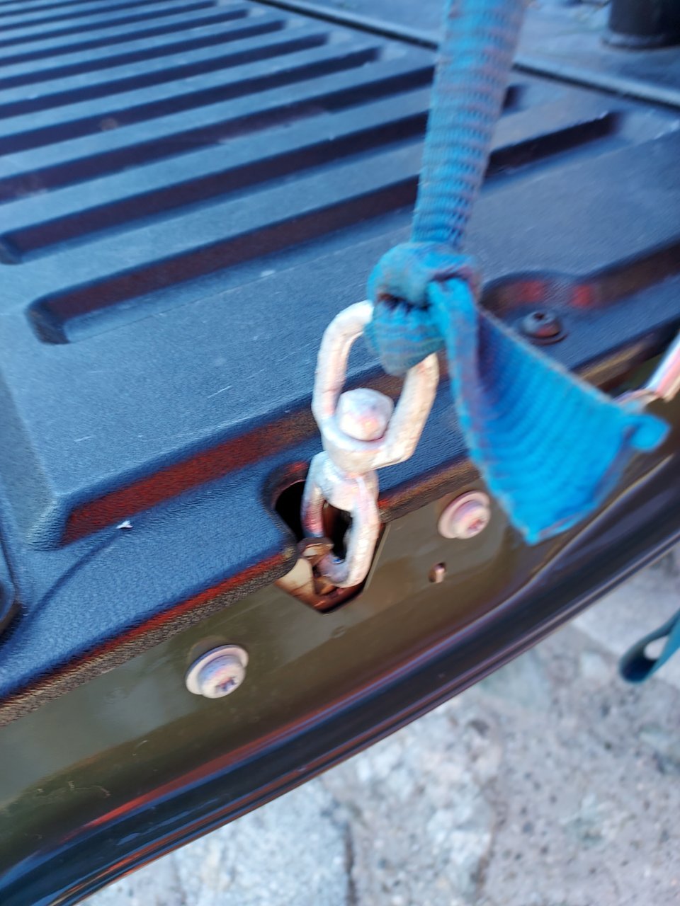

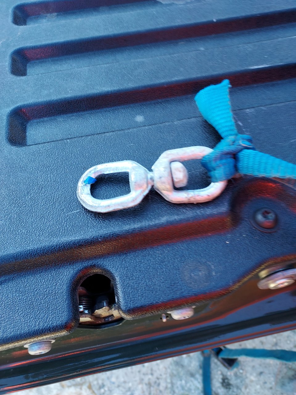

    Thanks for your patience. I went to ACE hardware and bought some swivel couplings you see here. They are right about 1/4" O.D. I test fit them in the parking lot. I smoothed the casting ridges to improve the action. Then sacrificed a set of Moto Tie Downs.tail2.jpg tail1.jpg
    So what you see is what you get. The tailgate latch handle works perfectly to release both sides without effort. The next is to have a mounting point. I have bedside stiffeners, so handled. You could attach to the tailgate latch D Rings with a custom set up. I would not recommend bedside rails for tis one..
    SAFETY WARNING
    THE TAILGATE IN THIS POSITION IS ALSO "UNKEYED" FOR REMOVAL AT THE MOUNTING POINTS. IF YOU ARE GOING TO PLAY THIS GAME, ADD A HOSECLAMP AS SUCH TO OVERCOME THE UNKEYED POSITION AND ASSURE THE GATE STAYS PUT.
    tail4.jpgI AM I'M NOT A PROFESSIONAL..GOOD LUCK.
    "EVERYBODY REMAIN CALM, I'M A PROFESSIONAL, QUICKLY SUBMERGE THE ARM IN MAYONAISE"
    MARK MERCURY ADKINS..
