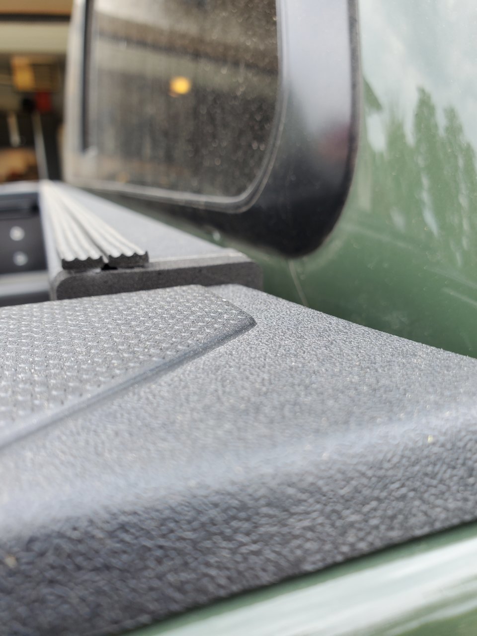

    I own a 2021 Tacoma Trail Edition and I used the bed boxes for tools and as a cooler for the first 5 months I owned the truck, but I just removed them last week because I cannot get a hard tunnel cover to fit with them installed. And yes, they bolt right over the existing bed, no modifications needed to remove. Other than requiring a very beefy impact wrench for removing the left and right tie down bolts at the tailgate, removing them was a snap.
    As mentioned, it is difficult finding a tonneau cover that fits, the only one that I found that does fit is the diamondback. I like the diamondback but I prefer a rolling hard or tri-fold hard cover. However after I removed the boxes I still seem to be having a problem getting most covers to fit because the bulkhead bed rail behind the cab window (not the tie down rail which my truck does not have) does not sit flush with the plastic side caps around the rest of the bed. Therefore the bulkhead rail sits up about a quarter inch higher than the side caps and creates a gap (see attached photo). If anyone can confirm if their 2020 or older sits flush, I'd like to track down a bulkhead rail from an older model to replace mine so I can get a cover to fit. This has been a major pita finding a rolling hard or trifold hardcover to fit my truck.

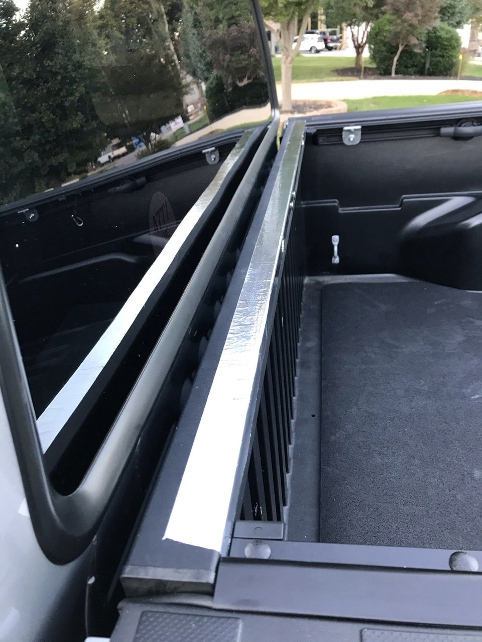

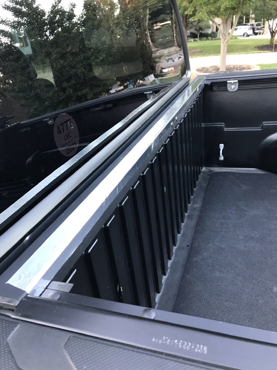

    I hadn’t even noticed that my bulkhead rail was a little higher than the side panels when I installed my Lomax trifold hard cover. As you can see in the pictures, the side rails that come with the Lomax are about even with the bulkhead, so it all worked out. The Lomax side rails bolt to the existing bed rails. The silver tape on my bed rails I put on to provide a smoother surface for the Lomax cover front panel seal.
