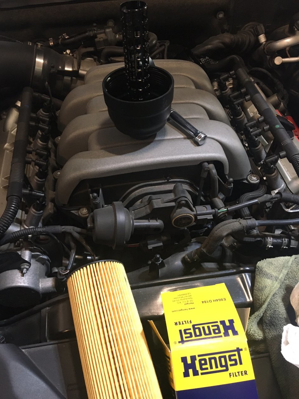

    Plastic. Just used a Motivx tool - made very well and works great w/no slippage.
    https://www.motivxtools.com/collect...s/products/toyota-2-5l-5-7l-oil-filter-wrench
    I have had my Audi for 12 years (90K miles) and it has a plastic housing/cartridge set up, it is inverted on top of the engine - no leaks, no problems. Oil drain is solved by non-drain mechanism in the filter or the mounting housings. No sure why Toyota thought this was an issue knowing that there is a simple solution.
