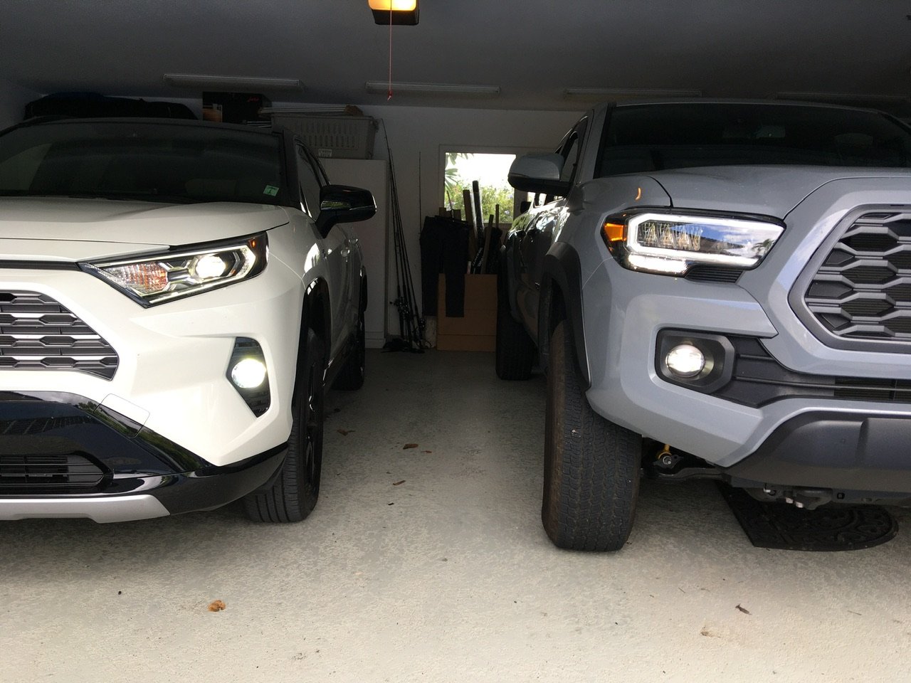

    But its his first 3rd gen tacoma. Our clear coat is softer than peanut butter. But my rav4 did this, my saturn sl2 did this, my geo prizm did this, many of my cars have had this. OP just got lucky or never noticed it on other cars.

    Nice to see you were finally able to upgrade to a taco ;)

    That rav4 was sweet, like a go kart with a radio. Wish I kept it to be honest.

    I got a new one on order for the wife... I put the deposit down in oct, toyota still has not started on it yet.
