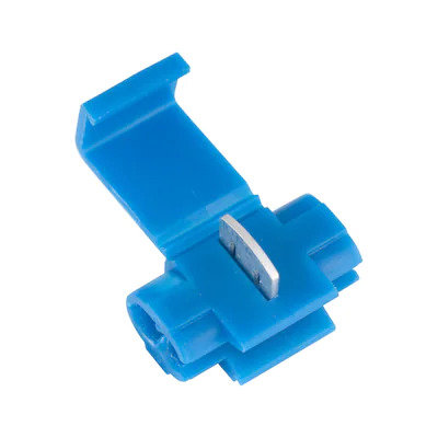

    What about T-Taps? You're not cutting just spicing.

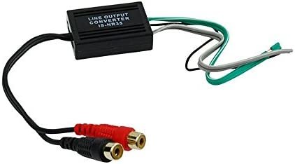

    You can the factory speaker wire off the radio into RCA jacks for the amp.

    I posted the converter picture for a 2 channel Amp. If needed they make a 4 channel converter.
    The picture was just a example of what available.

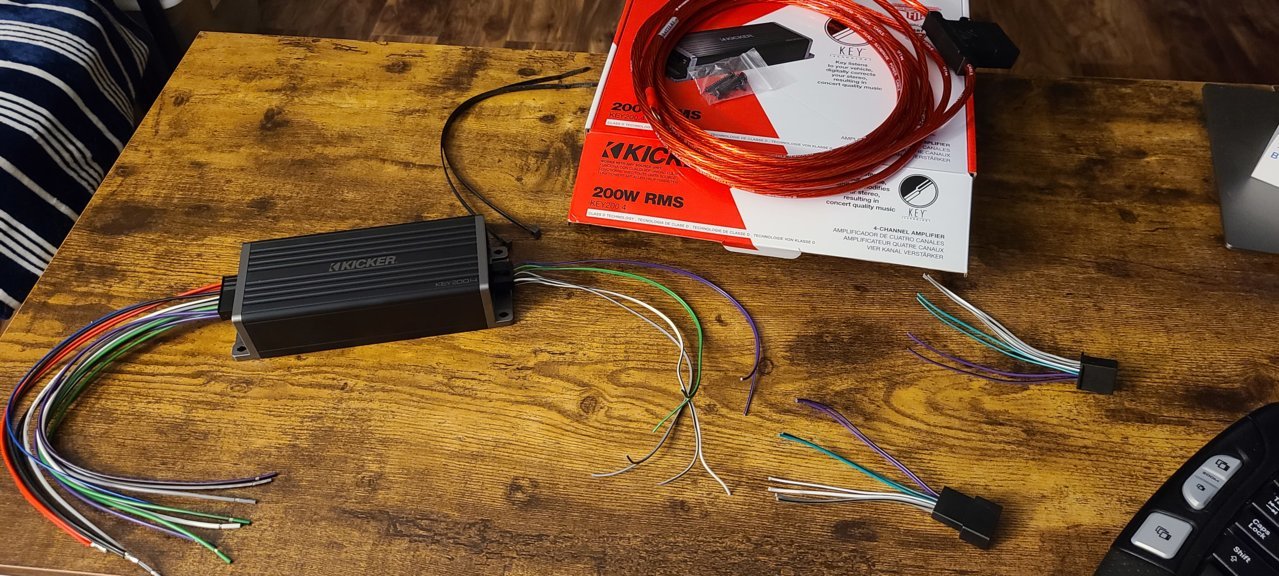

    @destin_meeks , sorry to bother you again. Just wanted to confirm a couple things. Amp and wiring showed up today. Here's what I have so far, assuming run power to battery, ground to ground, and then match the colors?

    Just to make sure you get your male and female sides correct and you’re all set

    I also need the Metra harness to plug into the Kicker Key Amp?
    Or does the amp connectors come with the amp?

    Nope, no Metra stuff for this install. You need the harness from post 9 and a 10awg amp power wire kit

    Final question. Got it all wired up as you directed. I am assuming I turn the "Auto-Turn On" to DC and press in the radio detect button for the amp to turn on with the truck?

    No
    Radio detect stays off. That gets into a more advanced feature that we don’t need

    Ok, so just switch to DC and I'm good
