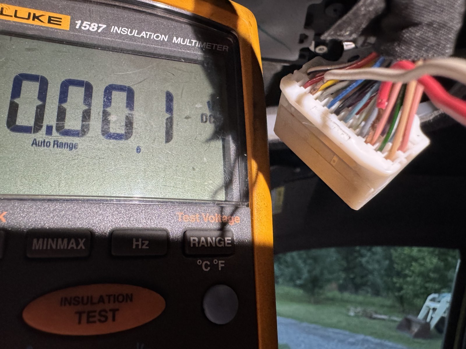

    Yes, no change under all conditions. I’m rechecking the pins you mentioned a while back now that I have the overhead console removed again.

    Just to confirm, Pin 15 and 22, 0 V.

    Do 15 to ground (12). 22 is PWM ground. (dimming)

    If you have some wire, make 2 jumpers. One for 15 to the removed lamp. (I'd use the rear lamp) and the other to 22. Open & close a door. See that it functions the way it should.
    P.S. Probe the wire side for this. Those pins are delicate.
