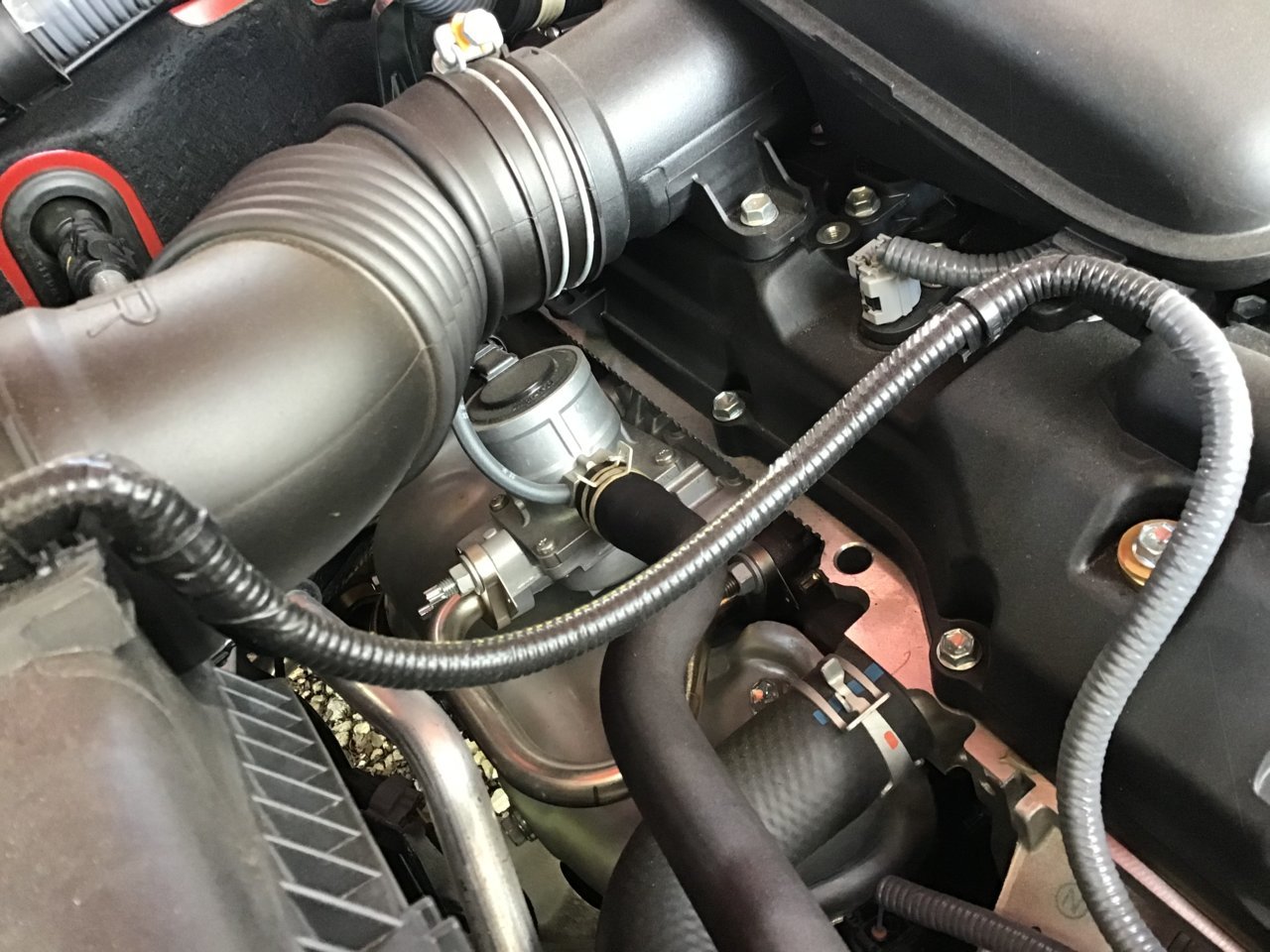

    Here is my 22 manifold area. If someone sees the differences please post up. Thanks.

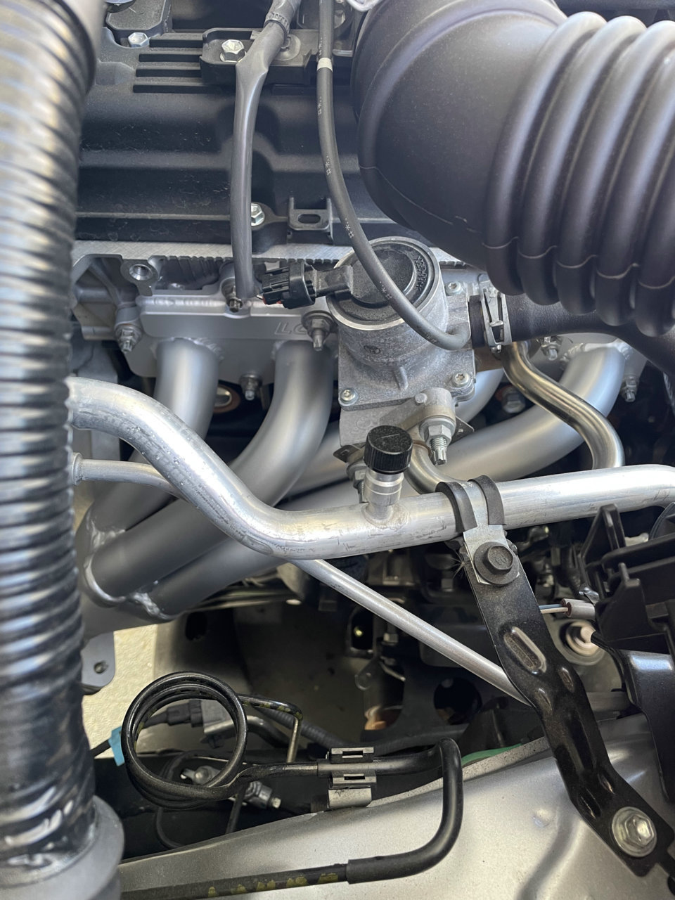

    This is my 21 with the lce i cant spot a difference

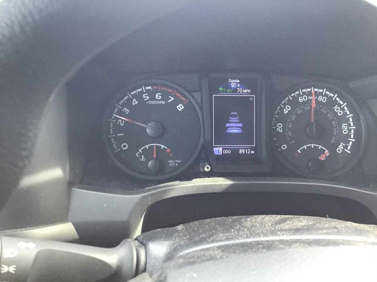

    I will double post this here too just because.
    75 MPH 2750 RPM but... It will unlock the converter for any reason and then its just a tick under 3K.
    And, it doesnt seem to suffer from a speed limiter, I shut her down at 90 just to check up to/beyond 83 MPH.

    On the header note, LCE has just expended the headers to fit the 2022.... so it was the same all along. In the coming months I will probably spring for one.
