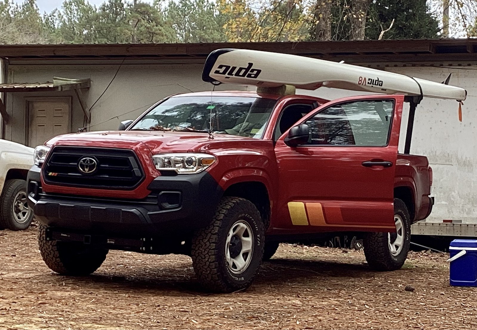

    Im on a road trip now, and with my yak on the roof @65 its returning 21 MPG. If speed increases I can see 17/18 at anything over 70. At 65 in the rolling hills of northern Ga Im locking it in 5th. Then most often it holds the gear, worst case it drops just one on CC. If Im footing the pedal I can force/trick it to hold 5th most often.
    Im happy with 5.29, I will try lighter tires eventually, or maybe go down a size. I had wanted 235/85-16 but at the time there was no availability date with the BS global shortages. These BFG ATs in 265 are like 53/54 lbs. The plus side is they wear like iron.

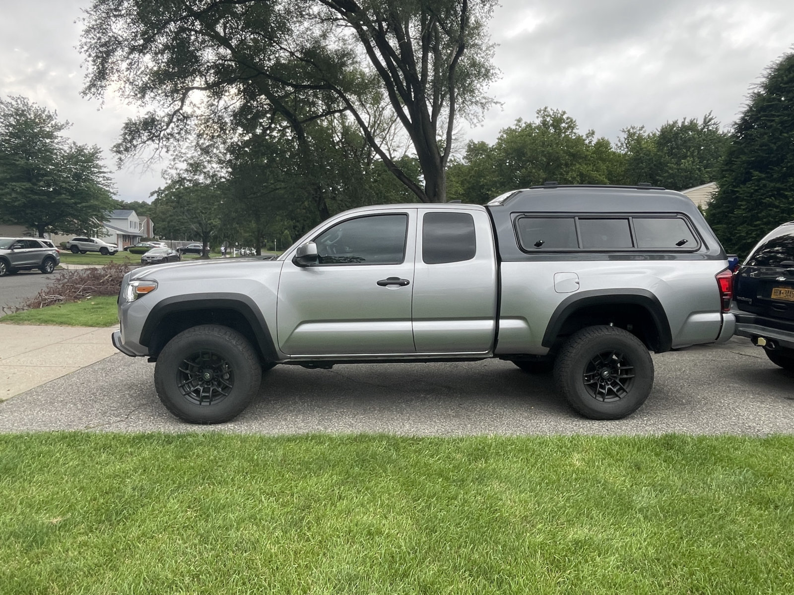

    I believe Navin has no tune, i have a tune, header, intake manifold spacer, and a light weight wheel tire combo which is key. I would suggest a tune 100% and try and keep the wheel/tire combo light. I as well am going to go with 235/85/16's over the 265/75/16's i have now when they wear out since it will help even more. His tires alone are 53/54 lbs my same size AT and wheel combo combined is only 58lbs. Navin has about 20lbs + per corner of rolling weight than me in the same size tire that will be felt. I am in NC its hilly here as well going 70-75 i would average 21-22 mpg on the highway and i am 4WD where Navin is 2WD. I also have a midrise shell and a small lift, between the weight of the shell, stuff in the bed, front skid plate, hitch, tires, etc i would suspect i am 6-800lbs over stock. All the mods helped for sure but i would say tune and regear were the most impactful. Get a tune, regear and keep the rolling resistance down and it will turn into a new truck. Its amazing for a little 4 banger how peppy it truly is with my combo couldn't be happier.

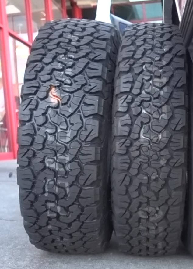

    This is not my picture but a 265/75/16 vs 235/85/16, you can clearly see how the 235 can be a benefit

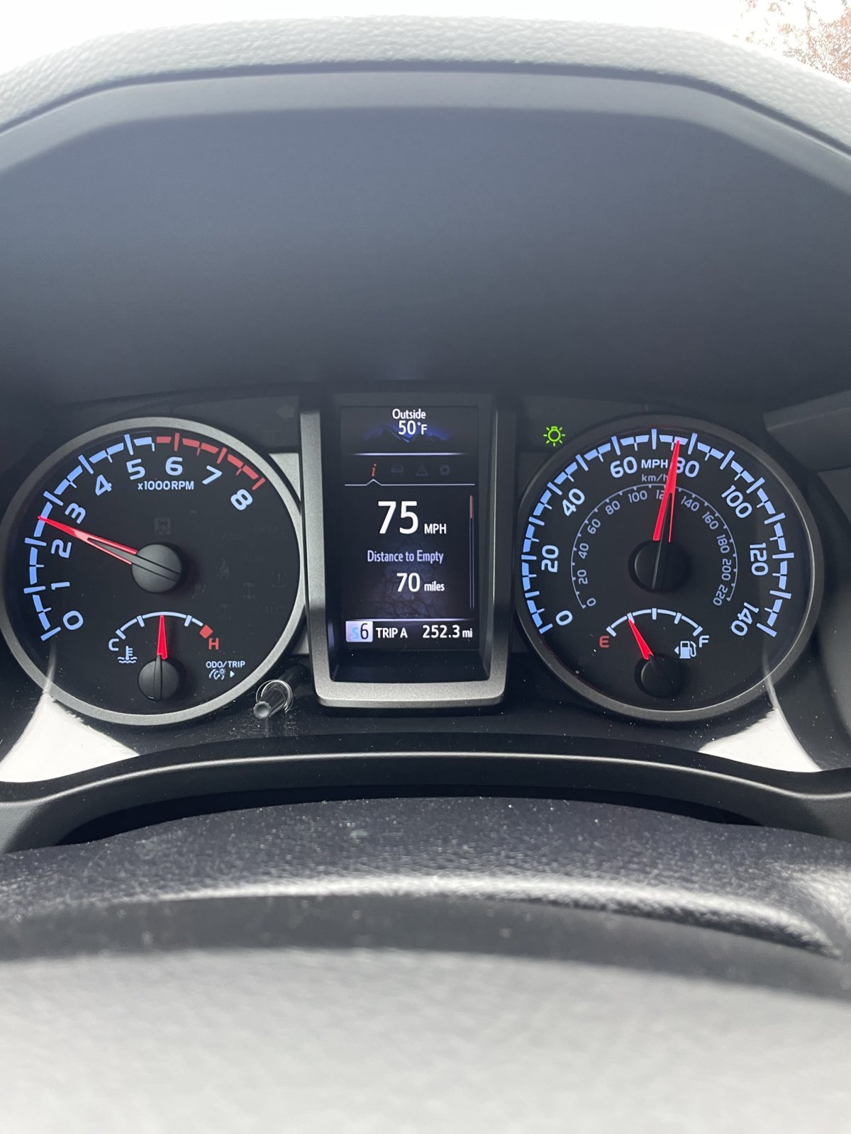

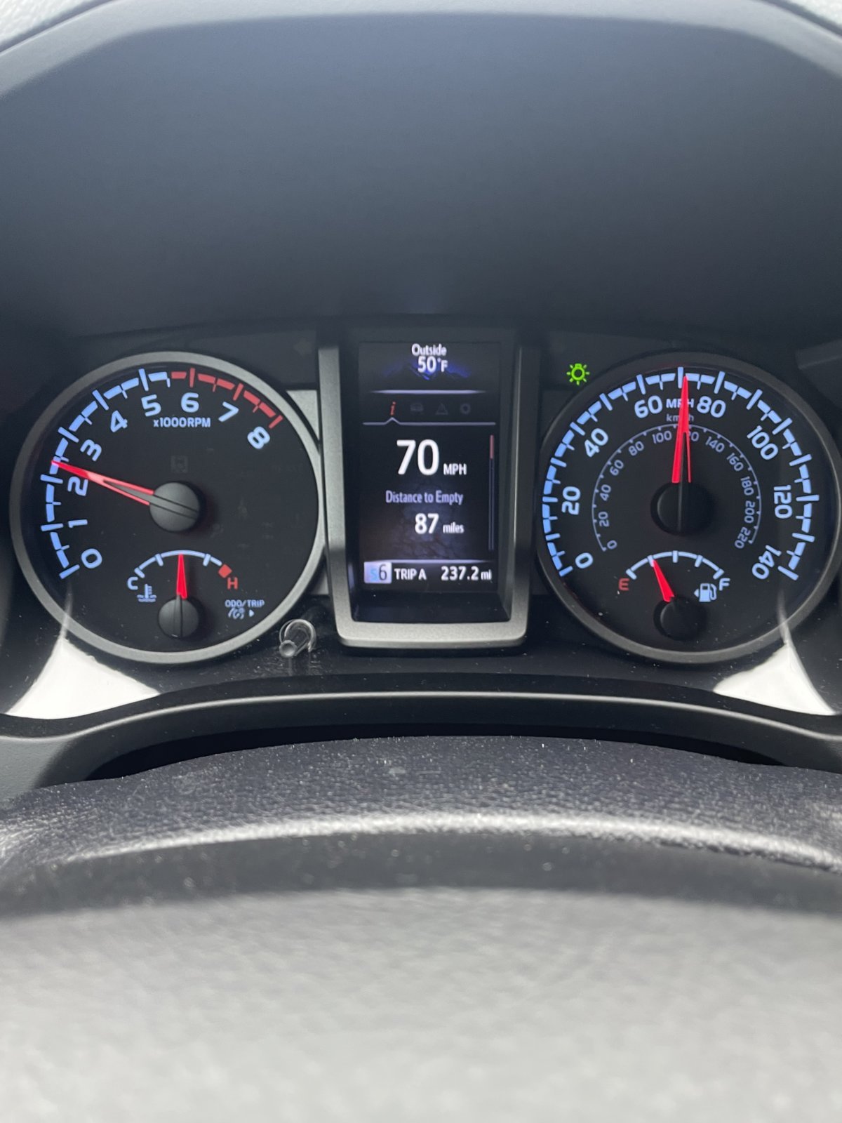

    Some highway speeds in 6th

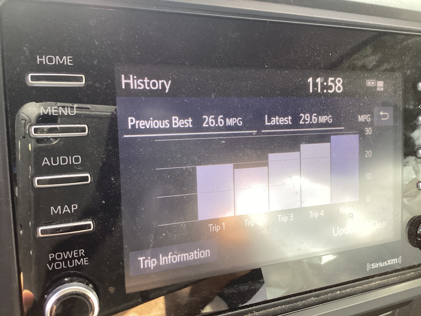

    Correct, no tune yet. But on a stretch of highway in Ga I got stuck in 4th using CC at 45 MPH. Thats with the kayak on top, moto in the bed. If we werent pushing so much air from this oversized body I think these would be the numbers @60. At 55 it drops to about 24 locked in fifth. 65/5th gear its 20-22. Lol.
