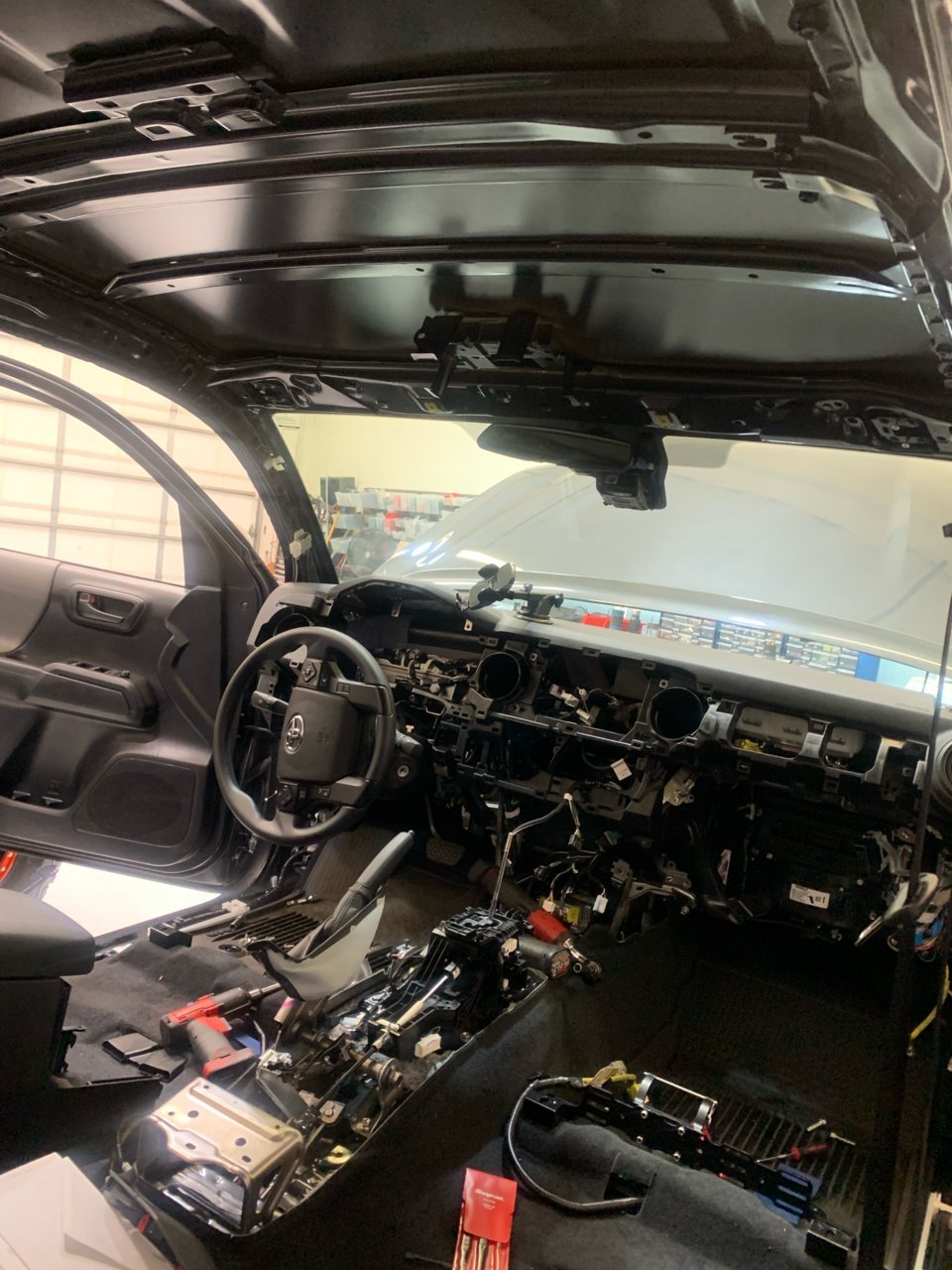

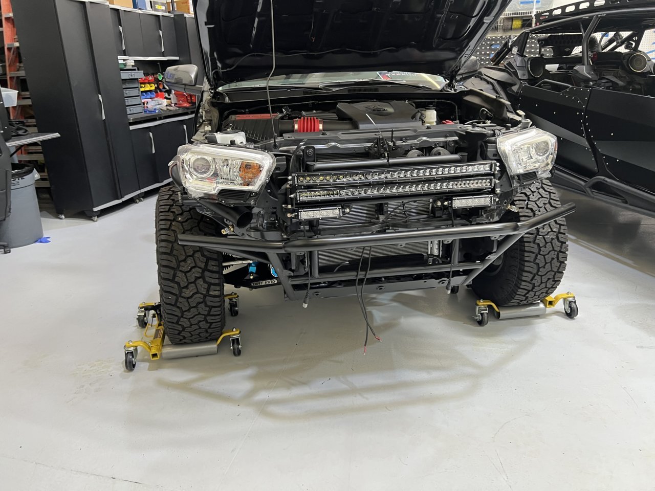

    Very close it’s at upholstery now then a few final electrical things, add 5:29 gears, then place all fenders, seats, etc… we are 2-3 weeks away

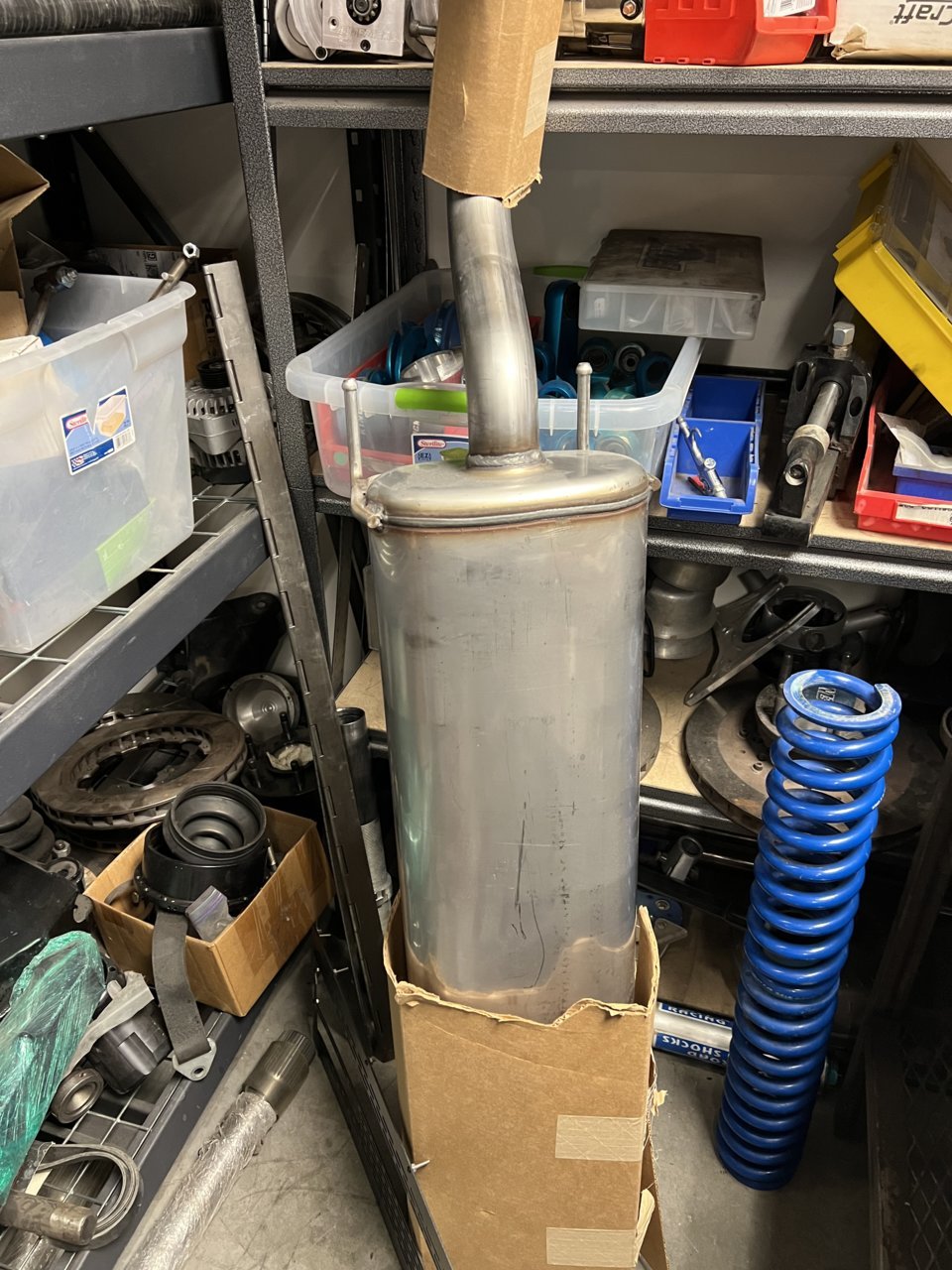

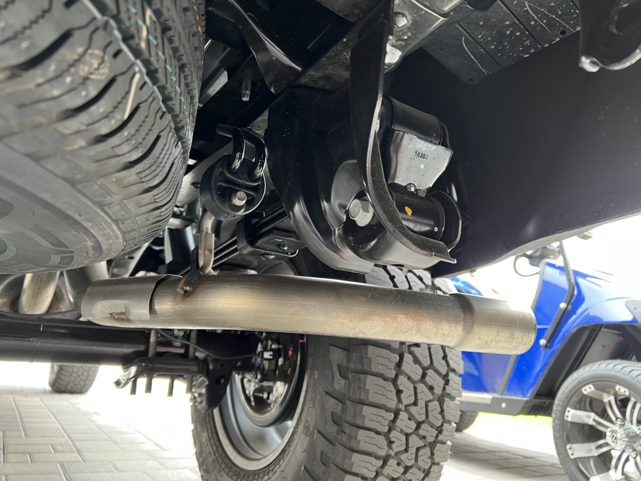

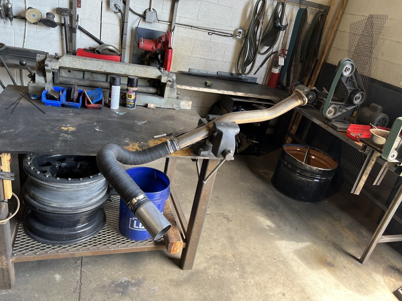

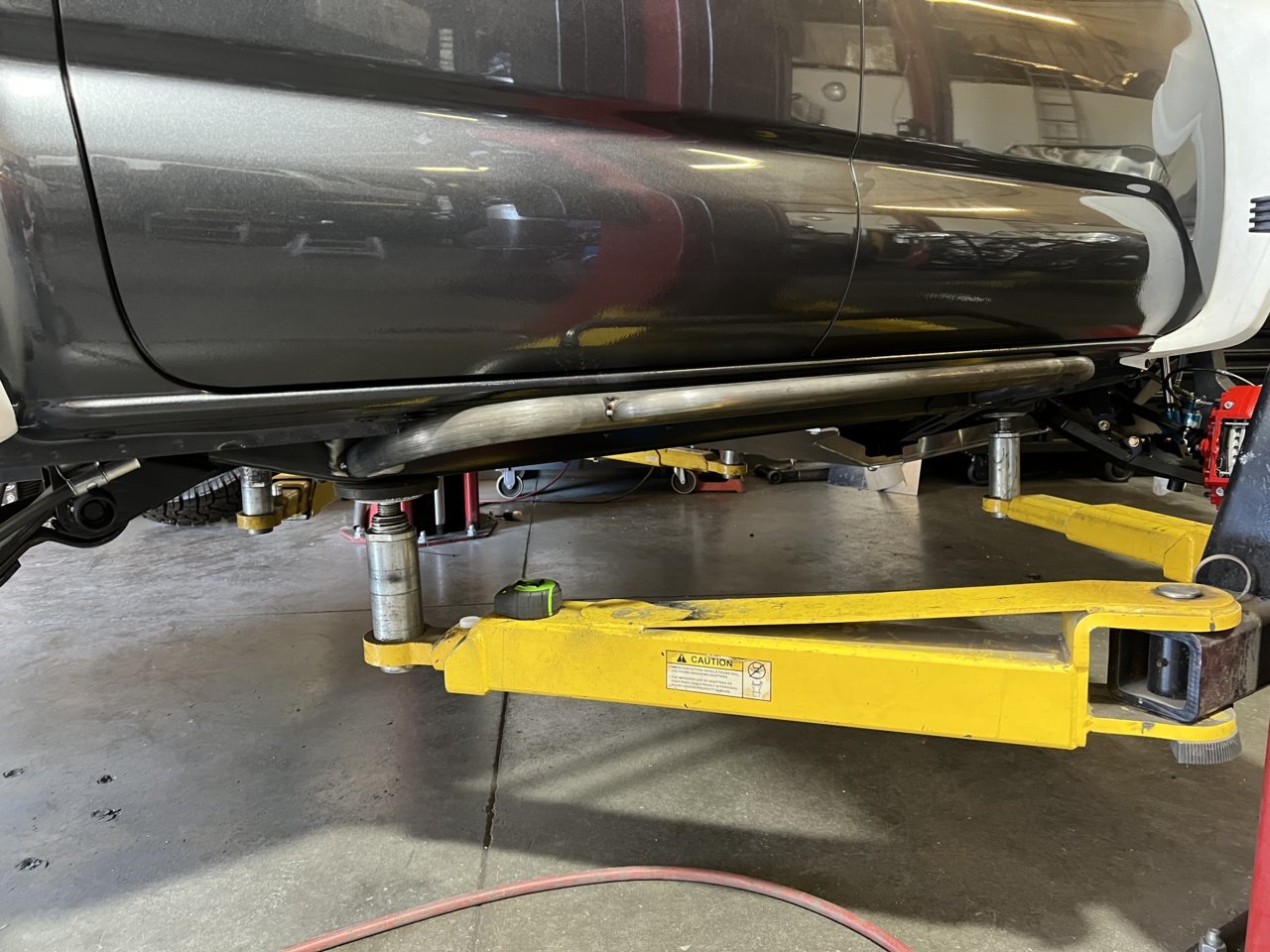

    We rerouted the exhaust to exit just aft of the cab on the right side. We had a new TRD Exhaust with black tip, but it would not fit with suspension and air compressor tank, etc.
    we cut the muffler out and welded the tip back on, then added ceramic coating, and wrapped with Heatshield Lava wrap.

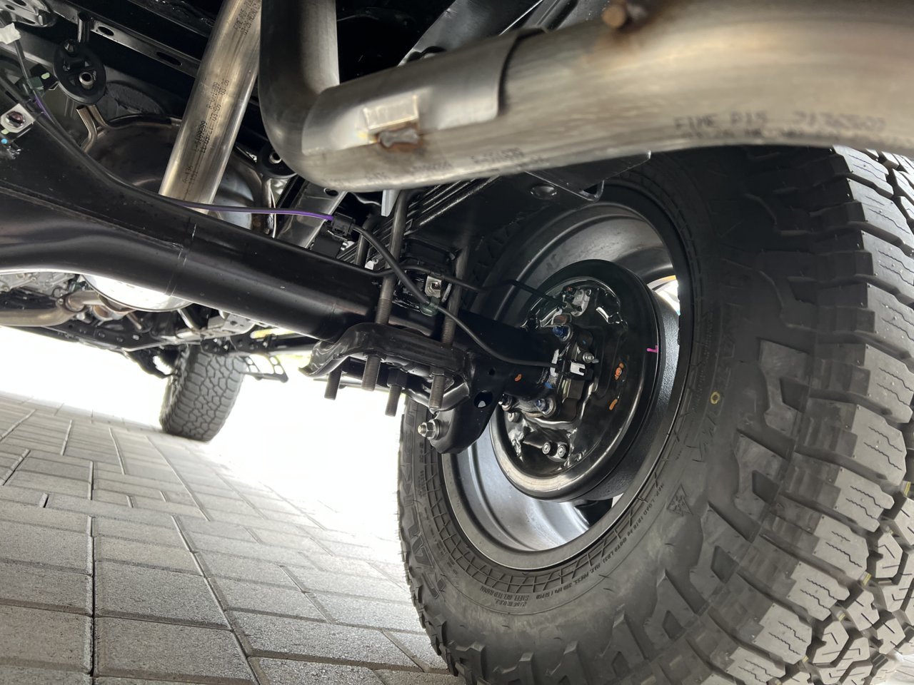

  3. Oct 31, 2022 at 1:51 PM
    #23
    BajaHoncho
    BajaHoncho [OP] Well-Known Member
    Aug 7, 2022
    #403056
    109
    Honcho
    2022 Tacoma Prerunner
    Dirtking long travel 17”, King Shocks, AZ Wire Pro, SATCOM, race seats, cage, Rigid Lights, MCM Motorsports, Switch Pro, Lowrance GPS, Kenwood 100W radio, complete electrical upgrade with alternator, second battery, race Jack, onboard compressor.

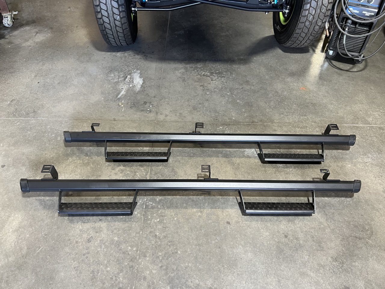

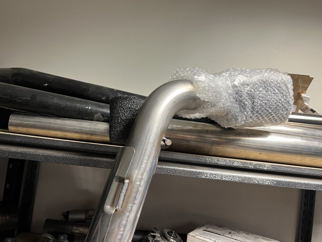

    Here is the new TRD exhaust we never installed…
    It sounds really good without a muffler.
    MGMDesertTaco likes this.

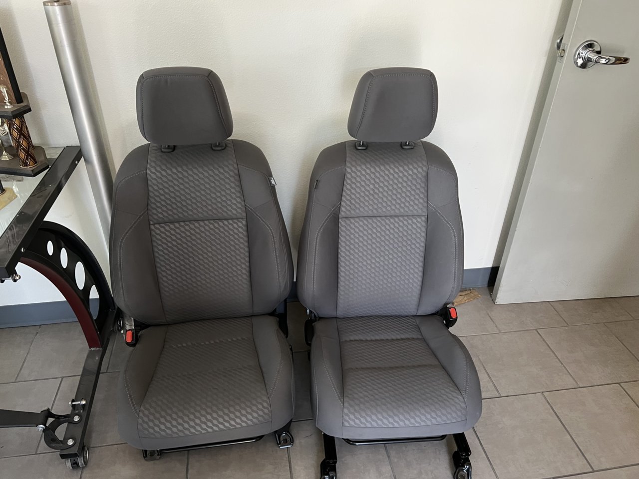

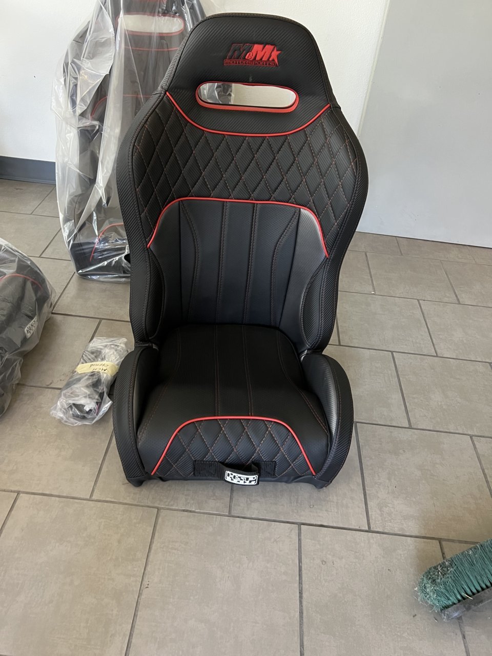

    Seats look much better now…

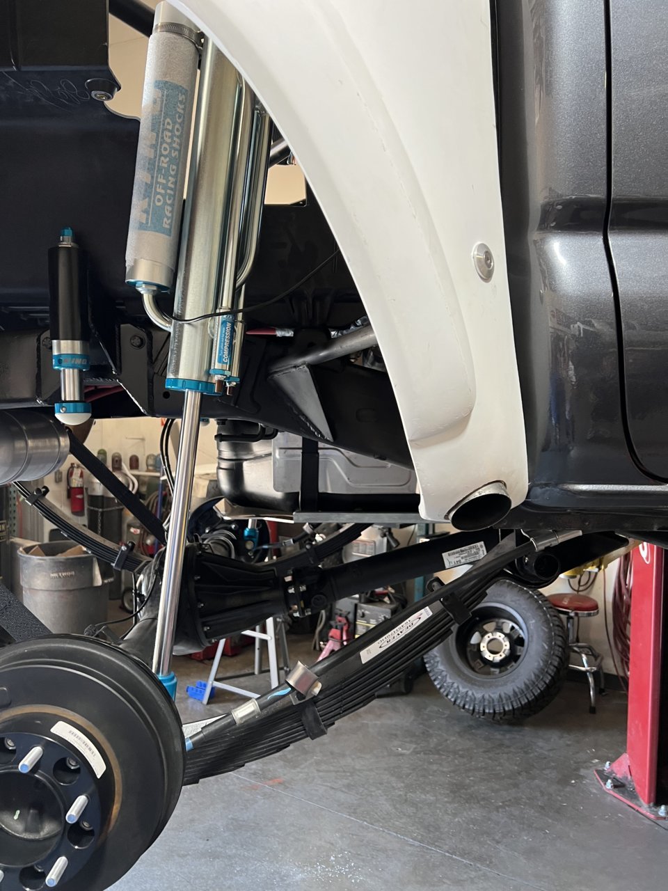

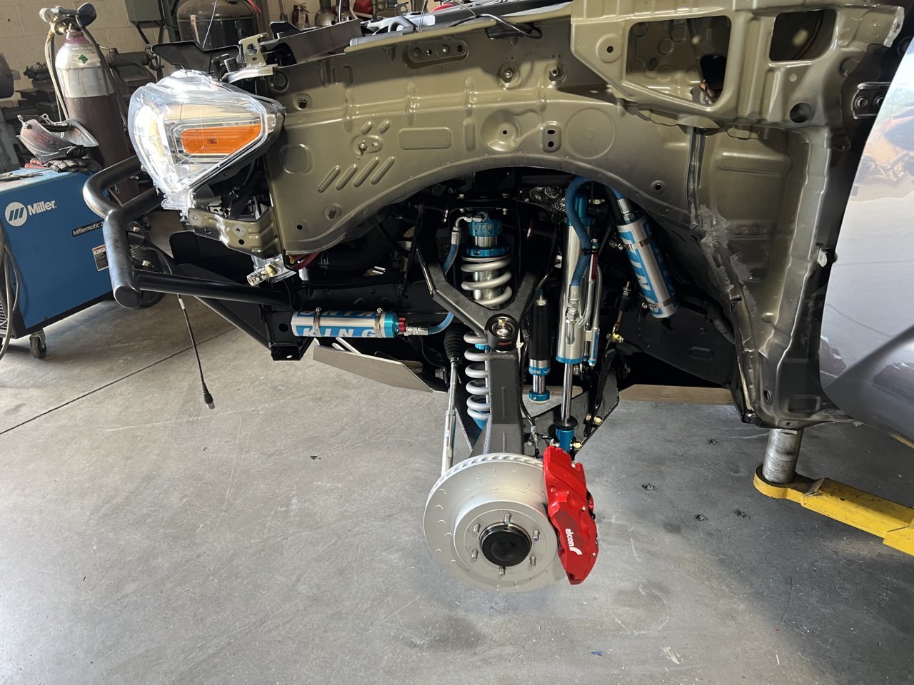

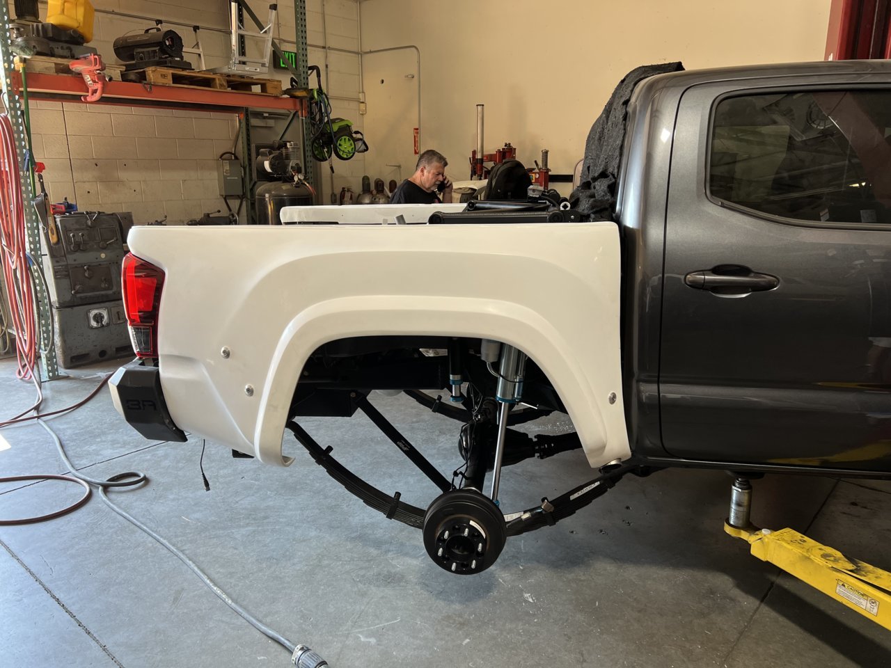

    Front suspension: DirtKing long travel, Camburg Racing Spindle, Alcorn Brakes, King Coilover and triple bypass shocks, limit straps, and bump stops. 35” Yokohama A/T Tires and Method Wheels

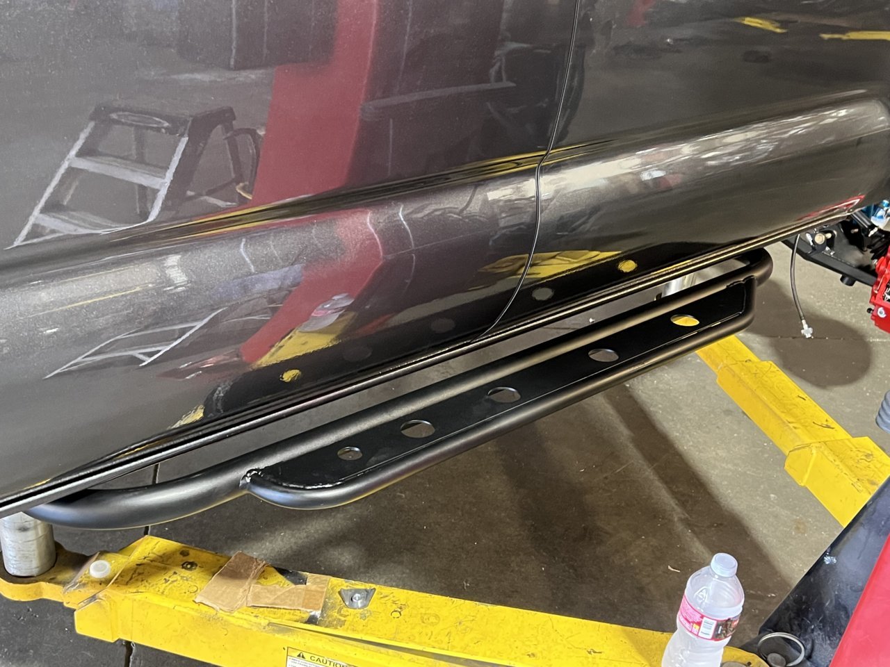

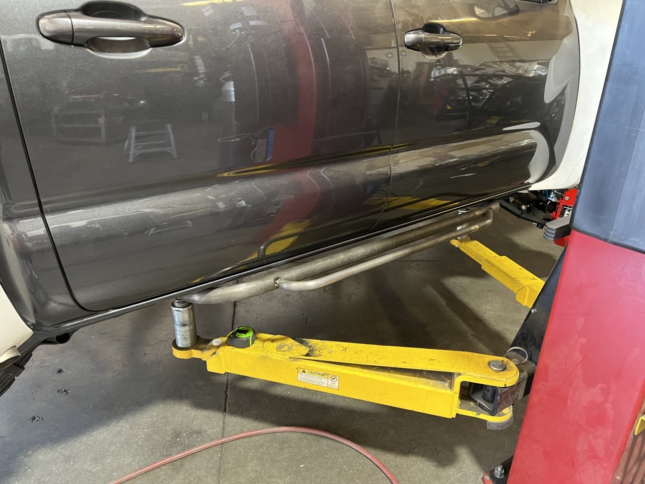

  7. Oct 31, 2022 at 2:18 PM
    #27
    BajaHoncho
    Aug 7, 2022
    #403056
    109
    Honcho

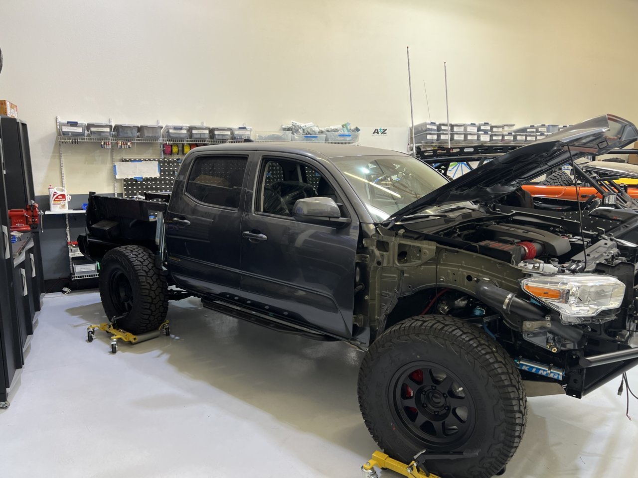

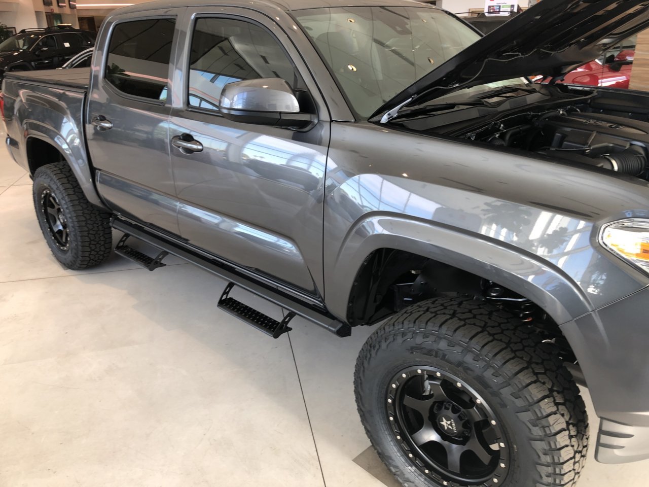

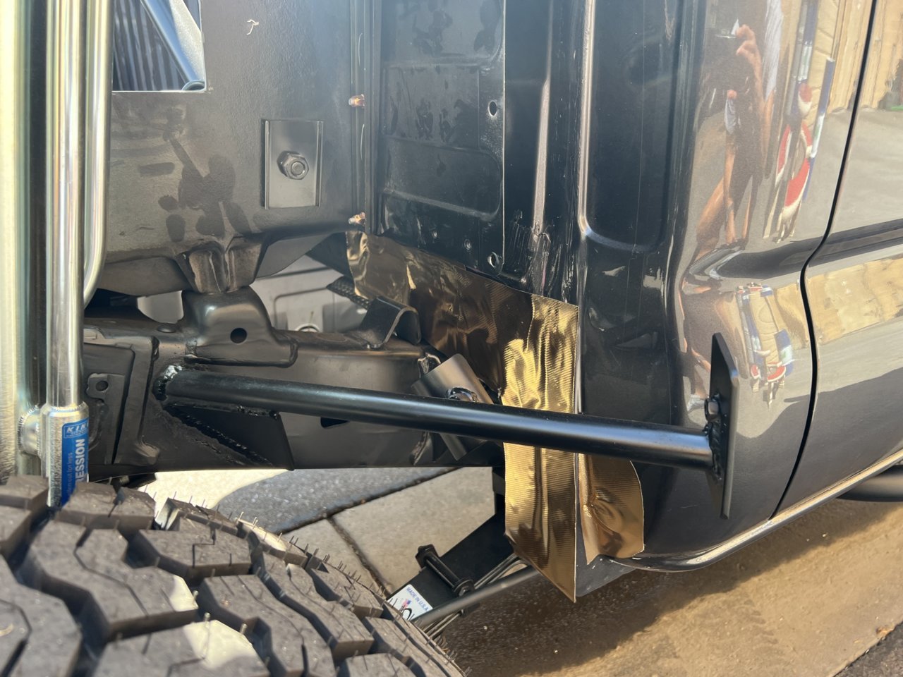

    We got rid of these silly steps… which if you hit a rock would fold like a cheap suit!

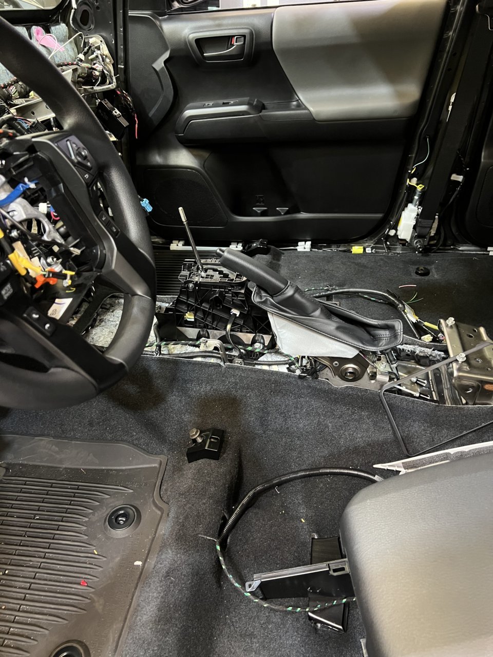

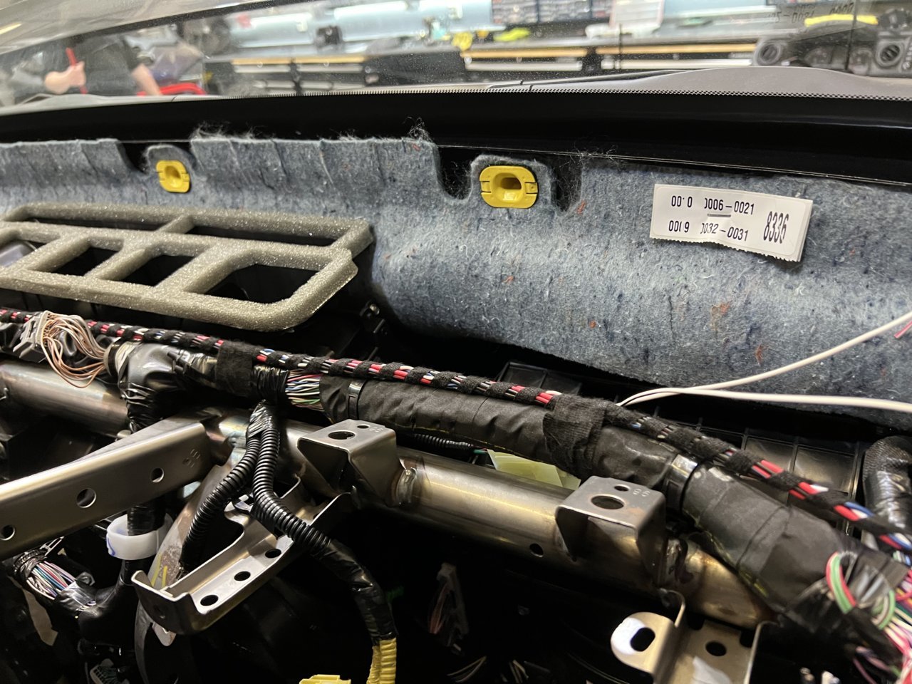

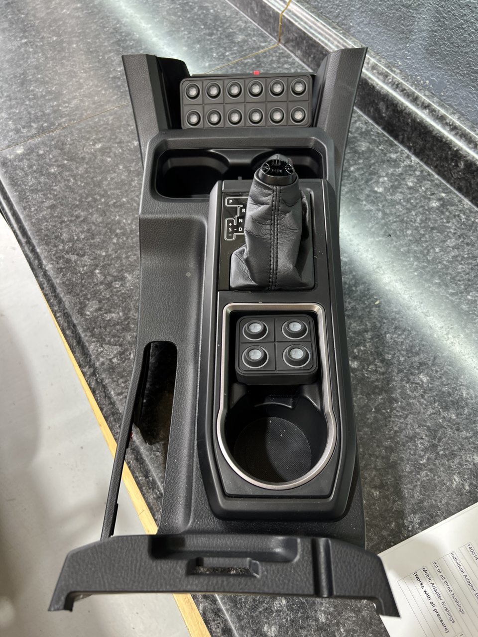

  9. Oct 31, 2022 at 2:22 PM
    #29
    BajaHoncho
    Aug 7, 2022
    #403056
    109
    Honcho

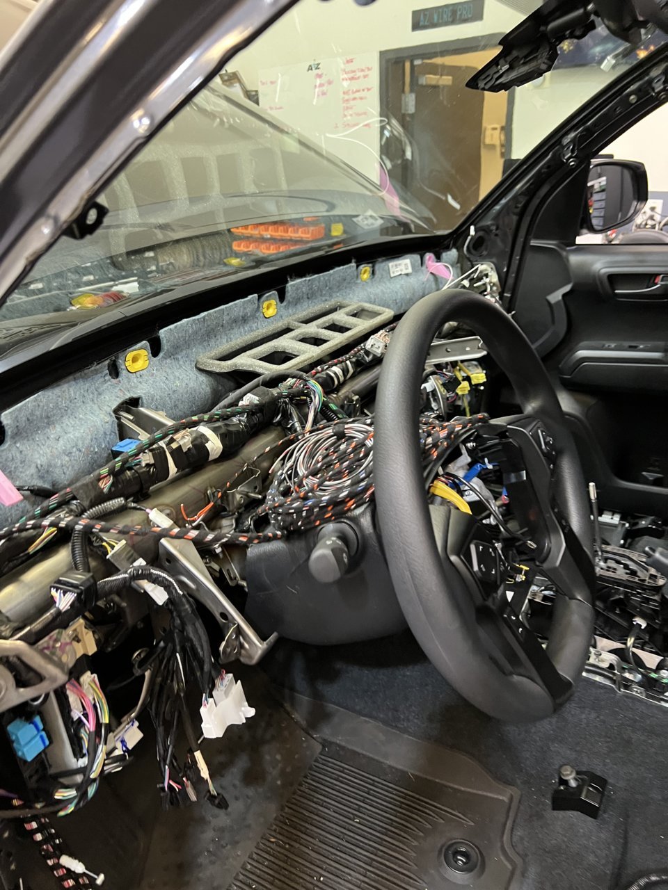

    We are adding SwitchPro modules to control all electrical equipment. We have two batteries, and spare starter and alternator onboard. 100W Kenwood radio, SAT Phone, LowRance 7” GPS.
    upload_2022-10-31_14-22-36.jpgupload_2022-10-31_14-22-36.jpgupload_2022-10-31_14-22-37.jpgupload_2022-10-31_14-22-37.jpgupload_2022-10-31_14-22-37.jpg
