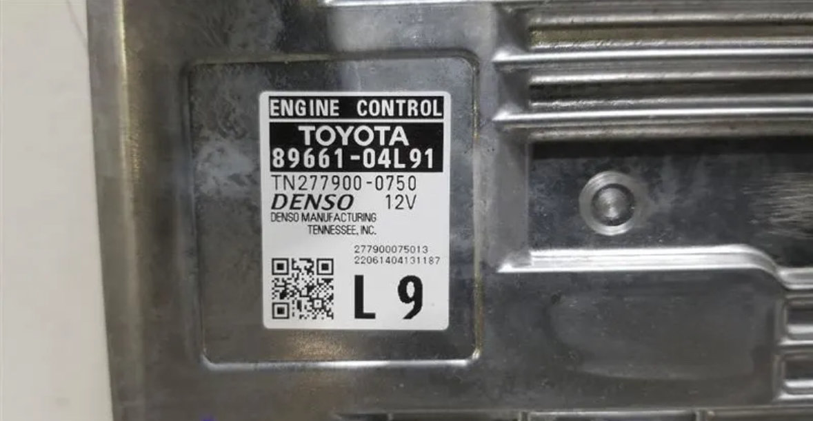

    Think ECM got fried, I have found a donor out of same truck. Does it require to be flashed? Same year model

    The PCM? Or which module are you talking about?

    I'm not sure on 3rd gens (@Bishop84 may know), on 2nd gens you just needed the same part number PCM and had to reset the immobilizer for the engine to run.
    How did you determine the PCM is bad?
    I thought the engine ran but you had issues with other stuff?
    Did you see what communicates with a scan tool and what doesn't?

    I believe the immobilizer has to be reset and the keys have to be re-programmed to the new ECM.
    The vin has to be written to the ECM as well, but most mid grade scanners can do that.
    You need authorization to do an immobilizer reset from Toyota directly.

    Looks like that's just if you have the smart key system (push button start), the standard key looks like it uses the same jumper reset method as 2nd gens.
    I wasn't sure about the the programming, it's unusual for any module anymore to not need programming (or to even be able to use a used module without doing EEPROM work) but Toyota seems to not be that way for the most part.
