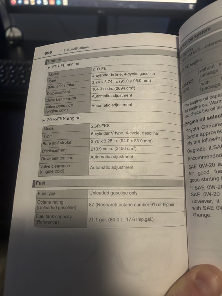

    Toyota use RON method for octane specs
    US 87 =91 RON

    Here is a page from the manual:
    Very clear its US 87 or higher, or 91 RON or higher.
    FWIW all my japanese marque vehicles ran better and got better fuel economy on 91 or higher.

    Some folks using this reference to argue the obvious

    No, 87 octane is not the same as 91 RON; while 87 octane refers to the standard "regular" gasoline in the US, 91 RON is a higher octane rating typically considered "mid-grade" or "premium" gasoline, meaning 87 octane is generally considered lower than 91 RON.

    91 you are referring to is 95 RON.
    If you want to compare octanes, datalog ecu while driving on 87 and 91. Performance on 91 is marginal compare to the difference in the price.
