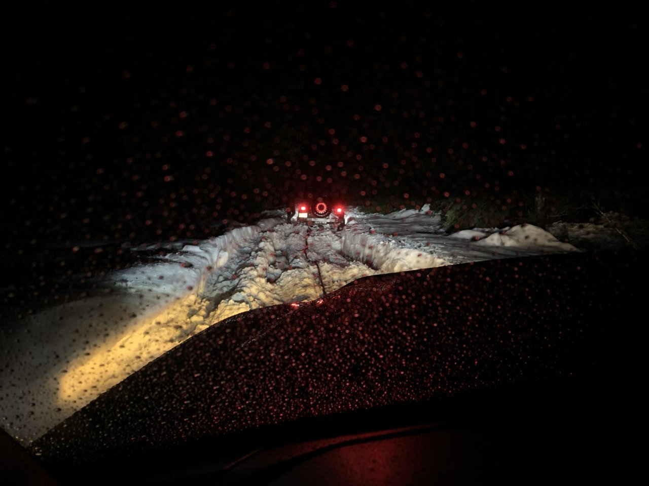

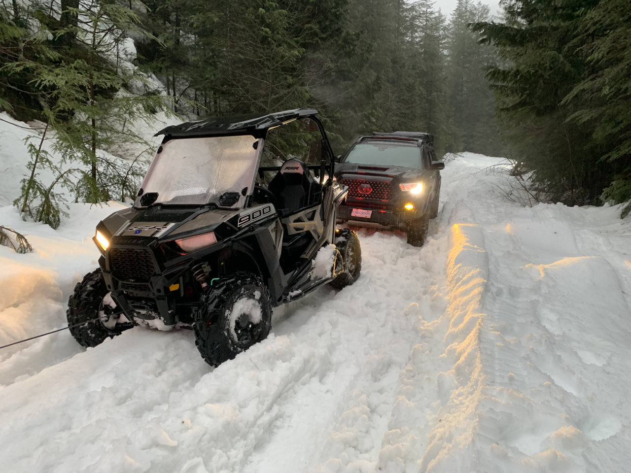

    FWIW I did quite a few hard pulls on my sport front tow hook. It was done with a kinetic rope.
    Conditions were quite rough. Terrible 7 hours of my life:
