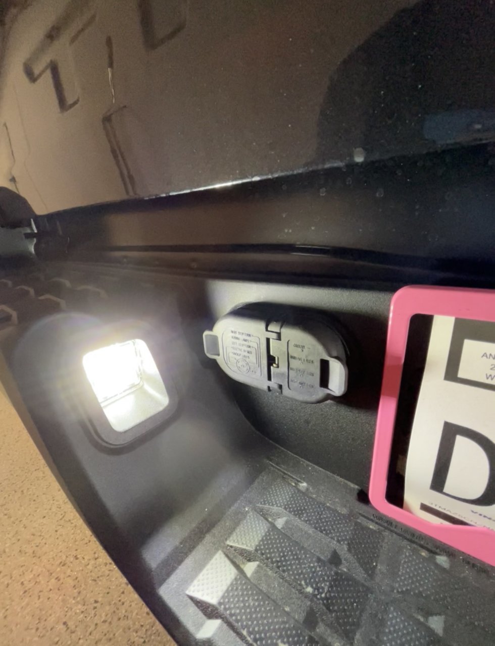

    Just a heads up, if that plug isn't shielded somehow, be weary of corrosion. Bare minimum, I'd be cramming dielectric grease all around that plug / contacts.

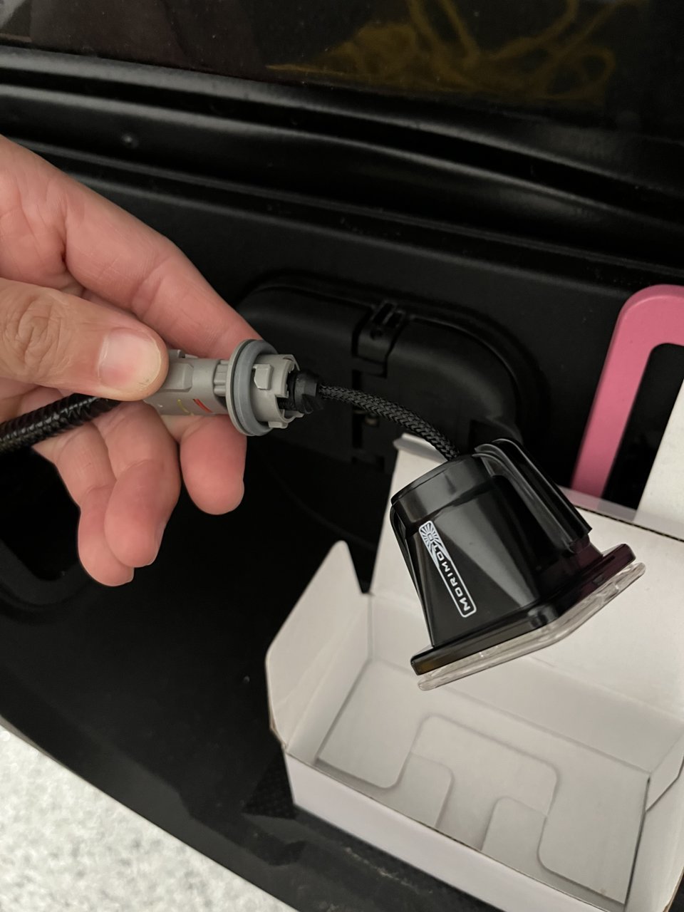

    put these on today on my 2022.......took 5 min.......I didnt finesse the oems out, just put a flat screwdriver under lock tab and twisted till tab broke , then pushed the assembly out the hole to swap out......this method better than bloody knuckles and what would I have done with the oems?
