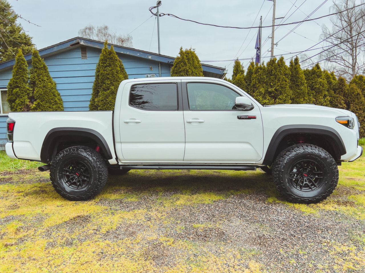

    I put 33s on mine using the Eibach pro spring upgrades and 1” block in the rear (I don’t haul much), but some can stuff 33s in there without mods. Just a heads up because you’re new around these parts: TW folks will give you a ton of shit for buying a pro only to toss out much of what makes it a pro (including messing with the suspension by adding spacers). That being said, pick your battles. Do your research on reputable websites. Most importantly, it’s your truck and money, so do what makes you happy.

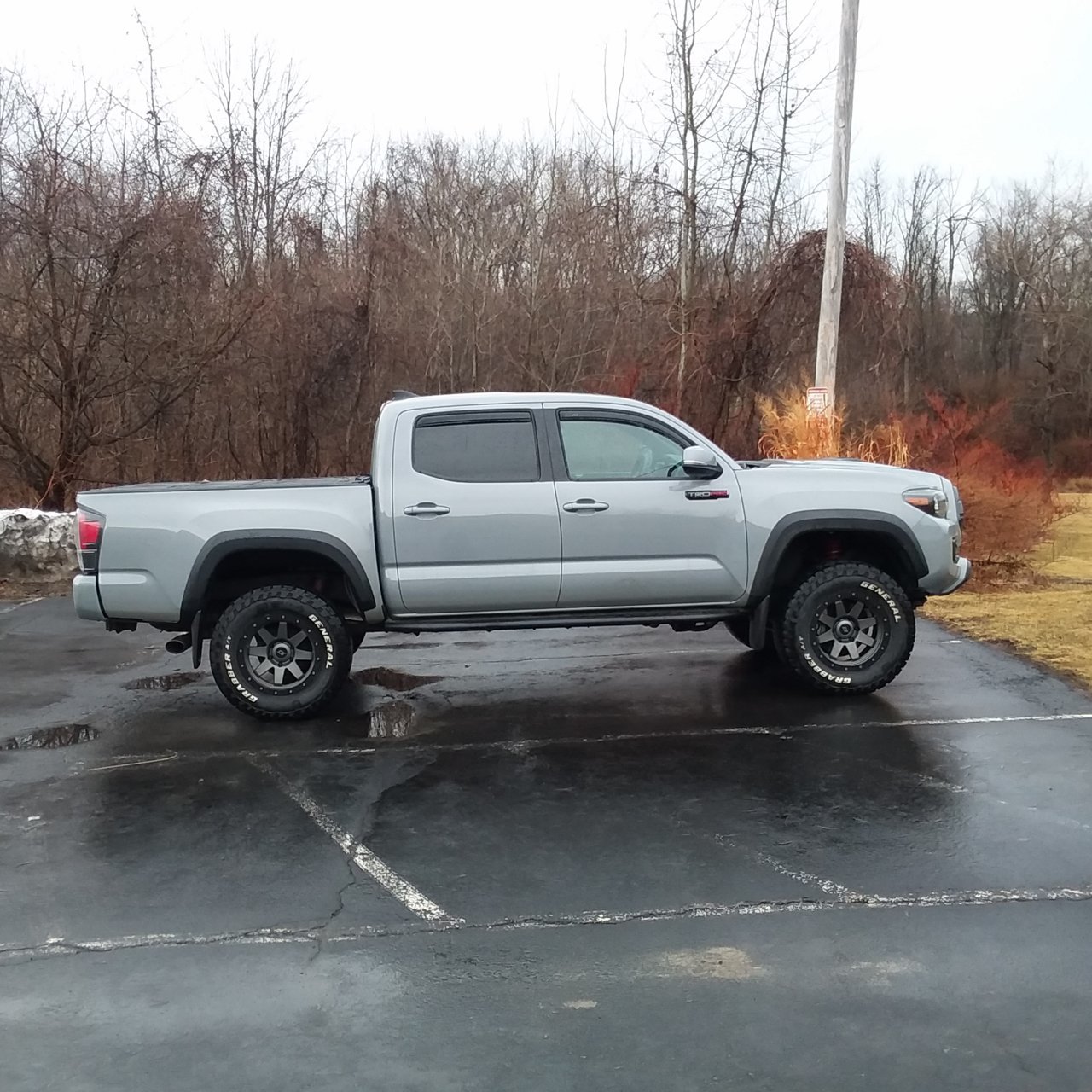

    my 2017 Pro, EiBach front springs with 1/4 in top plate spacer {both sides}.......2 in. tapered block in rear.. about a 1/2 in. rake..
    265/75/70, SCS wheels.......285's soon.
