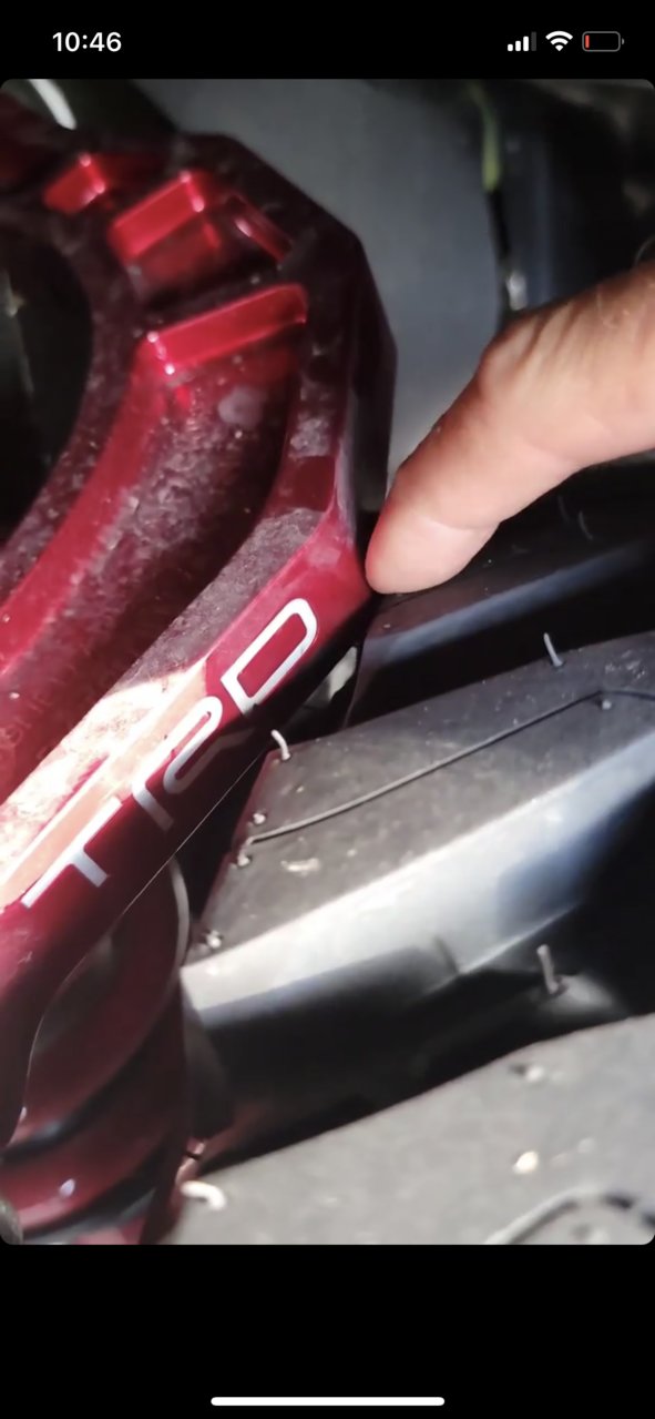

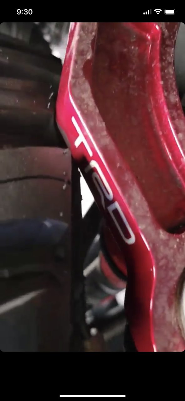

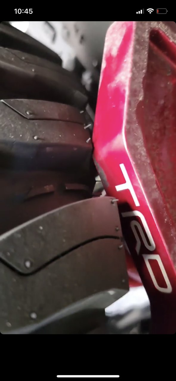

    Sharing some photos of the new UCA from a video that was posted to Insta. It appears the new UCA is not able to clear 285/75r16 on stock TRD Pro wheels. 2021 and earlier models do not have this issue. Kinda surprised Toyota didn’t engineer a control arm that can accommodate 285s.
    Driver and passenger sides both rub, you can see some of the red paint coming off. The tires are Toyo MT, but I’d assume most of the other 285s will rub.
    Close up of the strut assembly seems to point to no top spacer, as this looks identical to the 2020-2021 setup. I’m betting a taller spring was used, and the valving was slightly modified for 2022 Fox shocks.

    Dang, no disputing that. I wonder if Eibach’s spring upgrade for 20-21 is simply what they used for 22, considering that make the springs for Fox/Toyota.

    Pretty disappointing news on this. Is this at full lock or just all the time?
    Do you think spacers and or a lift could fox this?
    Thanks for the info!

    Mine only rubs slightly at full lock. These pictures look like they rub more than mine do, probably because these are MT’s?
    I don’t want to add more lift and I don’t want to mess with the caster on my wheel alignment at this point because I’m happy with the setup and functionality that I have at the moment.
    I went out on some forest roads and light wheeling last week and didn’t rub at all, but I was being super careful. It def needs to be fixed for a long term 4x4 application.
    I’ve ordered both .75” and 1” spacers from Motorsport Tech to see what works. I would like to minimize the wheel poke but still have a solution; I’m really happy with the look and stance that I have right now.
