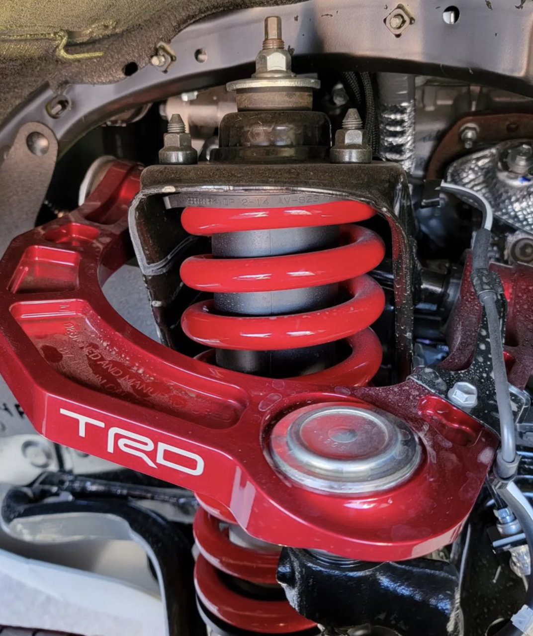

    Here’s a blurry pic.

    I think Toyota engineered the truck around the stock tire size. That's why the Pro and Off Road share the same size tires. The control arms are also engineered to work on the truck, with the stock tires.

    This is at full lock, on Toyo MT tires.
    A lift would not help with rubbing on the control arm. You’d want to move the tire outward, away from the middle of the vehicle, and that can be achieved with wheel spacers or negative offset wheels. However both those options create new issues, such as rubbing on the cab mount, pinch weld, plastic wheel well liner, ect.

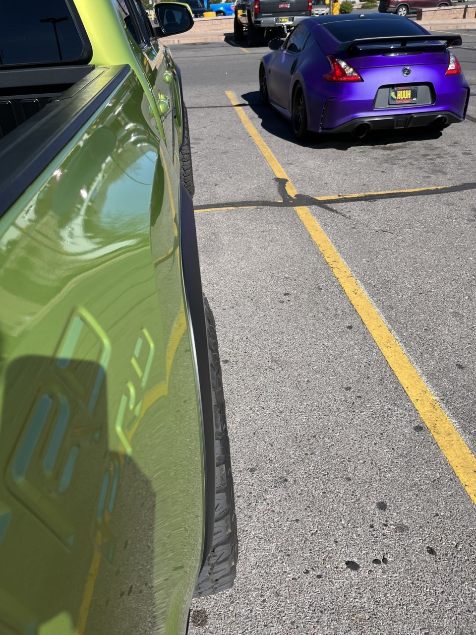

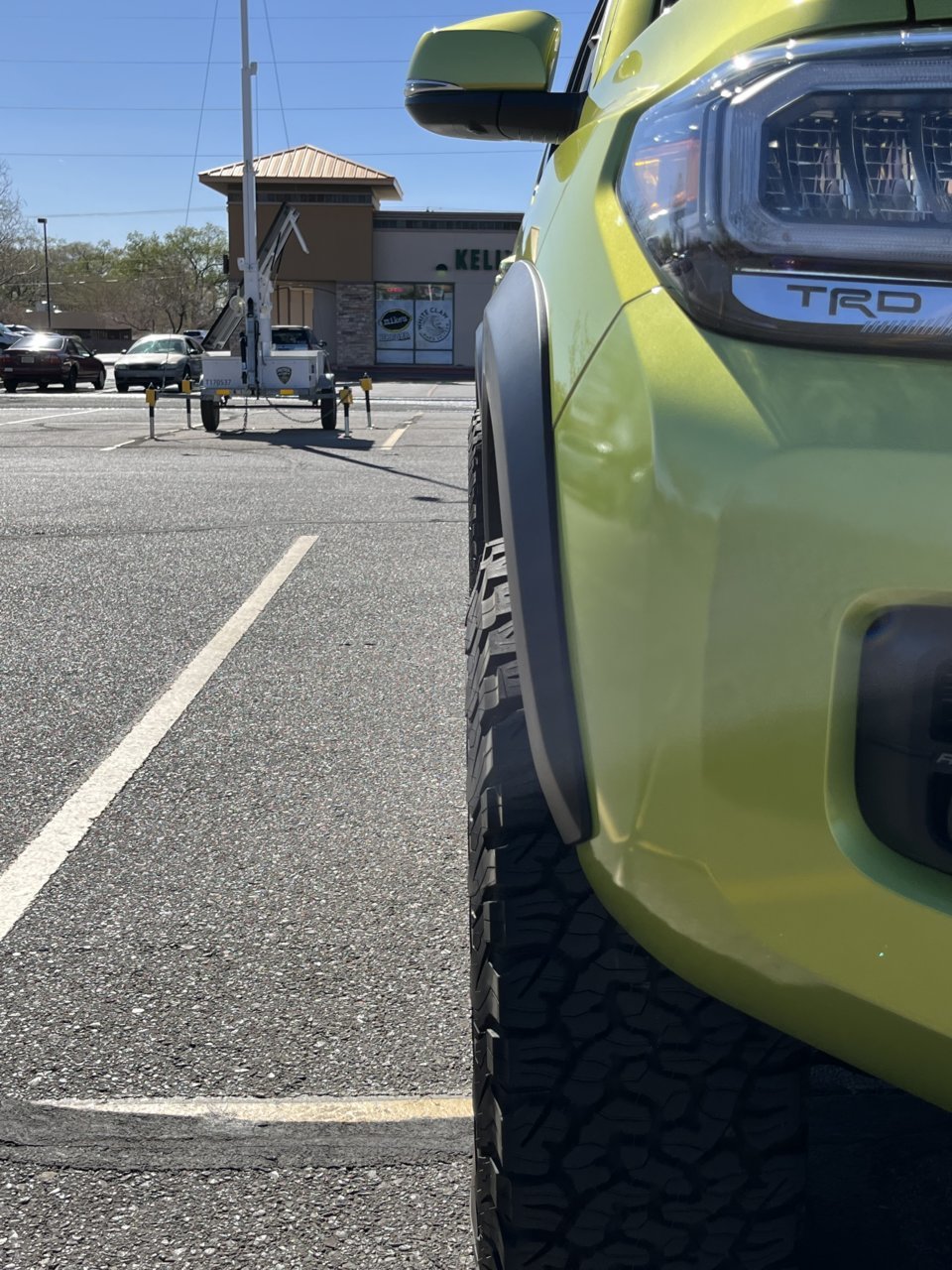

    Any chance you can take picture looking down the side of the truck? Curious on the amount of poke now.

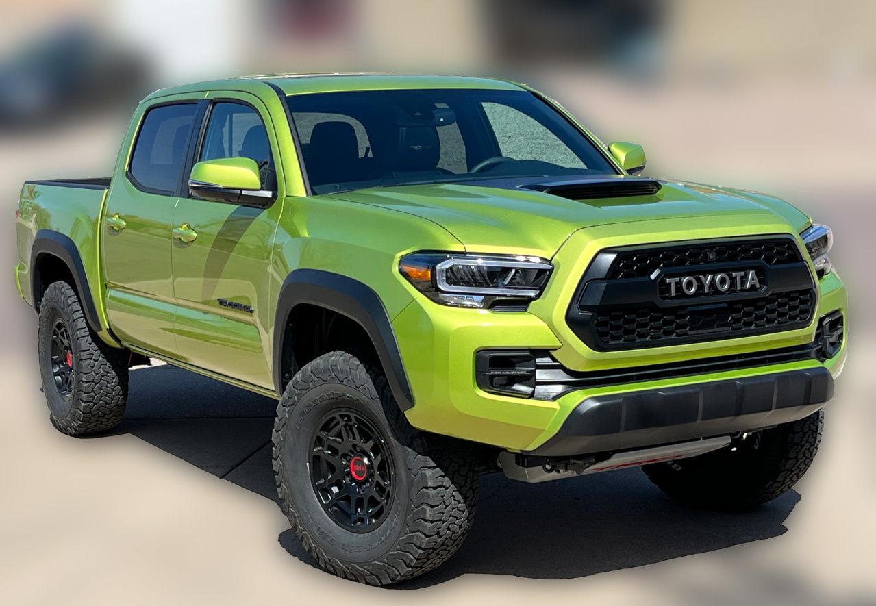

    Here’s a couple of pictures. Hard to capture the true look of them. I am not a huge fan of excess wheel poke, but if this is what will get 285s not rubbing on the UCA, I’m okay with it. I think it looks pretty good, but I would not want much more….but everyone has their own opinion.

    I could live with that. I am with you, I don’t particularly like wheel poke but this doesn’t look bad. It looks way better than some of the tacomas I have seen here (locally) that are poking out 2”.

    Yeah, I really liked it with just the wheels and tires after they were mounted, but this is fine, and it’s nice to not worry about destroying any of the suspension. I’m kind of OCD about stuff like this, so that doesn’t help….my wife reminds me that know one else sees it as critically as I do, nor cares. :rofl:

    I understand your OCD. I’m right there with you. I wouldn’t mind putting 285s on my pro. But with the reduced mpg and then worrying about rub, I might just stay stock size. I might go 265/75. I just can’t make up my mind. I like the look and stance you have.
