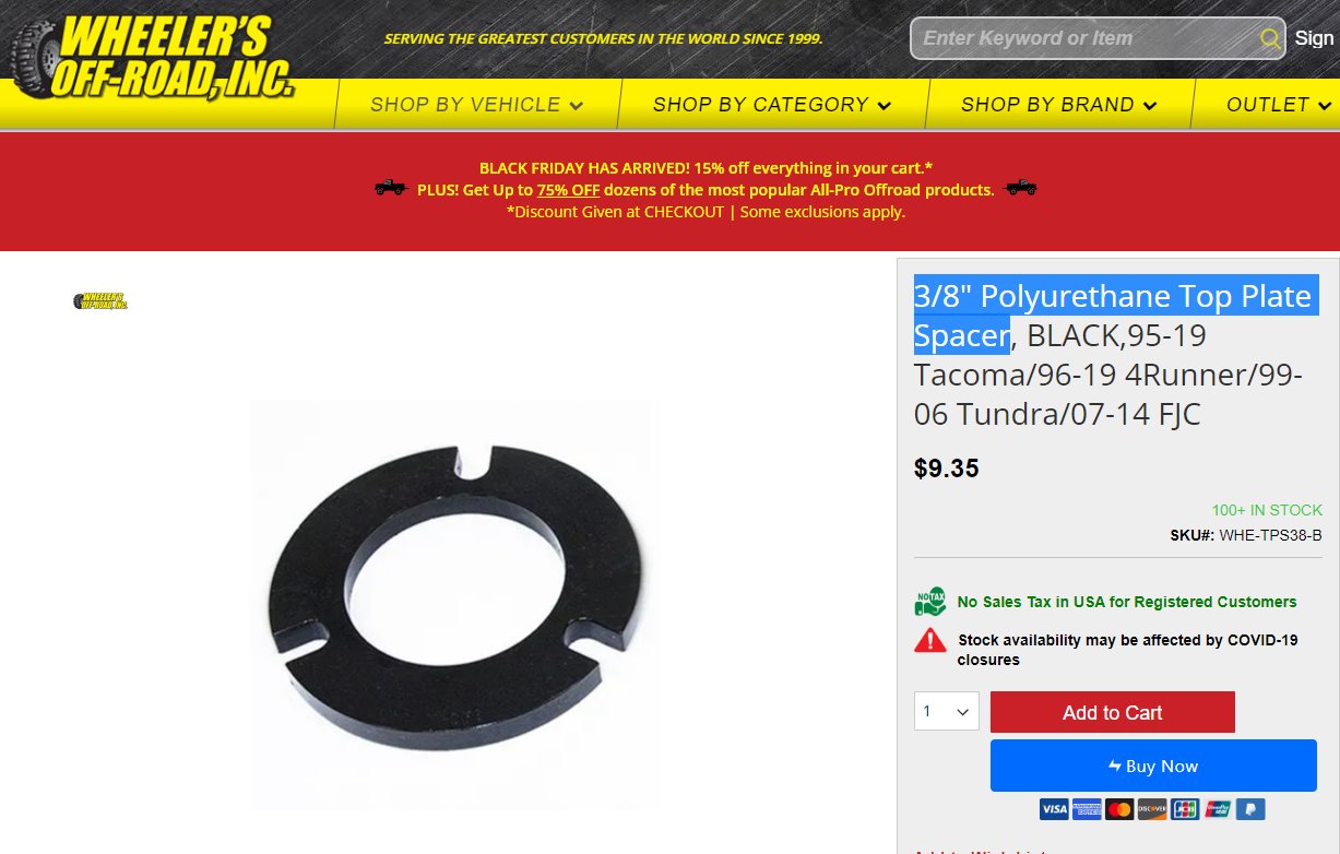

    Did anyone pull the trigger on strut spacer? I have been sitting on a 3/8" (passenger side) and 1/2" (driver side) from Wheelers Off-Road assuming I have to find new bolts. Pretty sure 1/4" is safe with OEM bolts from what I read, cant find any intel on these slightly larger ones. Anyone know the OEM bolt specs?

    I have the same question as I want to put in a small spacer to fix the Taco Lean. I was looking at this vs. the 1/4" Headstrong spacer, which is much more expensive at $30. Any concerns about using the poly spacer?

    My neighbor ran these poly spacers on his super built Tacoma just because he didn't want to preload his kings to get the 2.5" inches of lift and he had no issues. I got these for the same reason but I think I am just going to go a little smaller-- 1/4" passenger side and 3/8" on the driver side. I just cant find the specs on the factory bolts and I want buy new ones before I have my truck on jack stands.
