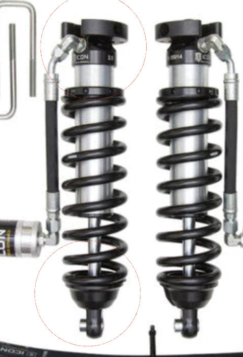

    My what a thick top hat this icon has.
    my what a thick spring perch.
    wow what a short spring …..
    If a guy would adjust this it might have more preload.
    “These coilovers are also height adjustable from 0-3”
    Hmmmm, interesting.
    Must be a spacer lift.
  18. Nov 19, 2022 at 11:16 AM
