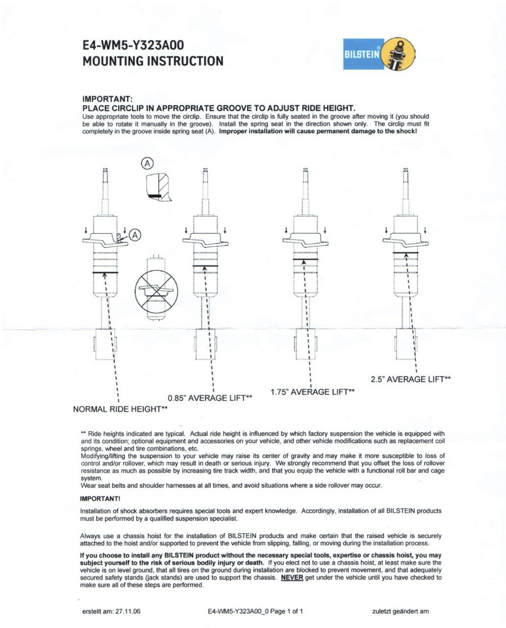

    Well well look how Bilstein 5100 adjusts lift height.
    oh they move the spring perch up
    Amazing
    I wonder if that is the same effect as a thicker spring perch….Or maybe the same as screwing a nut up a threaded shock tube on a ADJUSTABLE coil-over???
    I bet it is
    I wonder if either of these methods increase preload on the spring???
    I guess we will never know ;)

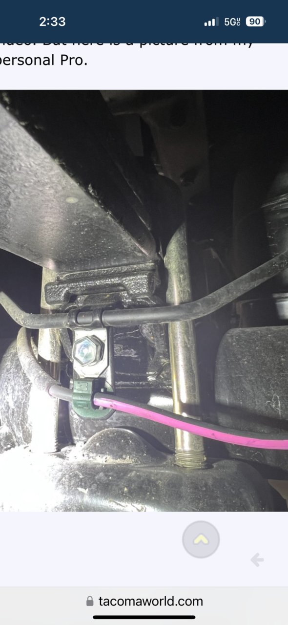

  11. Jun 20, 2023 at 6:06 PM
    #151
    CaptainTikihut
    CaptainTikihut Well-Known Member
    Dec 24, 2016
    #205623
    705
    NorCal
    2017 Taco Supreme w Stuff
    No built in angle adjustment, no separate shim. The pics below is the 1" block.42CEEAF9-76B3-4C96-82DC-DAC86C5396C7.jpgF3BABD96-9C03-456A-BDD8-C11C2704950C.jpgDF3DCAD4-51CD-48B9-BA9F-3DD28E8577BD.jpg

  12. Jun 20, 2023 at 6:09 PM
    #152
    CaptainTikihut
    Dec 24, 2016
    #205623
    705
    NorCal
    The 1/2" block is also not angled.C34D49B4-9C4A-4426-941D-FAB1C1BC660D.png

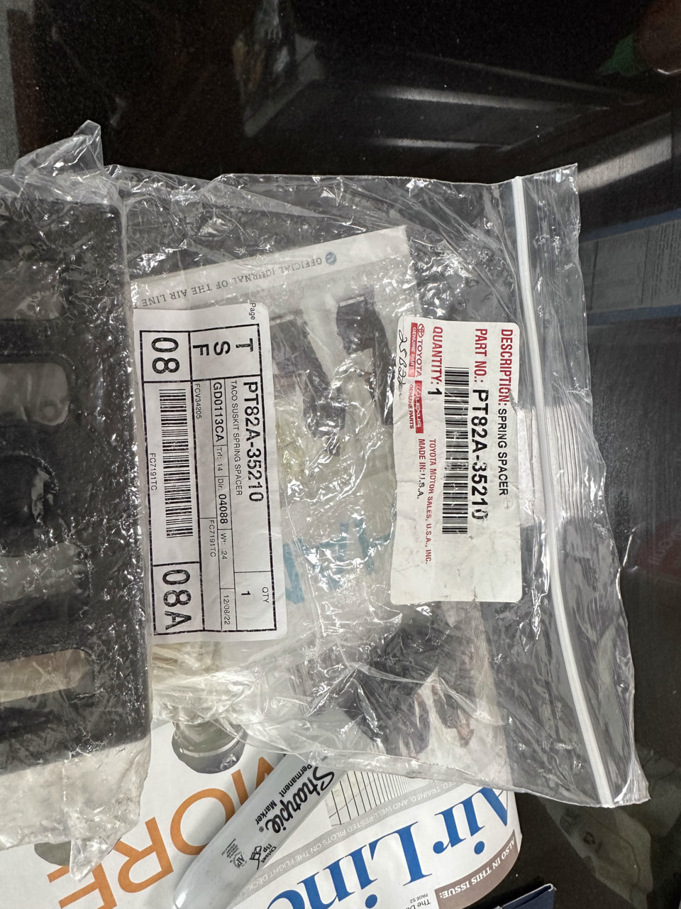

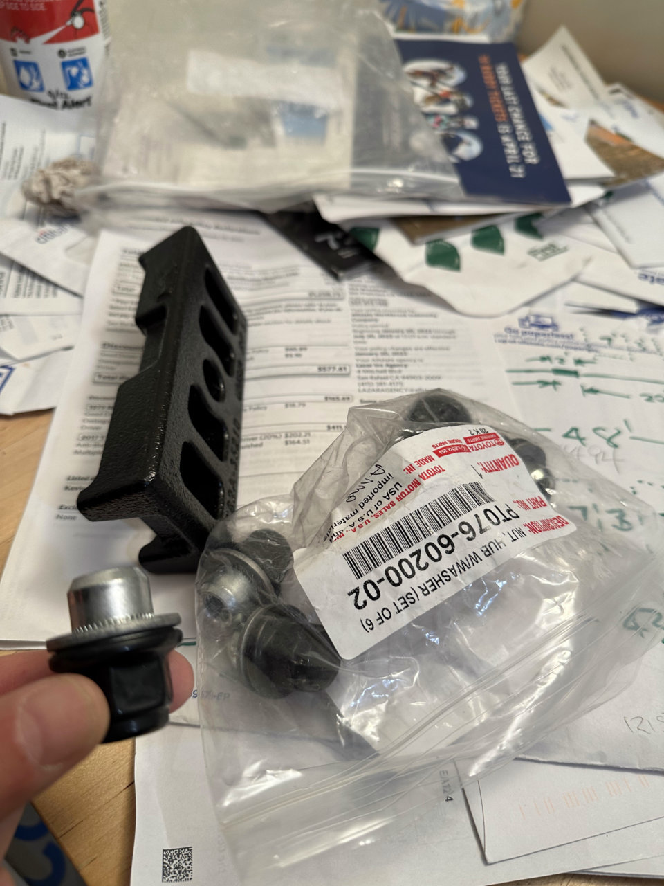

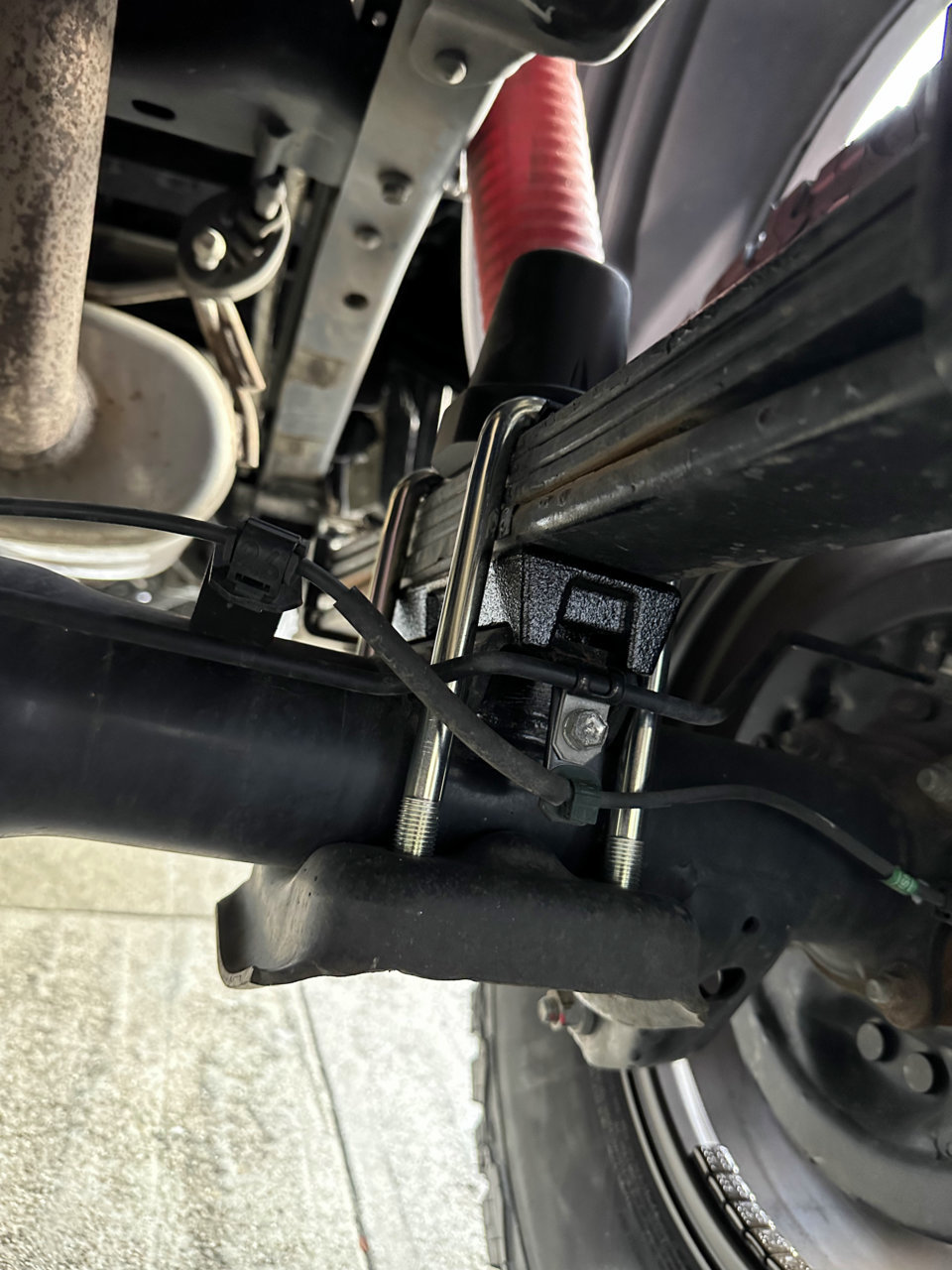

  13. May 1, 2024 at 2:07 PM
    #153
    Yotamachine
    Yotamachine Well-Known Member
    Feb 20, 2018
    #245069
    218
    2001 Yota
    Can anyone confirm if the TRD Pro rear lift spacer requires longer u-bolts as well? I found ones from the trd lift (90117-14011) but kinda pricey.
    Also, would it be worth installing the leaf springs from the TRD PRO that the seller threw in with the pro suspension sale (with 4k miles on it) or should I just keep the current leaf oem leaf pack and just add the rear spacer block?
  14. Sep 13, 2024 at 3:33 PM
    #154
    Mtaco14
    Mtaco14 Well-Known Member
    Feb 14, 2024
    #443839
    104
    Nevada
    2023 TRD Off-Road
    I am also looking for the part# for the rear TRD PRO U bolts from 2022-2023. If it's got that rear block I'm only guessing the U bolts are longer.
