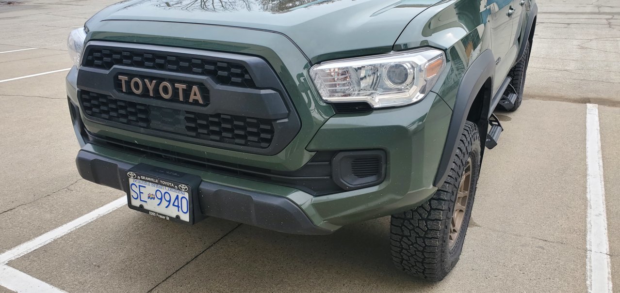

    JohnBeauchamp
    JohnBeauchamp [OP] New Member
    Dec 29, 2022
    #414218
    4
    John
    2022 Tacoma Trail Edition

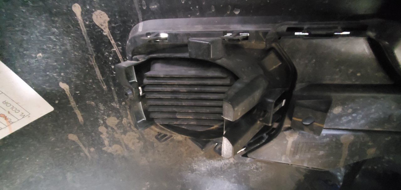

    JohnBeauchamp
    Dec 29, 2022
    #414218
    4
    John

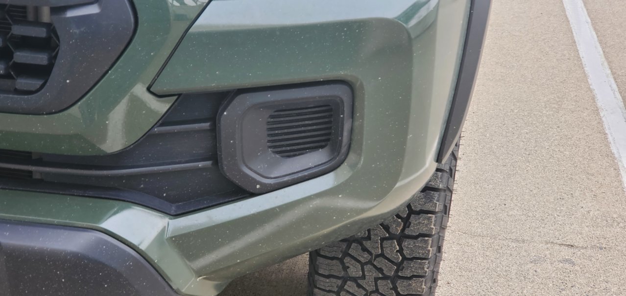

    Doesnt seem to hve the screw holes...

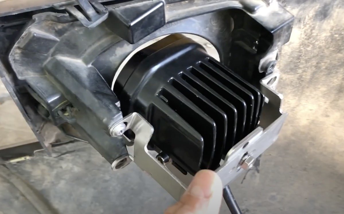

    South of Boston, Massachusetts
    2020 TRD Pro MGM
    Doesn't need them. On the side without screws there is slots that the bracket slips into, then just the one screw on the other side holds them in place.

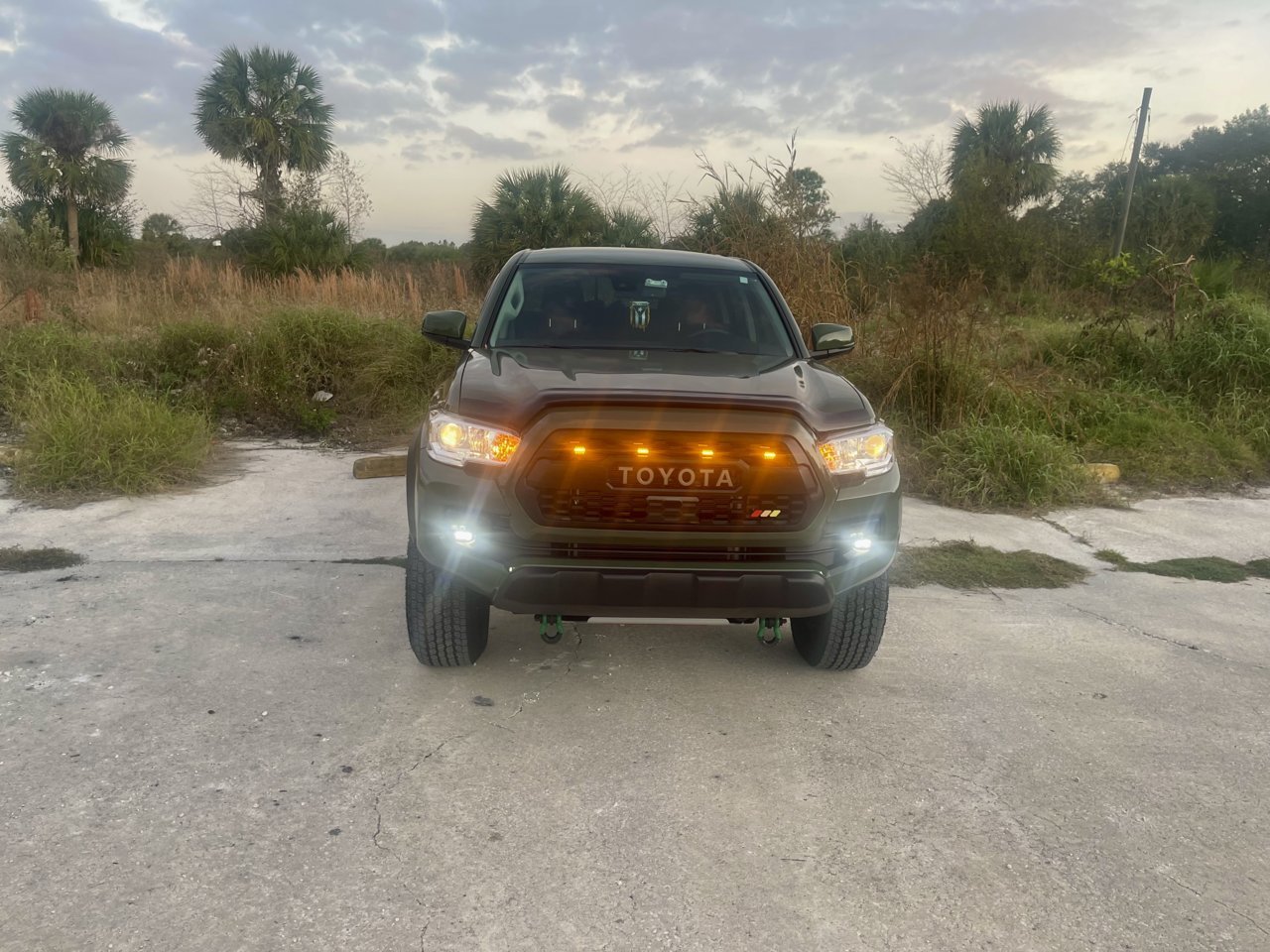

    Ed
    Apopka, Fl
    2022 SR5 Trail Edition Army Green
    355F6C77-2AA3-4704-8E40-40715CF75264.jpg I went with the Rigid Industries TRD Pro fog lights all is OEM with 12 months warranty. Dealer wanted $1,800.00. I did it myself cost 650.00.

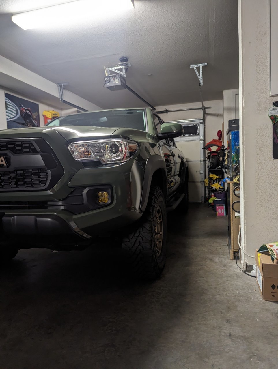

    Diode dynamics SS3 pro fogs, led bed lights, 35%tint, 265/75-16 Yokohama G003
    I can tell you my 2022 Trail worked by installing the parts listed. I installed the Diode Dynamics SS3 pros.
