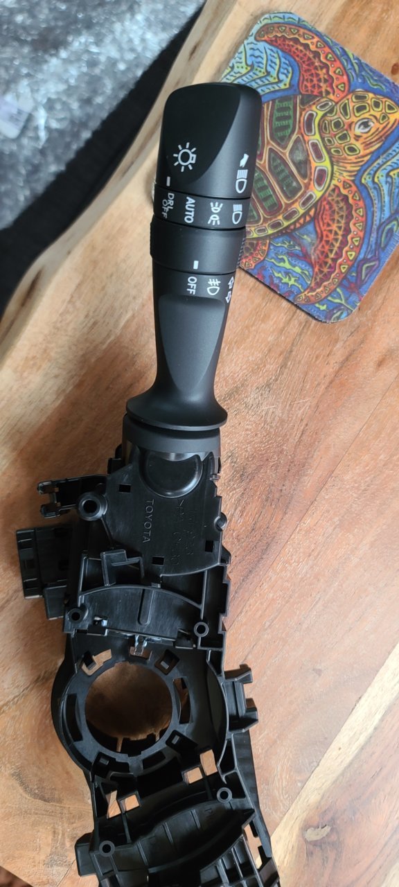

    95B856F8-CF64-4649-A850-209324A5F70D.jpg So it can work as an OEM you also going to need to swap the stalk with this other one; 841400R010 switch assembly headlamp dimmer. The photo shows where the wires are located Teal and White. You can find either here or on You Tube the how to install it.

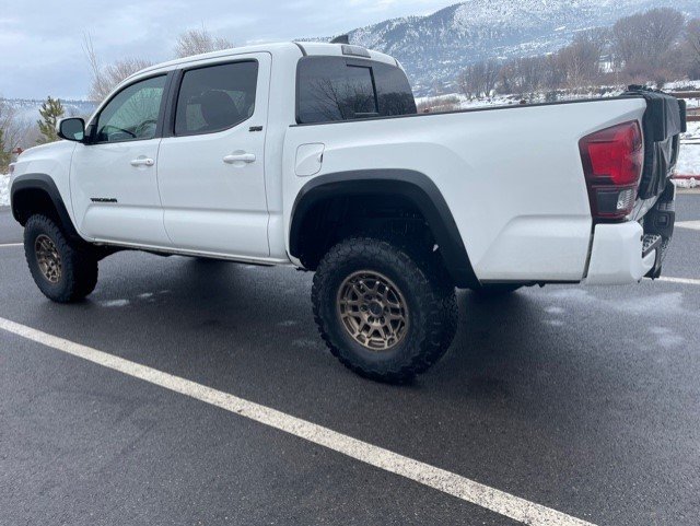

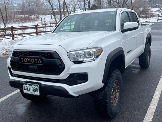

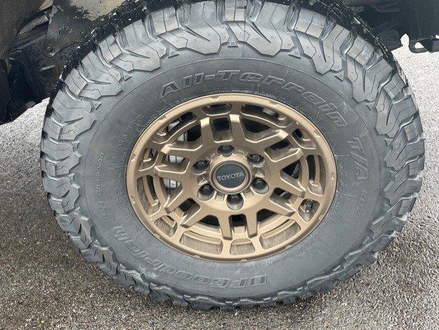

    Update tires and shocks on your Trail Edition?
    Yes...
    BF Goodrich LT265/75R16 All Terrain T/A KO2 and Bilstein B8 5100 ride height adjustable shock absorber 24-263108 & Bilstein 5100 Series shock absorber 24-186728.
    Coil Spring strut spacers and Pro Comp Rear add-a-leaf set 13120 and Rear Block kit
    No Rub with these tires and truck has a 2" lift parts and labor out the door was $2920.58 at 4wheelparts Albuquerque NM.
