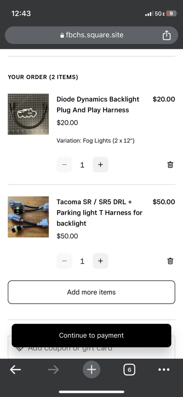

    For SR5 you're kind of up the creek a bit on choices, sorry. B/c DRL and Turn are combined, the _best_ plan is two single 12" ss3 harnesses and the backlight item linked above.
    The dual output 12+60 is for TRD primarily where you have a clean DRL signal which won't flash. B/c it'd be really odd to have both your backlights flashing with L or R turn signals, I think that would confuse people. My grille light kit combines the L and R sides so it has that wire across the dash to do so, hence the extra cost.

    Ok sorry to bother once more, but these two items, correct?

    Yes

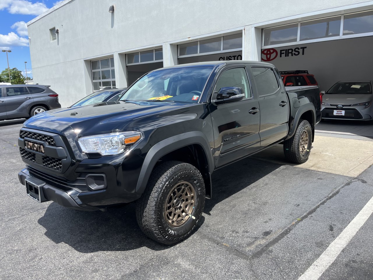

    Picked up my black TE today. I love it. And so begins the mods. Just ordered the predator steps. I’m going to be ordering the Rigid Pro fogs, and I’ll be ordering a switch for it for the dash to the left of the steering wheel. Other mods I want to do soon is add heated seats with switches and probably LED Alpharex head lights.

    Any reason you’re going with a switch vs replacing the stalk for the fogs? I was torn between the 2 initially but ended up doing the stalk as it keeps a spot open for other switches later down the line
    Looks good in black, love Bronze on Black! Nice rig!
