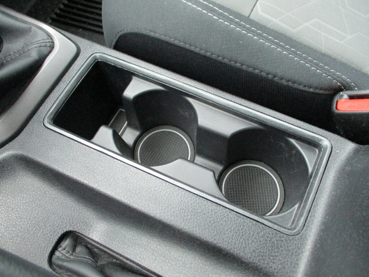

    Yes, you can pry it right out for painting. No need to disassemble the console.
    I would suggest stripping the chrome before painting. This is easily done by soaking the part in strong bleach for at least two weeks. Be patient. Since the underlying plastic is black, it may not be necessary to paint it at all. I painted mine in Magnetic Gray Metallic, for a nice contrast.

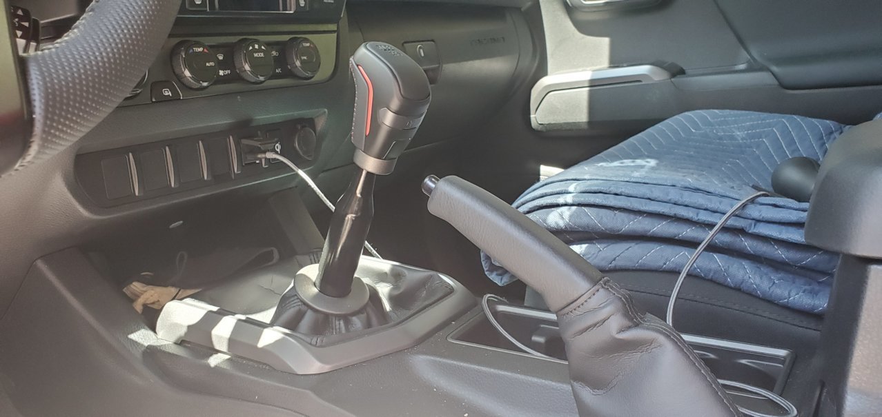

    * and the sun visor screws!
    "You're welcome" to anyone who was previously unaware and is now annoyed by those screws. :thumbsup:

    That looks awesome! What paint did you use? Spray paint?

    I painted that a few months back but didn't use any primer or adhesion promoter and now it's already chipping like crazy.
    I'm assuming to get another part and try again Toyota would probably make me buy that whole center console segment. Does anyone know if that's a correct assumption?

    Did you remove the chrome first or just painted over it?

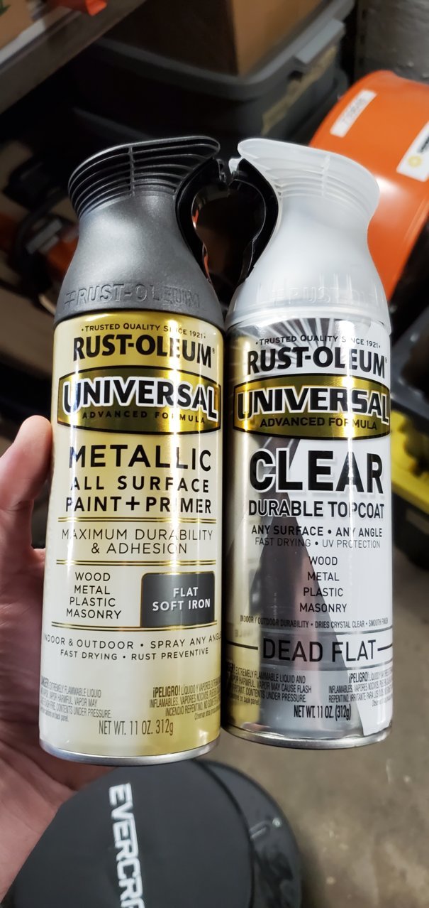

    Here's what I used (plus a clear coat) and it matches very well with the OEM gunmetal parts:
    The shift boot topper and under-knob ring were painted to match along with the cup holders.
    People seemed to have success soaking chromed plastic in bleach or using oven cleaner. After trying both enough times to guarantee lung cancer, I chalked it up to a loss and just tried sanding the chrome down. It worked relatively well, but not well enough, apparently...

    Dupli-Color Toyota Magnetic Gray Metallic spray paint. Give it a coat of gray primer first.
