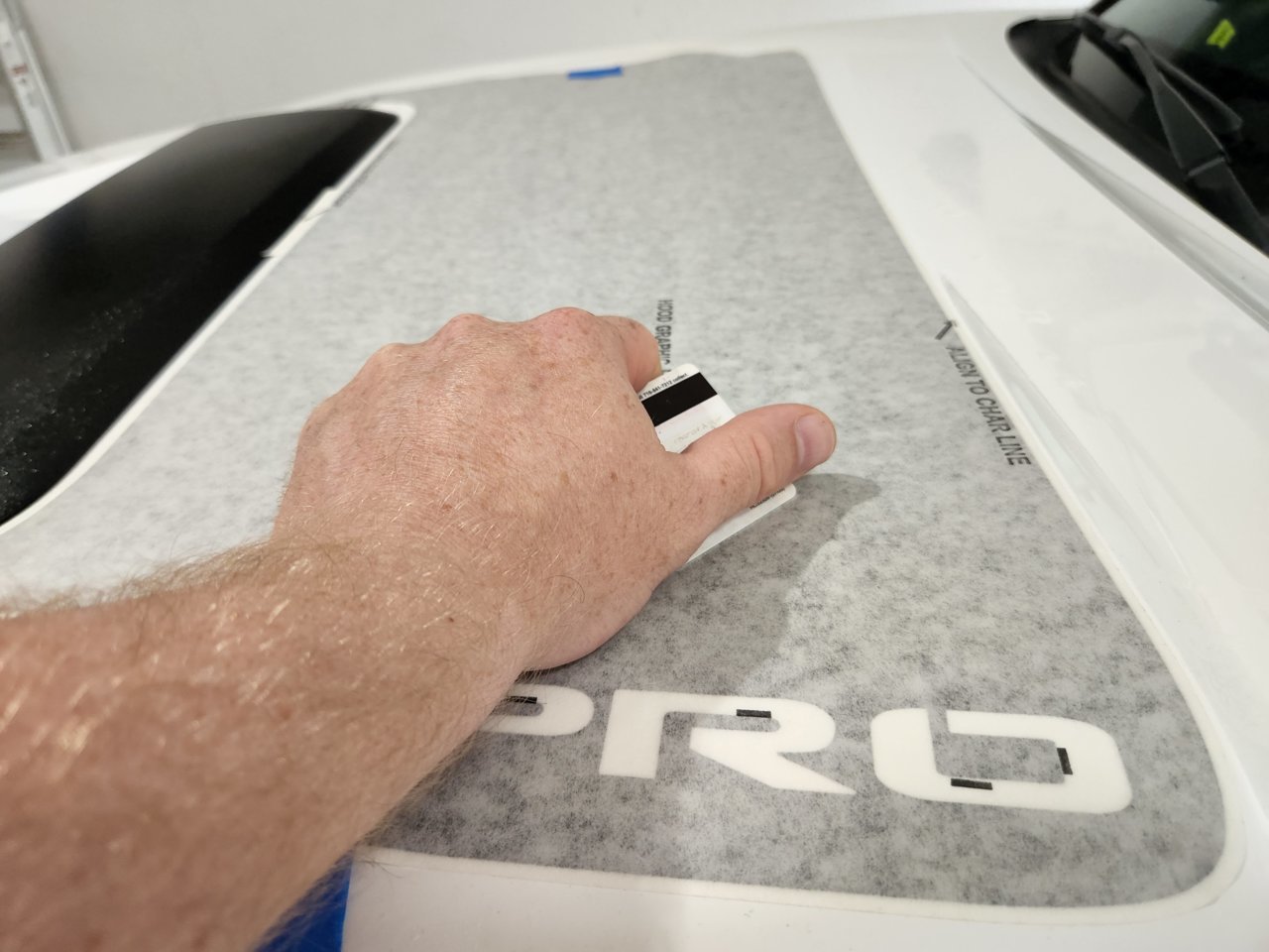

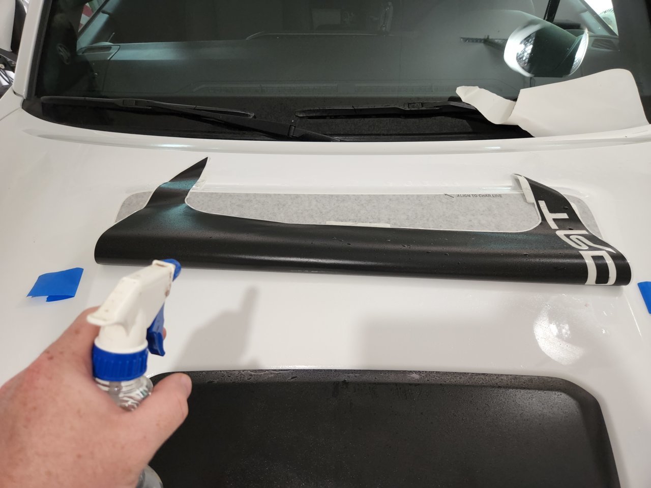

    28
    2021 TRD Pro

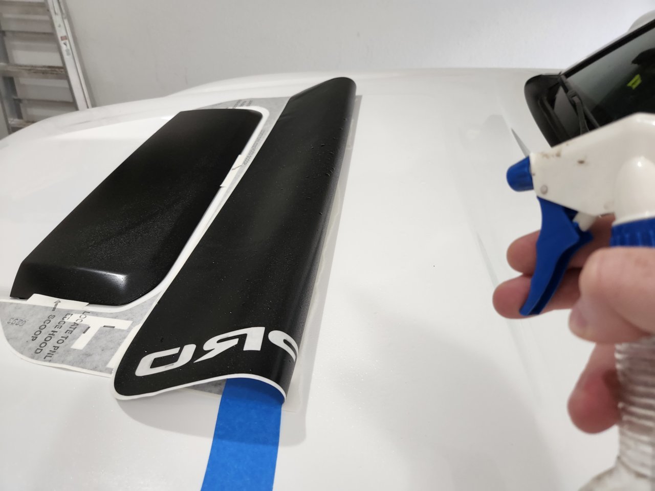

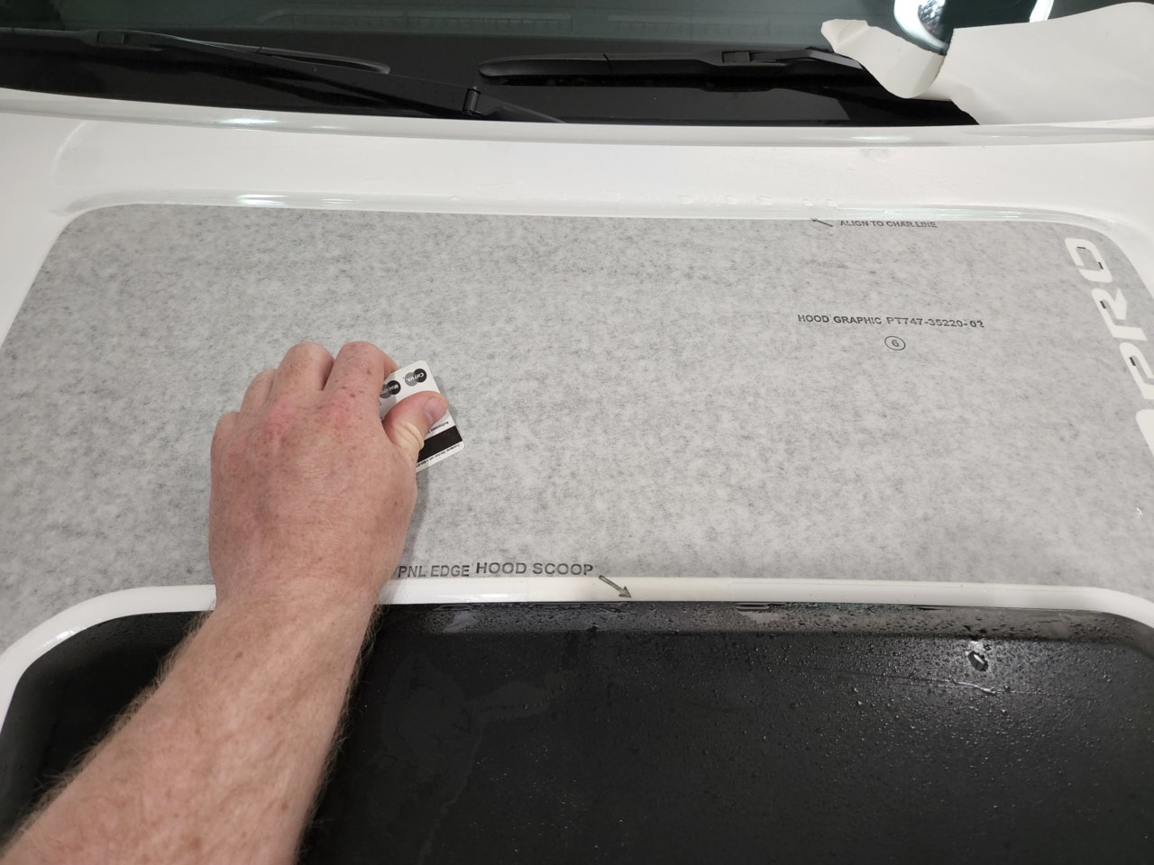

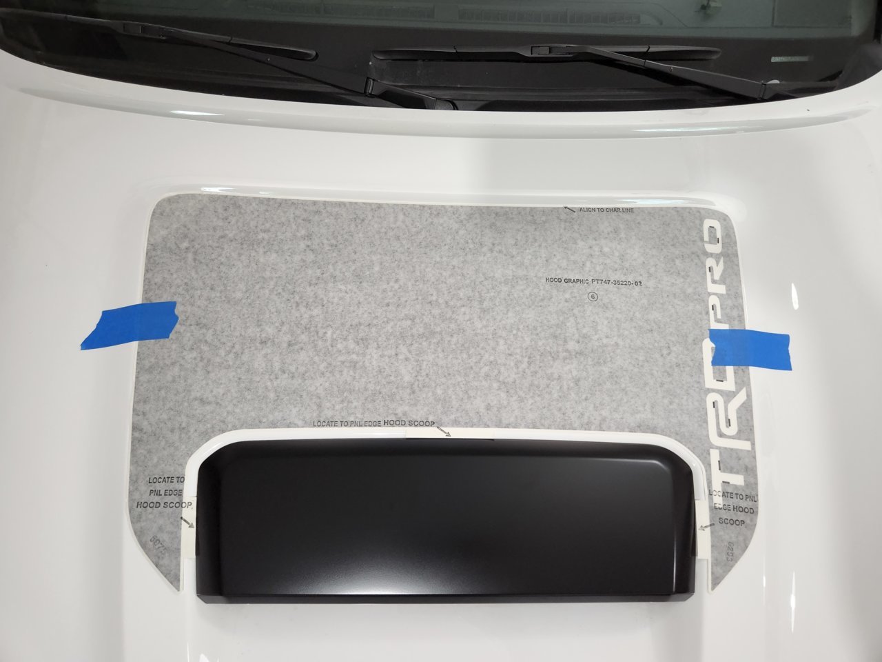

    Here you go. Center the decal, then tape it to the hood. Begin peeling the backing, then spray the adhesive side of the decal and hood with water. Rip/cut backing you just peeled then press decal on to hood. Squeegee water with a credit card or something similar. Repeat this process for the lower section of the decal, then remove protective paper. Took me about 15 minutes.

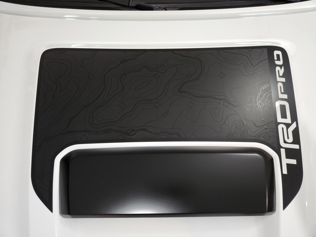

    There are a few small air bubbles that should resolve with exposure to the sun.

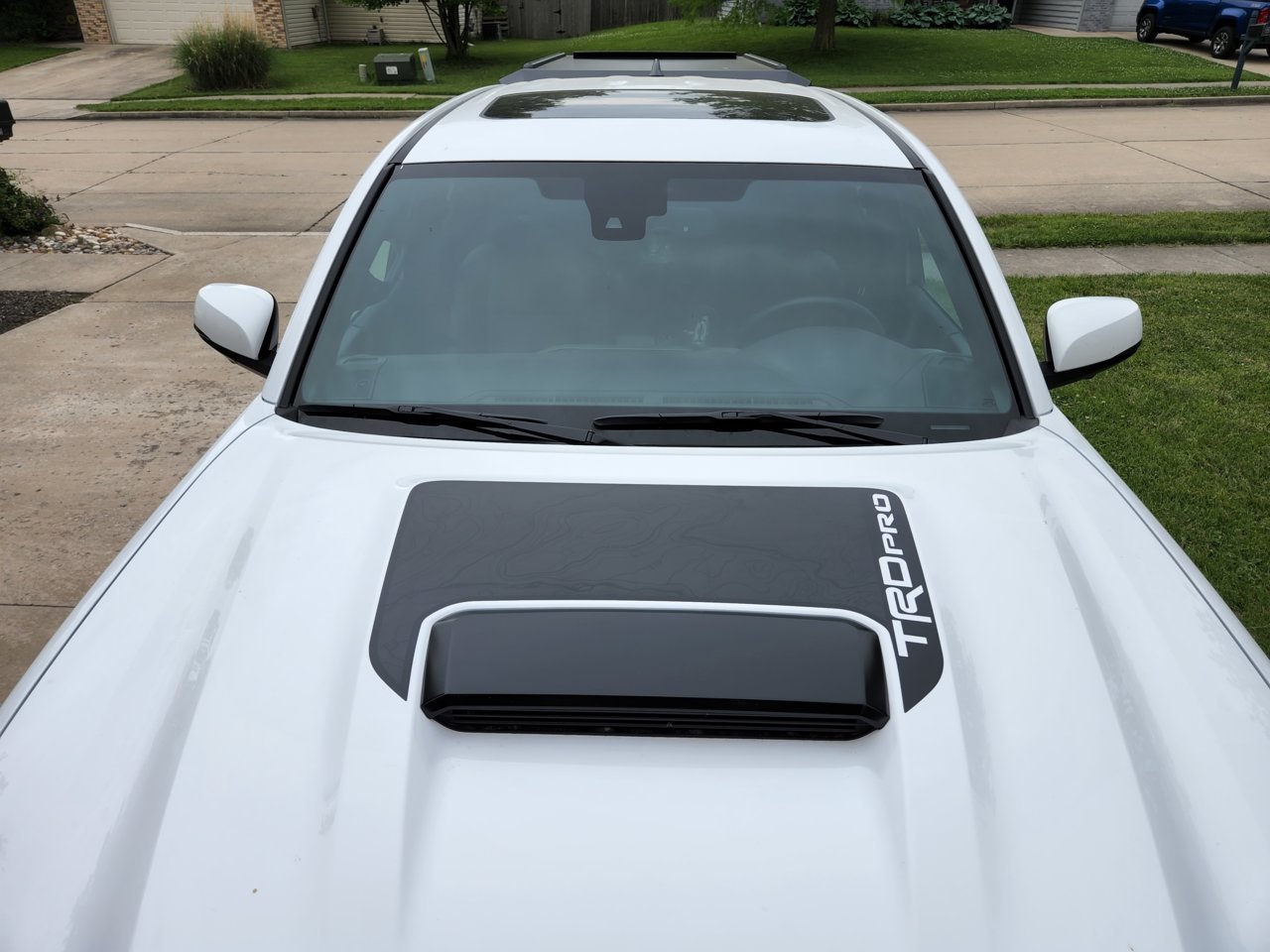

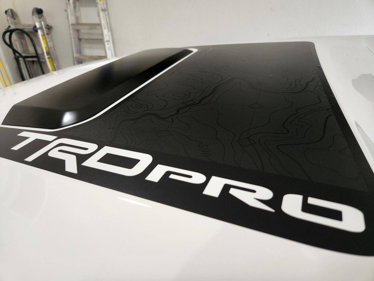

    Thanks was really hoping the lettering was matte black , I don’t have a pro and really like the decal . Not sure if I’ll do it yet , either way somethings going there

    i'm confused by your process description... what does taping the decal do? how do you remove the backside to expose the adhesive if its taped down?

    I’m picking my up tomorrow just over the border here in BC, I have a few quick questions. Why spray with water. Does it just help with smoothing it out during application? Just a few light mist sprays on the decal and the truck? Cheers, yours looks great it really completes the look on the pro! I wonder why all the Canadian ones were missing them in the first place?!
  14. Jun 28, 2022 at 8:08 AM
    #34
    Kefka
    Kefka Well-Known Member
    Sep 30, 2020
    #342374
    578
    01001010 01101111 01101000 01101110
    2019 MBM TRD PRO
    Water functions as a lubricant to prevent the decal from adhering immediately (note: I use a dilute solution of Dawn in water, e.g., 1-3 drops of surfactant and Q.S. with water). This allows you/the technician to realign and smooth the decal's topography during application as needed.
    @oreganoflow Applying adhesive tape holds the decal in alignment for seamless application. If you inspect @myelin's procedure, the bottom segment of the decal is fastened in place with blue tape, which permits the removal of the backing tape on the upper segment (presume it's torn off while in place). Once the upper segment is in place on the hood, you can remove the lower segment to finish the task.

    The "wet method" is definitely the way to apply decals like this. One thing to remember is there is no such thing as too much water.

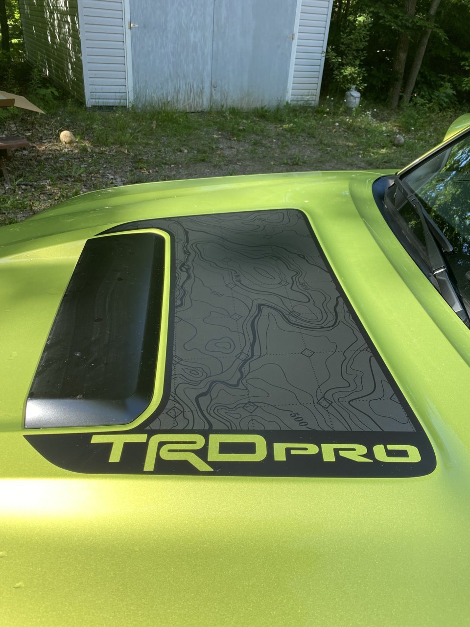

  20. Jan 19, 2023 at 12:32 PM
    #40
    MTBTACORN
    MTBTACORN Well-Known Member
    Mar 17, 2011
    #53212
    447
    Ontario, Canada
    23 Tacoma TRD Pro 21 Sportster S
    Anymore pics from a bit further away?
