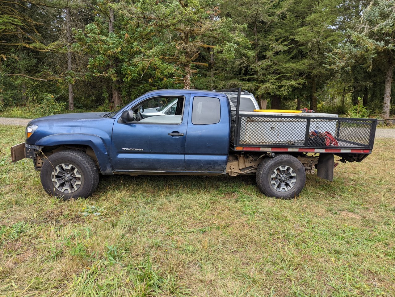

    Hello, first post here.. I have a 2006 Tacoma access cab with a flatbed on it, and am going to put a steel winch bumper on the front. I am looking for an affordable entry point to upgrade my suspension, with possibly a lift or level. (Currently my stock suspension is shot, and my leaf springs are bagged out with the flatbed installed)
    I found a 2022 Tacoma SR suspension setup available or a 2020 TRD Sport also for sale.
    I've read the lift benefits of the 2020 TRD sport, but I'm curious if anyone knows how that would compare to the 22 SR.
    Only obvious benefit to the 22 SR I can see is that it's 2 years newer suspension parts..
    Thanks!
