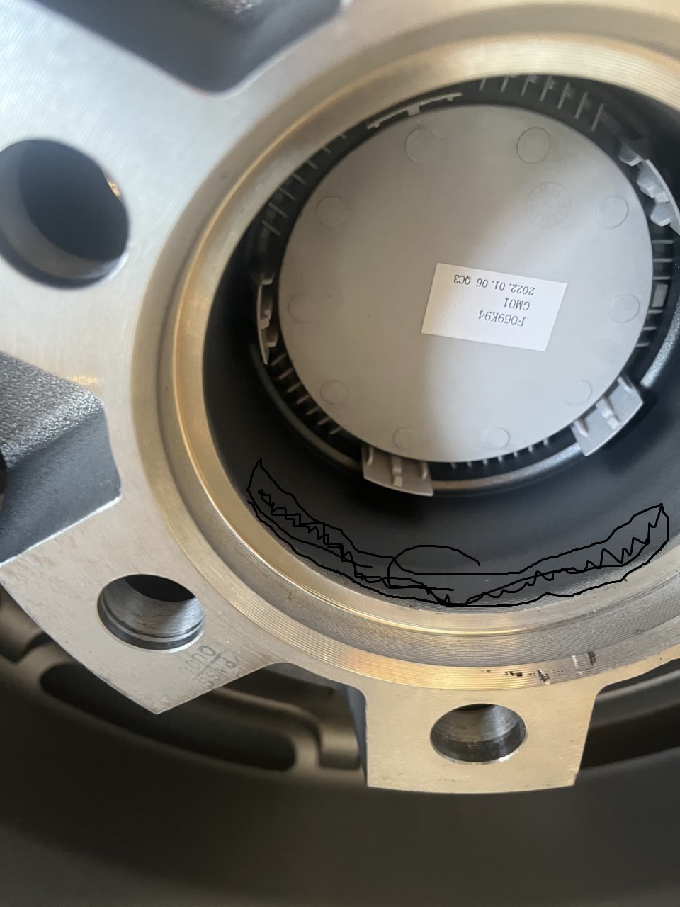

    Figured it out! The rear wheels fit perfect. The wheel bore is correct. The wheels fit the hub. The wheel at the bore steps down to a smaller diameter to accommodate the trucks steel dust cover on the front end of 4WD’s. My 2018 4WD dust cover did not fit in the smaller wheel diameter. I removed the dust covers and ground them down to a smaller diameter and the wheels fit. I suppose you could use the lug nuts to “suck” the wheels deforming the dust cover likely lodging it in the wheel. I removed only about 1 mm diameter on the dust covers.
    If the second wheel bore were a smidgen larger, I think the wheel would fit fine.
    Hope to get time to go back to tire store tomorrow the get them installed. :bananadance:

    I found the same issue (read your post after I posted above). I also ground the dust covers to make the wheels fit on the front. I did not grind the wheel.

    Anyone have a picture of exactly where you’re grinding to get these to fit? Feel like leaving this up to a tire store’s discretion could be a disaster.

    I don't have a pic now that the wheels are on but it's about a inch here:

    I tried just the dust cap and that wasn't enough so had to do the wheel, to be honest the grinding isn't that big of a deal and you don't see it but since I had to do it at the tire shop it cost me alot more money and time. If you can do it home before you go that's what I would have done if I knew what I know now.
    I would have them or you when you get home jack up one of the fronts and see if they come off.
