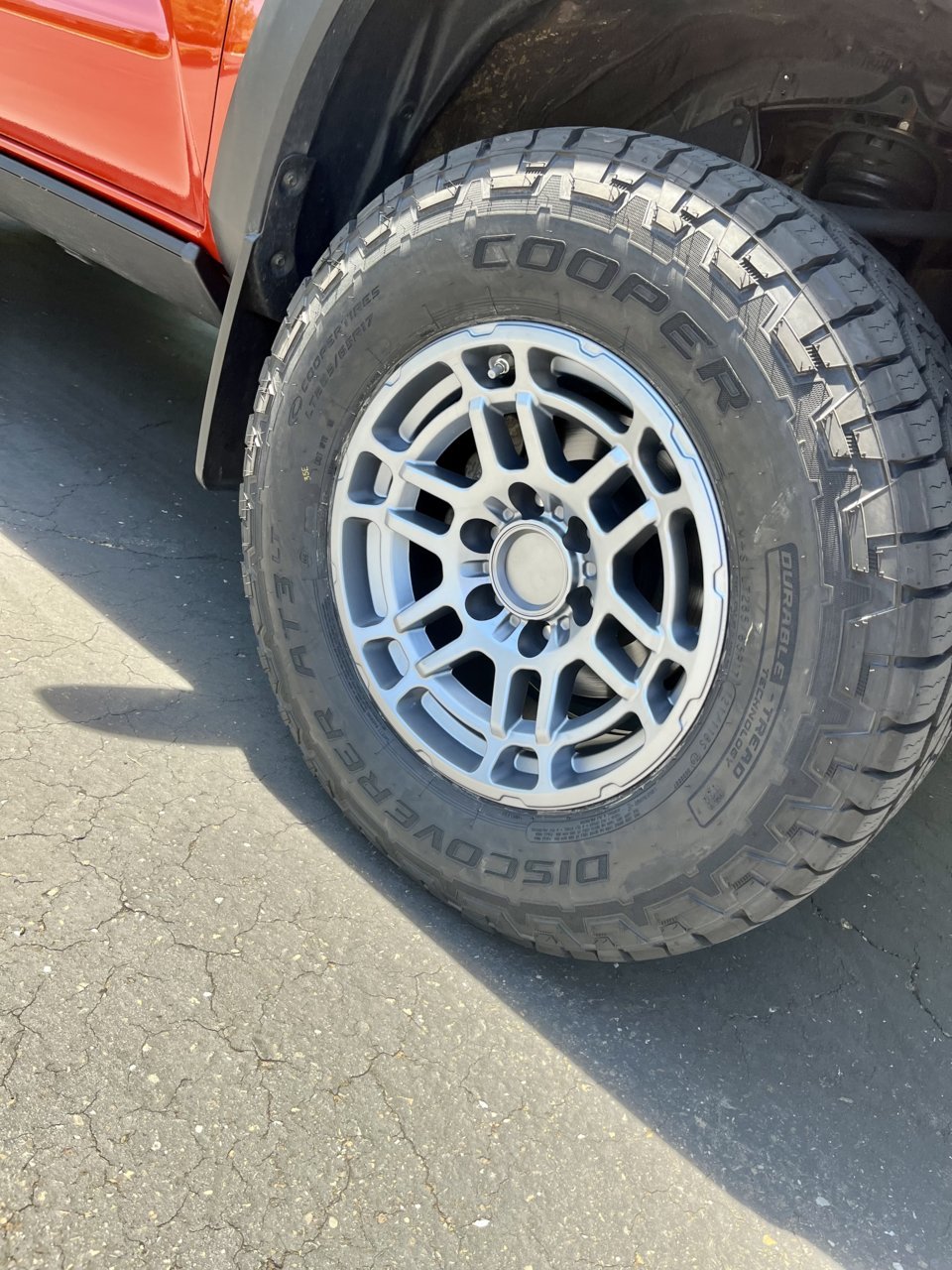

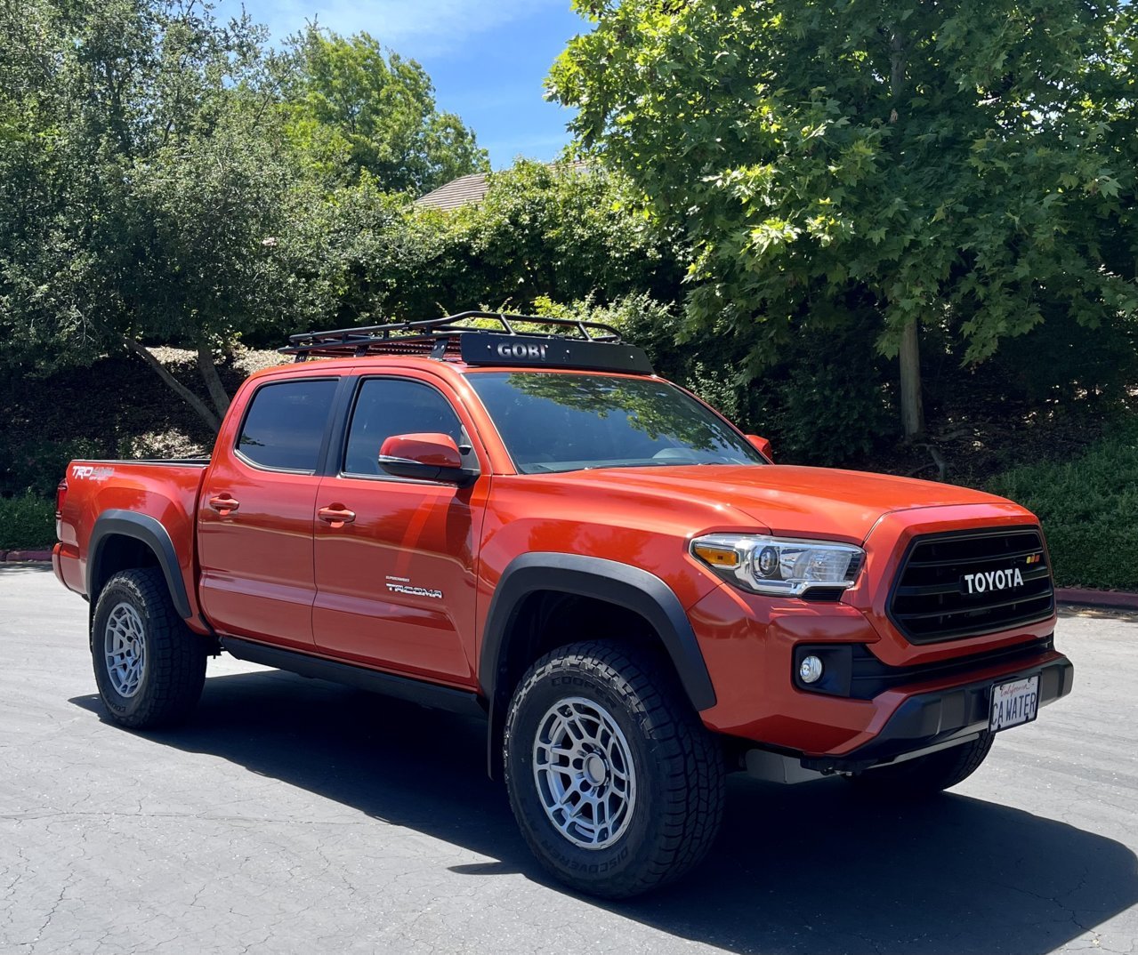

    I got my wheels/tires mounted. They look and drive excellent! It is not ideal to have to grind my Tacoma to get the wheels to fit. But heck, what is a little grinding amongst friends. Here are some pictures.
    2022 TRD Trail/Pro Replica Wheels, 17 x 8.5, 0 offset (Matte Gunmetal)
    285/65/17 Cooper Discoverer AT3 tires

    Man that looks clean! I appreciate you sharing, and I appreciate your understanding.
    Shoot me a message, and if you like, I can work out an additional discount for your troubles.
    -Dustin
