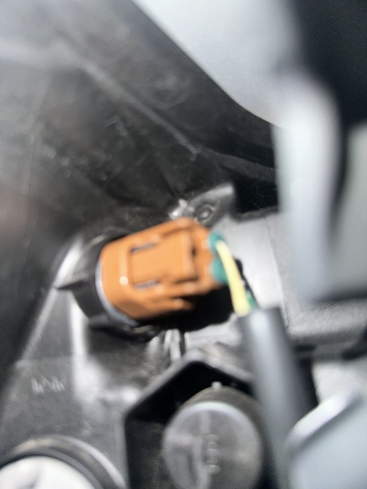

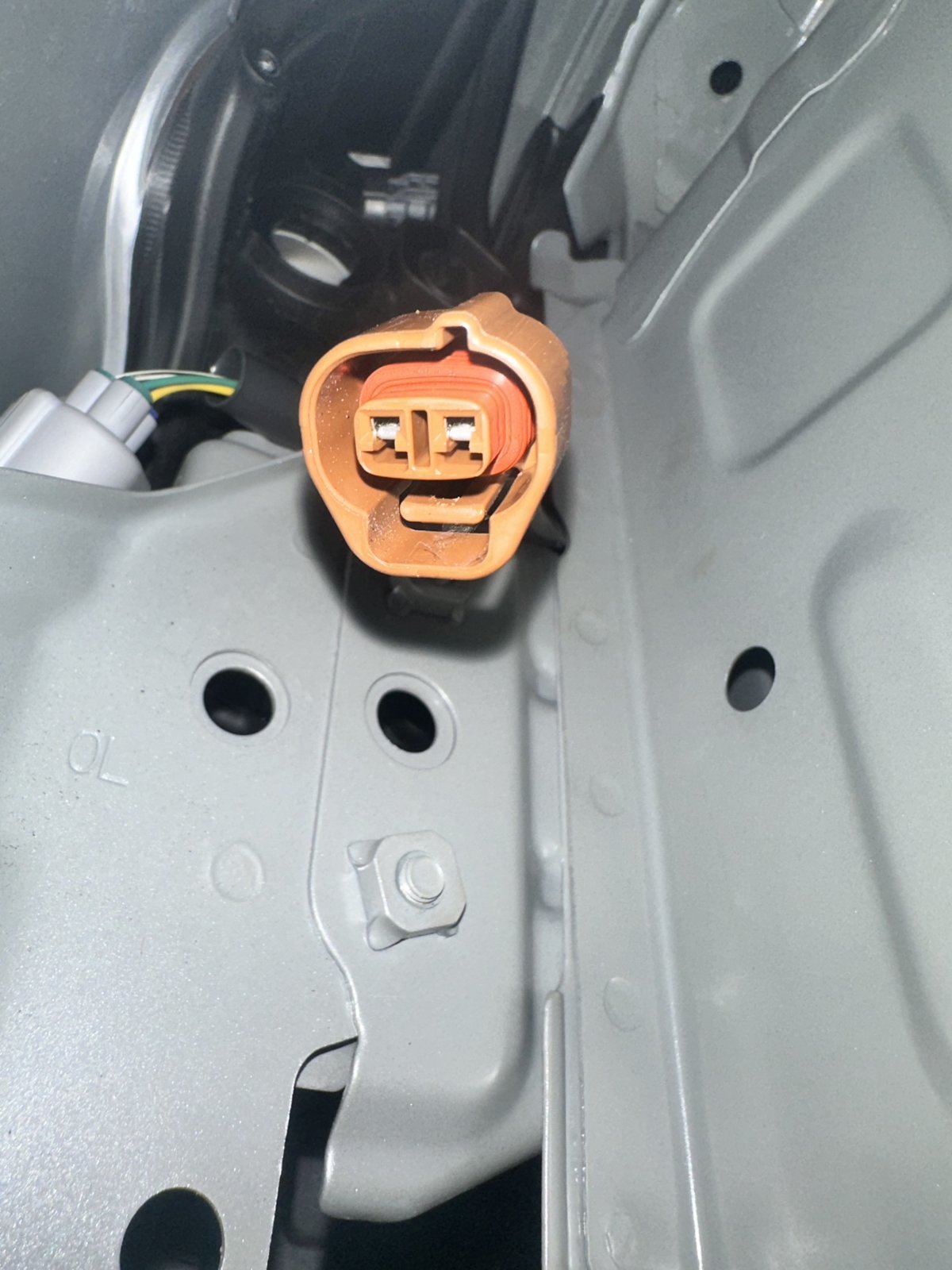

    New photos. Will these work

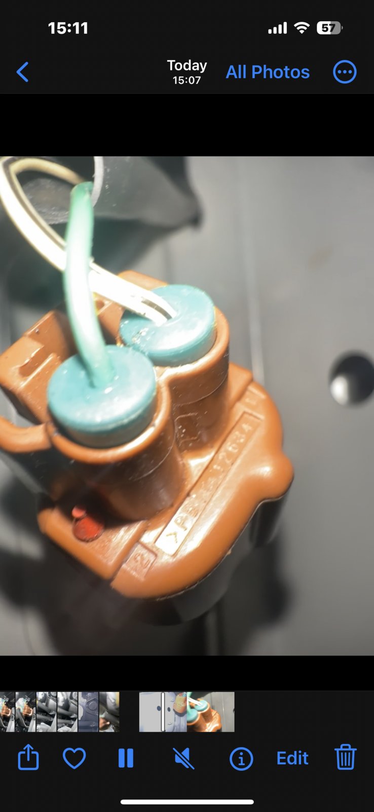

    More photos

    Yeah, that's good. Unfortunately, it's the opposite of my Tacoma sidemarker so I'll have to redo.

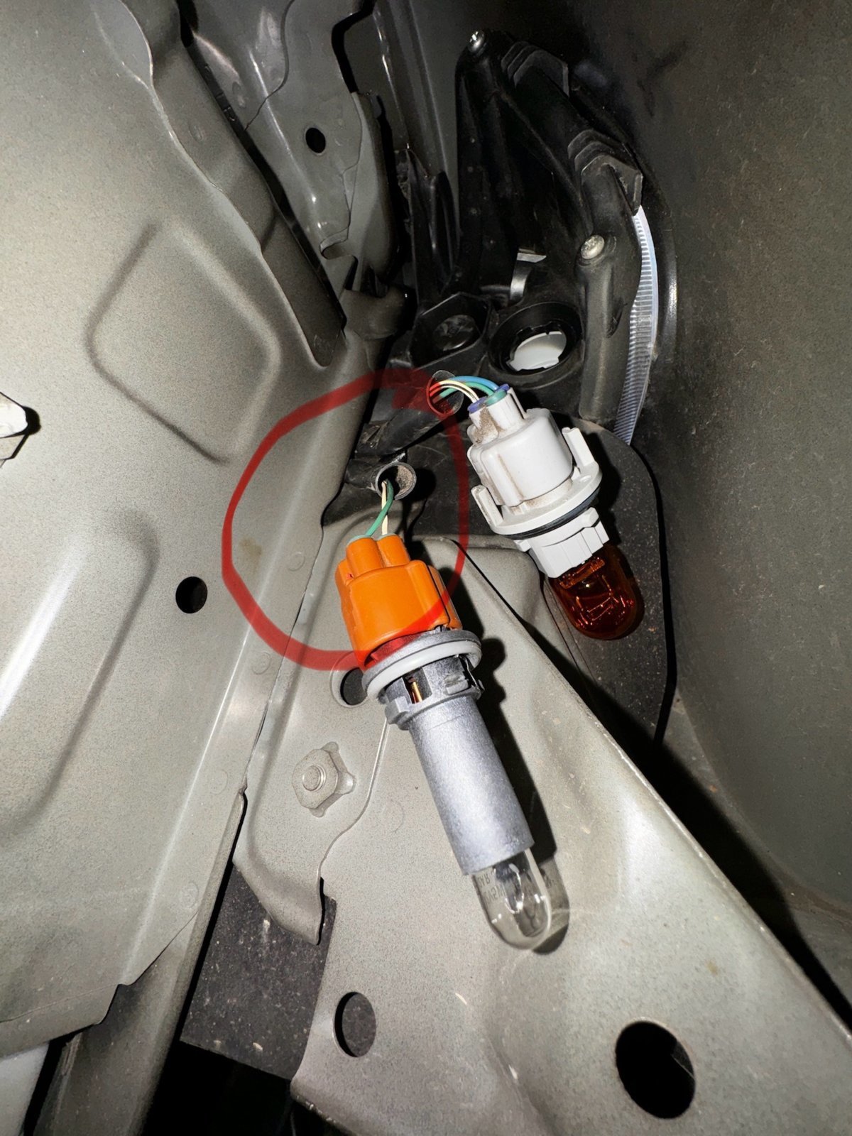

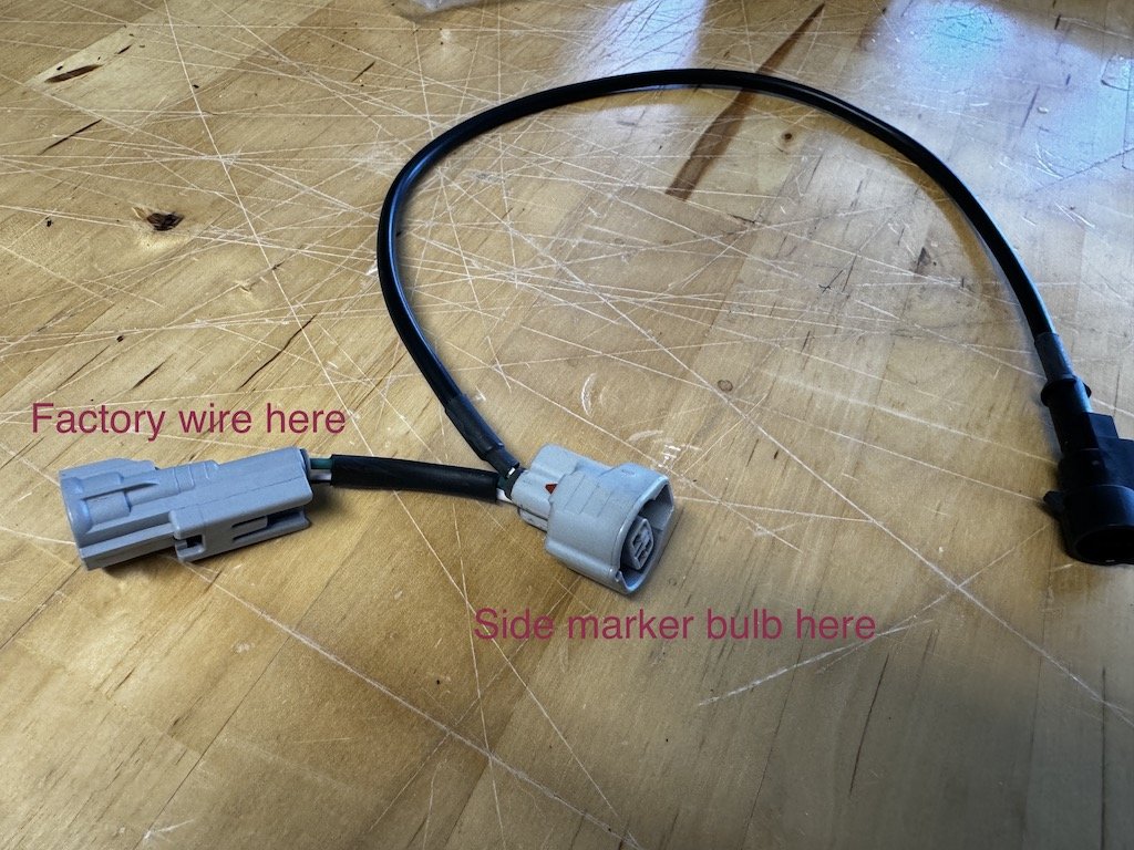

    I finally had a chance to spend some time on this and I'm afraid the harness we talked about didn't work. The connectors are correct - I was able to insert it inline with the side marker light but the fog backlight did not light.
    For reference, here's a photo of the harness labeled for how I used it. The side marker illuminated correctly, so that part of it was fine, but the SS3 backlight did not receive power.

    So check polarity. Maybe they are all the same after all? I don’t own a 4Runner so I can do this part. Green is positive and white w black stripe is negative or ground. If we only need one harness for both Tacoma and 4Runner, that’s great. You can send it back and I’ll swap it over.

    Looking at the photos it seems I may have misinterpreted polarity. Man, I really don’t enjoy guessing on these things. Anyway, easy to swap it over.

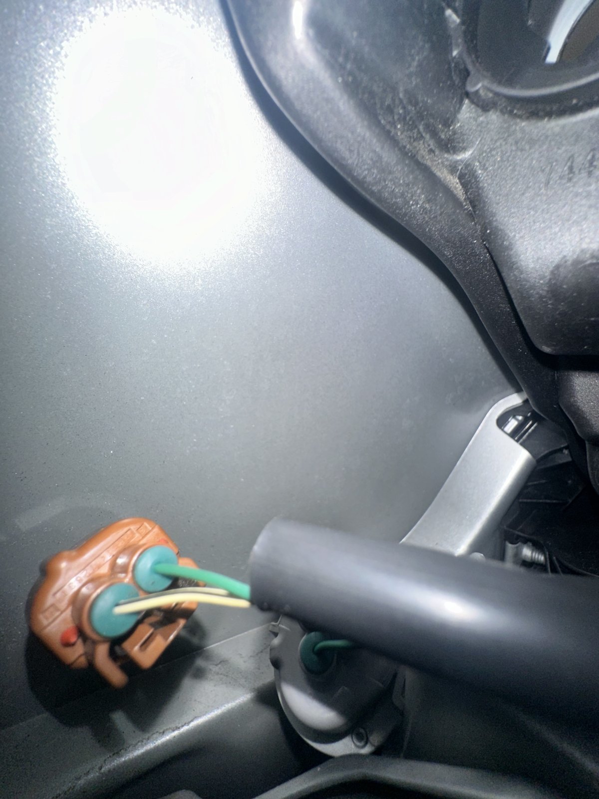

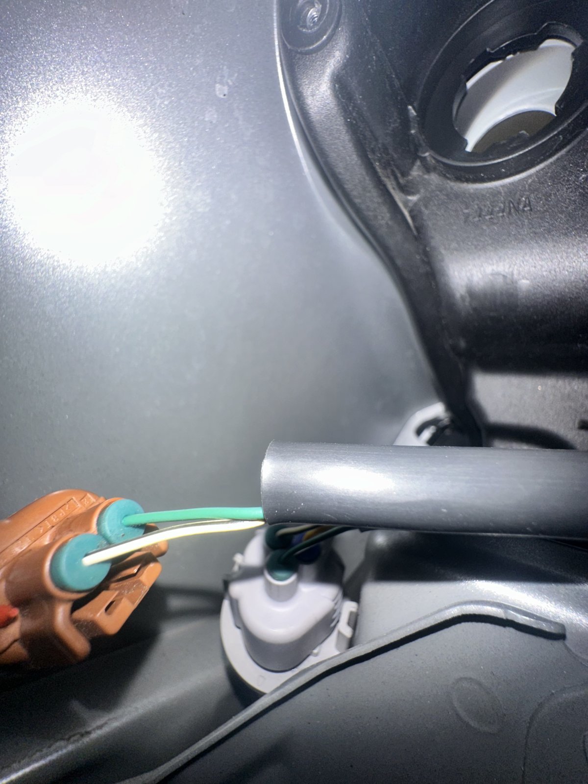

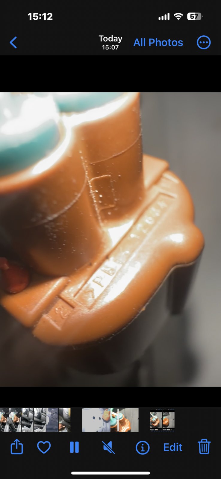

  18. May 23, 2024 at 9:10 AM
    #38
    ravenchorus
    ravenchorus Member
    Jul 30, 2021
    #372692
    13
    Oregon
    2021 TRD Off Road Access Cab, Army Green
    Is this what you're looking for? The circled wires/connector are where I inserted your harness.
    My wife isn't taking the 4Runner today so I left the fender lining open so I can get you more photos today if you need them.
