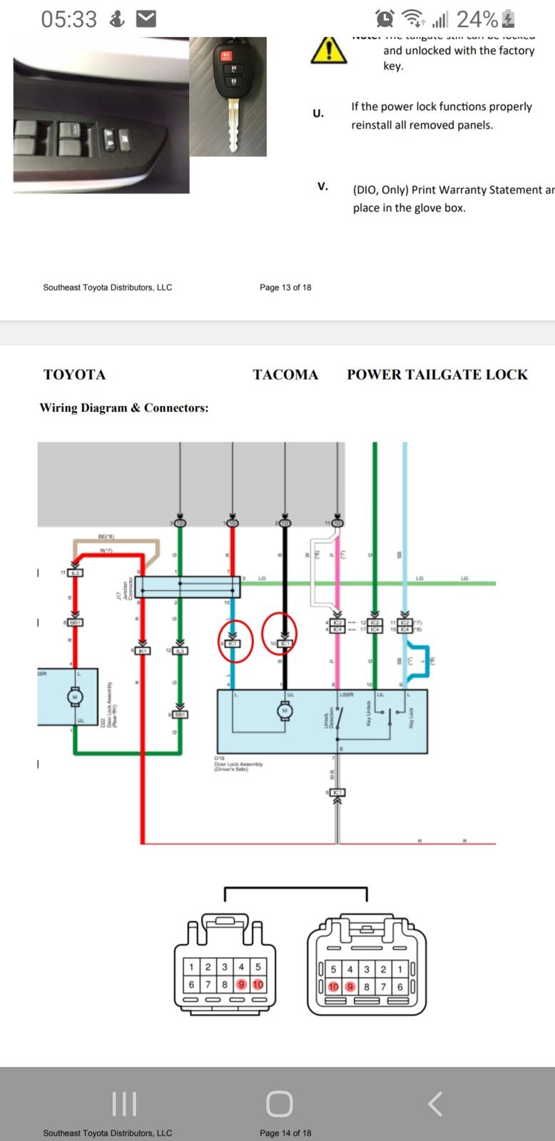

    Power lock could be the issue and cause a parasitic draw.
    They way they add its circuit, it could keep CAN modules awake and they will drain the battery for sure over extended period of time
