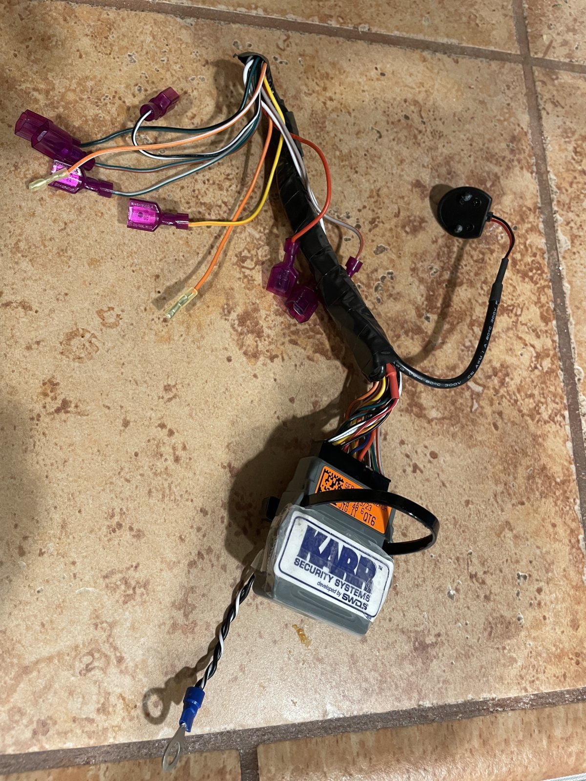

    Even with the Karr sticker on window, dealer still denies they installed one- or disabled it.
    I still blame it on the Karr alarm. Some of the wiring is still there. I'm 72 yrs old & can't look up under dash to see if the box is still there. 2 places load tested the battery & said it's ok. I can't find anything else that could have run down battery. Headlights go out on their own, leave a door open & interior lights go off after a set time.
    I am still considering battery replacement. In the desert, batteries die all the time. I can buy a Autozone battery & if it fails anytime during the 3 years, they will replace it. You can even carry it in & they are everywhere & are open 7 days a week. Dealer won't accept a battery not in your truck. I can go to Autozone & be out in 30 minutes. Dealer? 6-8 hrs, even with a appointment. This would have been a shitshow if this battery had failed while we were on vacation in mountains. At least a 2 hr drive to a dealer & if it was a Saturday afternoon..........
    I will have someone remove all traces of the Karr alarm, probably the same guy I used on my 2nd gen.

    So- since picking up truck from dealer, battery has gone down twice. I called again to verify there's no alarm on my truck, even though there's still a button under dash & Karr sticker in window. They said no. I charged up batter & took it to my stereo shop & they removed this. Said it was hooked up & fully functional. Liars! I taped the window sticker to the box. He said it had a short & was draining battery. I'd believe him before dealer. All they do is lie. And before someone says "Why didn't you remove it yourself?" I'm 72 & disabled, so getting under dash is not possible. I trusted dealer to be honest with me. I will never go back there- ever!

    I find it odd the Toyota has no name on battery, no barcode, no date, nothing, Just a black generic battery. I had stereo guy load test the battery again and battery is still fine. He sells Interstate.

    It's been a few weeks now- I swear removing that Karr alarm has my truck running better. It idles smoother, plus- it starts every day now!
    Now the funny part. Dealer called me yesterday & said they did some research & said they now agree my truck had the Karr alarm installed! Well, I can sleep at night now knowing I was right all along. They told me I could bring truck in & they would remove the alarm at no charge. I said you had your chance to remove the alarm when I brought it in w/ dead battery. I told them alarm was already removed on my dime. She offered me a free oil change as compensation. I said no thanks. She offered a credit towards any future work not covered by warranty. I said no thanks. She offered to send me a check for the $80 I spent having it removed. I said thanks. She's also giving me the free oil change anyway because it should have never came to this. Sort of a win I guess. Best part was them admitting they were wrong.
