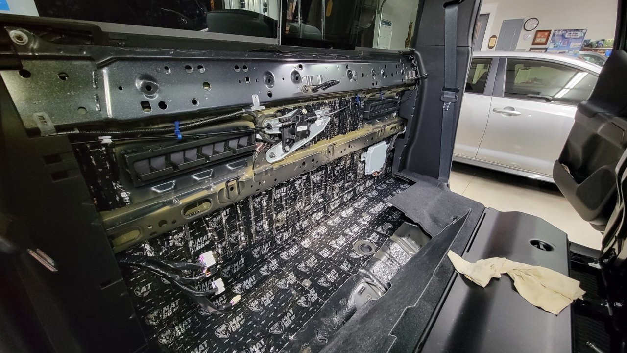

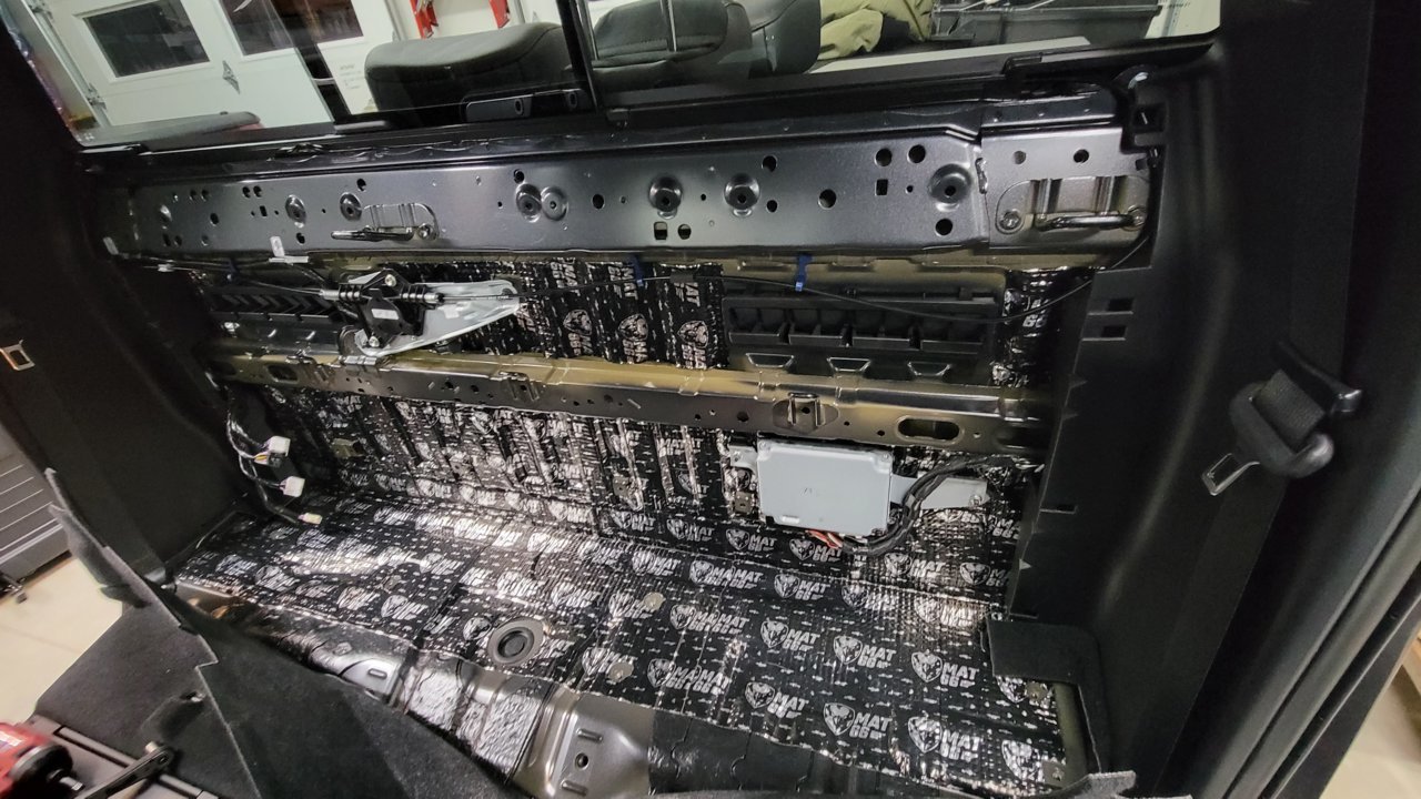

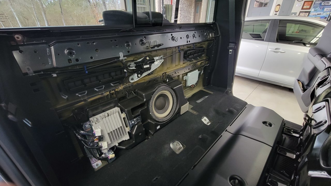

    I "Dyna-matted" the rear wall this afternoon with 80mil material.
    Before:
    I unbolted the window motor and parking sensor module and matted behind both.... very easy to do. I also tucked the mat as far forward as possible without removing more than what's shown. I also mat'ed the backside of the plastic panels because I had some extra(no pics).

    That sound deadening came out awesome. How much work was it to remove the back seat and under seat compartment?

    It wasn't that bad. I only removed the back seat backs and rear plastic. I wish I would have put Dynamat on the bar that goes across and the bar that's right under the window. The video I watched didn't do that and I didn't either. I've since saw at lease two videos that showed doing it. I'll likely add to those areas in the near future. Also, now that i've done the rear wall and under the backseat, I can easily remove the back seat bottoms and continue on forward if I want to.... kind of in stages. ;)

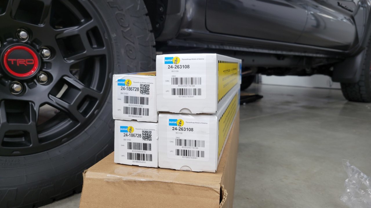

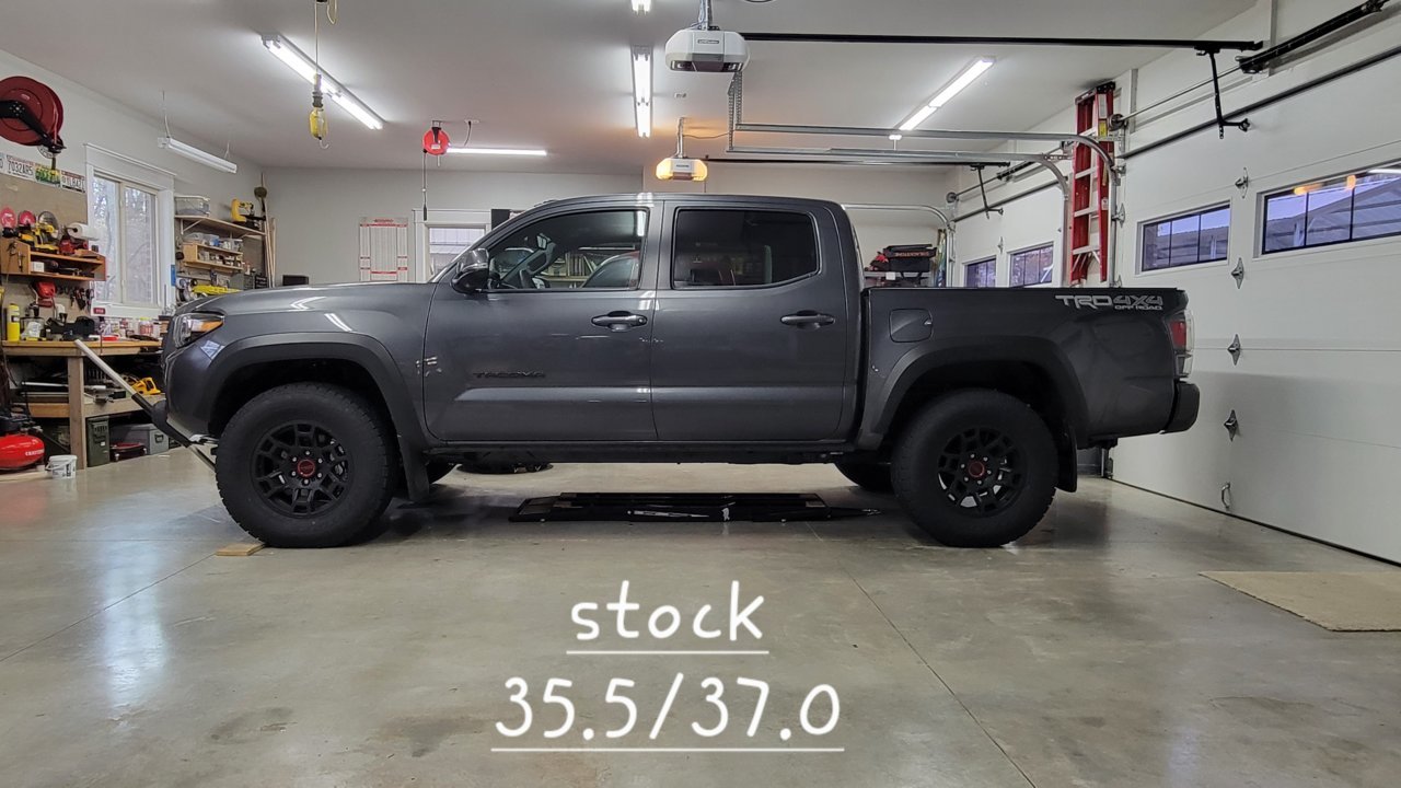

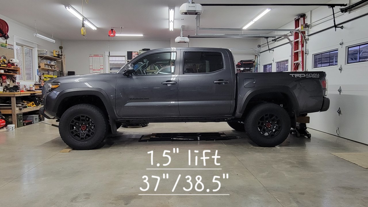

    How quickly things can change. I was planning to wait to lift but the 265/70r17 tires has pushed me to go ahead and do it. I've ordered Bilstein 5100's and plan to use 4th perch to get 1.55" in front. I've also ordered a Headstrong 3 leaf AAL for the rear. This should provide a 1.5" front/rear lift. I've ordered a ECGS bushing and will swap it out while I'm there.
    I played around with floor jacks in the garage to simulate a 1.5" lift. These pics helped me decide on lift height. I'm wanting to keep truck pretty close to stock.

    Holy crap, Hot Shot Offroad is amazing. I ordered these 5100's early yesterday morning and received them TODAY. Great price and truely amazing experience.
    Gotta wait for the Headstrong progressive AAL and the ECGS bushing.
