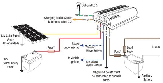

    Redarc BCDC1225D charger in my bed charging a Battleborn lithium battery. Ran a small (I think 16ga) white wire grow an add a fuse tied into an ignition on fuse all the way back to my Redarc in the bed.
    Here is what the Redarc diagram shows is required. This little wire satisfies the “low voltage trigger setting”.
    One issue I had with my original setup was seeing actual charging & power draws correctly. I corrected this by making sure all of the negatives made it to a bus bar and reading off the end of that.
    Do you have any pictures or diagrams of your setup?
