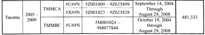

    Just found out about this, I have a 2006, and from what I’ve read the airbag light should come on due to the bad clockspring? Mine hasn’t. Everything works except for the cruise control. Which my SR5 trim states it does have CC. So would I be eligible for a recall? Really trying not to spend $250 on a new clockspring

    This is a 3rd gen thread.
    Your year had a spiral cable recall on some trim levels. If your VIN is in the range identified in the DOT filing, then it is covered by the recall: https://static.nhtsa.gov/odi/rcl/2012/RCDNN-12V092-9678.pdf
    Another way is just to plug your VIN into the Toyota recall web page and see if there are outstanding recalls against it: https://www.toyota.com/recall
    Beware if everything works except the cruise control, the defect may in fact be elsewhere, like a bad switch (the cruise control stalk) or bad wiring.
