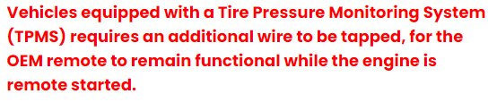

    Mine is push to start , the harness promises plug and play:

  11. Mar 19, 2023 at 6:35 AM
    Taco23Trl
    Taco23Trl Well-Known Member
    Jan 8, 2023
    #415046
    48
    Brandon
    2023 Taco Trail Edition
    So far…. Added fog lights swapped halogens to led’s, interior lights to led’s, bed lights added, led/strobe brake lights, trying to figure out the right leds for turn signals.
    Thank you! Will definitely do that.
