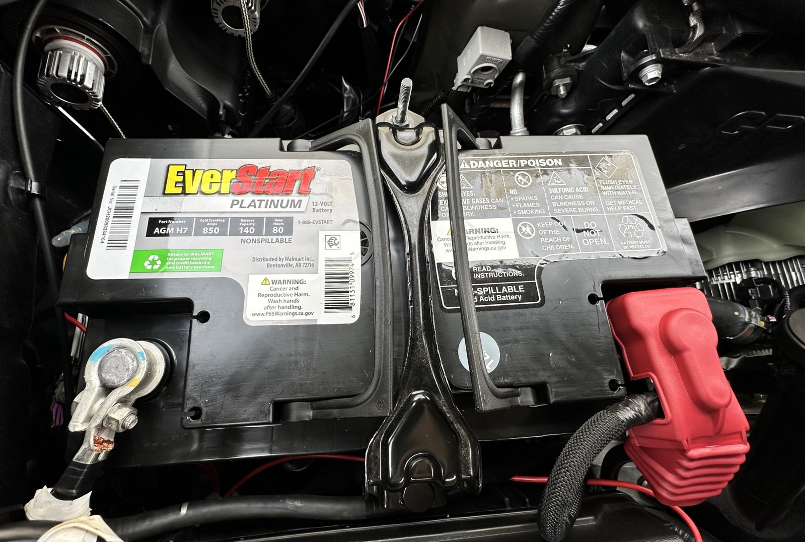

    Battery Tender went on yesterday around 5:30 PM. It's now 7:15 AM. That's 13 hours and 45 minutes, give or take.
    The DelTran has a four cycle charging system.
    COMPLETE 4-STEP CHARGING
    Smart charger technology assures the correct level of power is sent to the battery at all times.
    1. Initialization determines if the battery is connected correctly and battery’s charge level, composition - Flashing Red Light
    2. Bulk Charge brings the charge up with full charge and constant current - Solid Red Light
    3. Absorption Mode slows the charging down until the battery reaches full charge - Flashing Green Light
    4. Float/Maintenance Mode keeps the battery charged without overcharging or discharging Solid Green Light

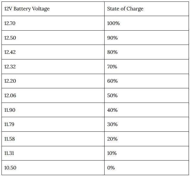

    The red light is still solid indicating that it hasn't completed the Bulk Charge Mode. I would have expected a battery with 12.75 volts in it to have completed by now. According to this chart 12.75 is FULL. Maybe it would have spent 3 to 6 hours normalizing across the cells in the battery but 13+ hours feels like too much.
    https://blog.ecoflow.com/us/battery-voltage-chart/
    That means there is one hell of a parasitic draw, or I'm starting to lean away from the alternator and towards a bad battery. Like it takes a charge but has an internal short in the battery somewhere.
    I'm still drinking coffee this AM and getting ready for the day so we'll leave it on a little longer but I'm thinking that tonight, I'm disconnecting the battery and charging it w/o the potential parasitic draw effecting it.

    I had a premature failure on my 2018 battery the first year. I replaced it with an optima yellow top and never looked back.
    I didn’t want to mess around with warranty and getting another crap battery.

    You've either got a battery with an internal short or a faulty charging system.
    (New batteries do go bad)

    Just pulled the charger off of it. Was at 13.2v right after and then fell pretty quick to 12.4 as the battery normalized out. Letting it sit for a few minutes and going back to check.
    Neighbor saw the hood up and came by. Mentioned he had an interstate battery do the same thing because the guy at the shop over torqued he battery tie down and actually caused the short. He looked at mine and thought the same thing. A little plastic deformity around the clamp / tie down. Who knows....
