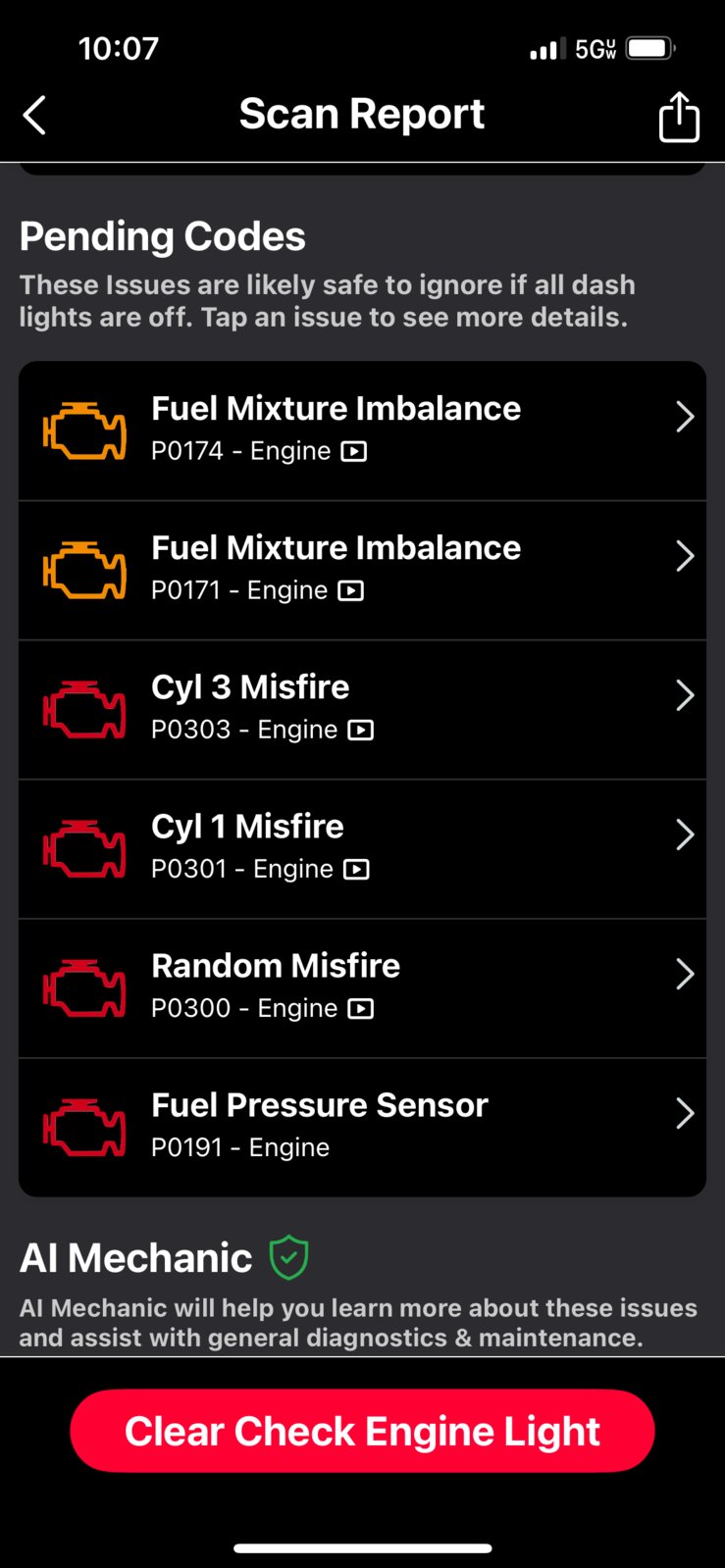

    Any updates? The paragraph above could read exactly like my experience this morning with my brand new ‘23 TRD Off Road, also with 3k miles. I’m sitting at the dealer right now.
    A friend and coworker sent me this post, and I’m now formulating my own argument if they try and pull the bad gas BS with me too. I go to the same Speedway at the same pump every time, with my truck and my wife’s car, and she’s never had any issue.
    Here are my codes:

    You are getting screwed…….DRY

    OP- Toyota has a TSB(Toyota Service Bulletin) for the faulty fuel pump, specific TSB(20TA02). FUEL PUMP is known to be faulty from factory, some have issues with fuel smell in the truck following startup, others have bad fuel rail pressure(under 70PSI) causing engine performance issues(ECM will place truck in limp mode due to faulty pump signal/pressure)
    Dealer should cover all work pertaining to the pump, they can bill Toyota corporate directly via the TSB. Don’t let them scam you out of $ the factory will cover.
    Search the forum for “fuel pump TSB” or TSB 20TA02, much more info from others with the remedy too.

    Just an update on my issue from yesterday… I picked up my truck today. It turned out to be the Fuel Pump Control Module. They replaced it and gave me a loaner under warranty. Fingers crossed that that was the fix. Dealership was great and did their due diligence.
