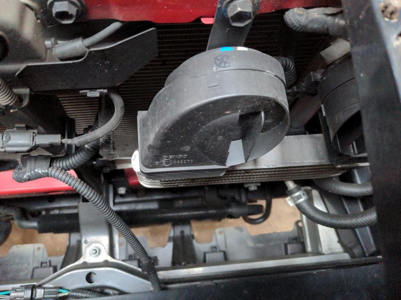

    My 2020 has one in front of the radiator.

    2019 was the last FULL production year with the external cooler. Some early 2020 model year trucks had them, but it was eliminated by the end of 1st quarter
