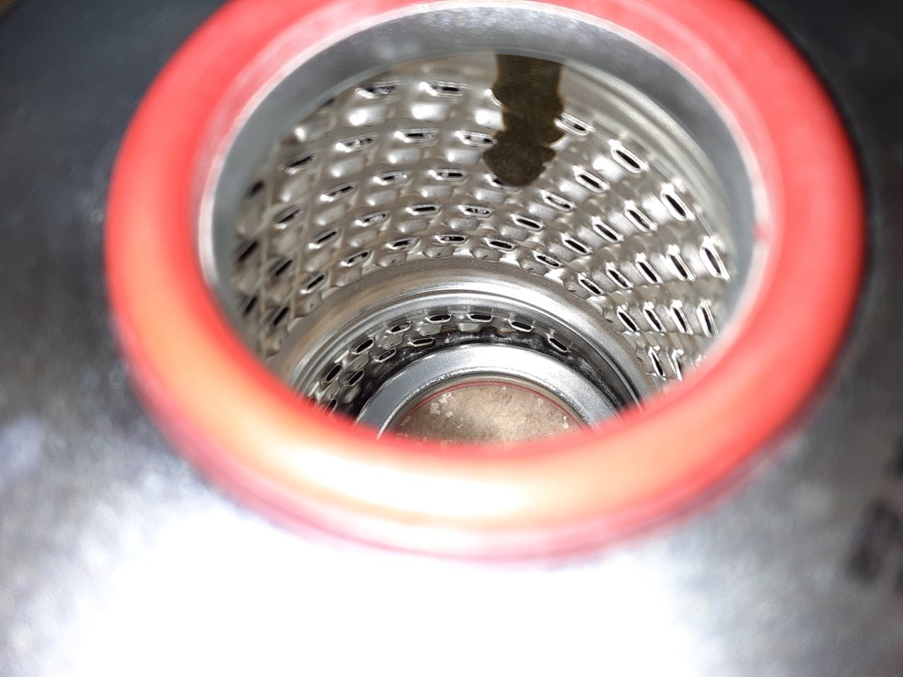

    Hello Everyone, I will be performing my first oil change, but the TRD filter I received has what I think is resin that's run down covering some holes. Is it safe using a filter in this condition?

    I had the same thing in my Royal Purple and Amsoil version of the TRD filter. Installed it anyways, then when I did my oil change at 5k, the resin was still there. So I don't think it will break down and end up in the engine.

    Its fine, if you trust your dealer.
    I did so on my last two Toyota's, didn't have a single issue, even purchased the extended service plan for the Wife's highlander so they did oil changes and tires for another two years. That isn't always the case though (ask the guy who was missing his filter entirely).

    Just received another TRD filter in mail today & it's same way with a bit more resin, so maybe it's normal IDK as I'm new to this. Thanks!

    I'm more concerned about the filter's cheese grater center tube, when there's a center tube in the filter cap already. If you're "lucky" the holes on the two tubes will occlude each other, then all the oil will flow through the bypass valve.
    Of course there's no way to tell if this condition is happening. The engine will run fine in the short term on the effectively unfiltered oil.

    Considering toyota developed the oil filter housing and the trd filter, Ima go ahead and say, it will be fine. Ski
