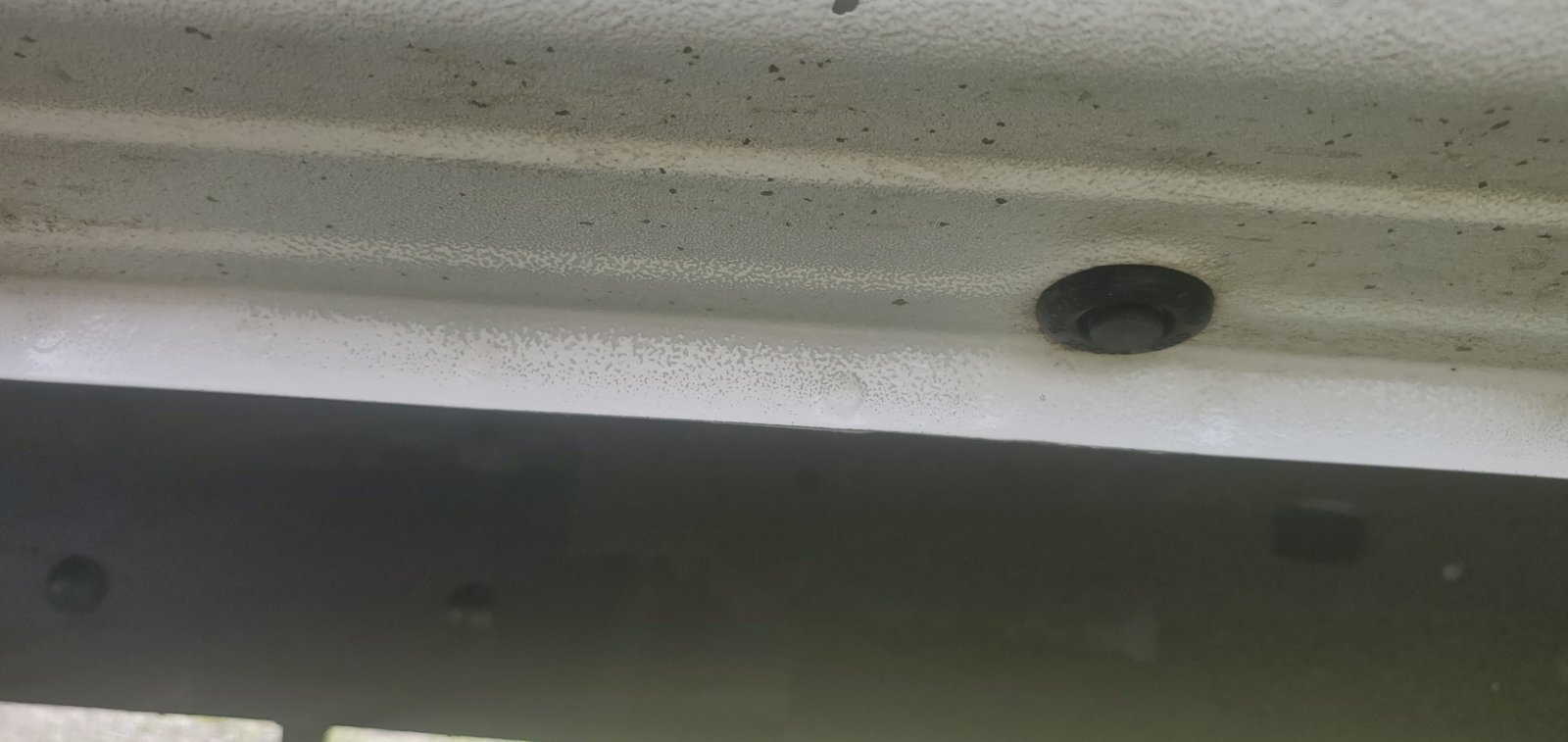

    My 2014 /130,000 miles Tacoma is white, and except for the normal, front-facing random chips you'd expect on a ten year old truck, (front bumper here and there, leading part of the hood, a-pillars, one above the windshield...) there is no wide-spread scattered chips like this. For me, the tell-tale on yours is the leading edges of the rear bumper and the door-jam. How the heck do those areas get chipped like that in 5,000 miles? Precise hits right on the edge of the bumper all the way down?? Not likely. I could go around my truck right now and count the chips: 10 or less.
    Many of those on your truck don't look like chips. They look like flakes or pieces of paint letting go. Is there any primer damage at these spots that would come with a rock chip or any bare metal showing at the spots? Except for the plastic bumpers, that's what you see from a rock: not this. Even the plastic sometimes shows a little damage from a rock or gravel chips.

    This is a good point. None of the chips go through the primer (or ED as Walrus called it). There is no evidence of impact on any of the chips.

    Yeah: The irregular shapes of the "chips" looks odd. Obviously missing paint, but they look more like bug-splats than small rock chips especially the rockers.

    Some of that may be the anti-chip coating they apply on the rockers. (the bumpy-looking stuff) My 2014 has this and it has some "give" to it. There are no chips on my rockers where this has been applied.

    Yeah, i don't really have anything to compare it to. Just seems strange that my thumbnail could leave an indentation. Above the rock guard my thumbnail does not leave a mark. Also interesting, that in the rock guard area the chips seem to go straight down to the primer/ed - the rock guard material flakes off with the paint.

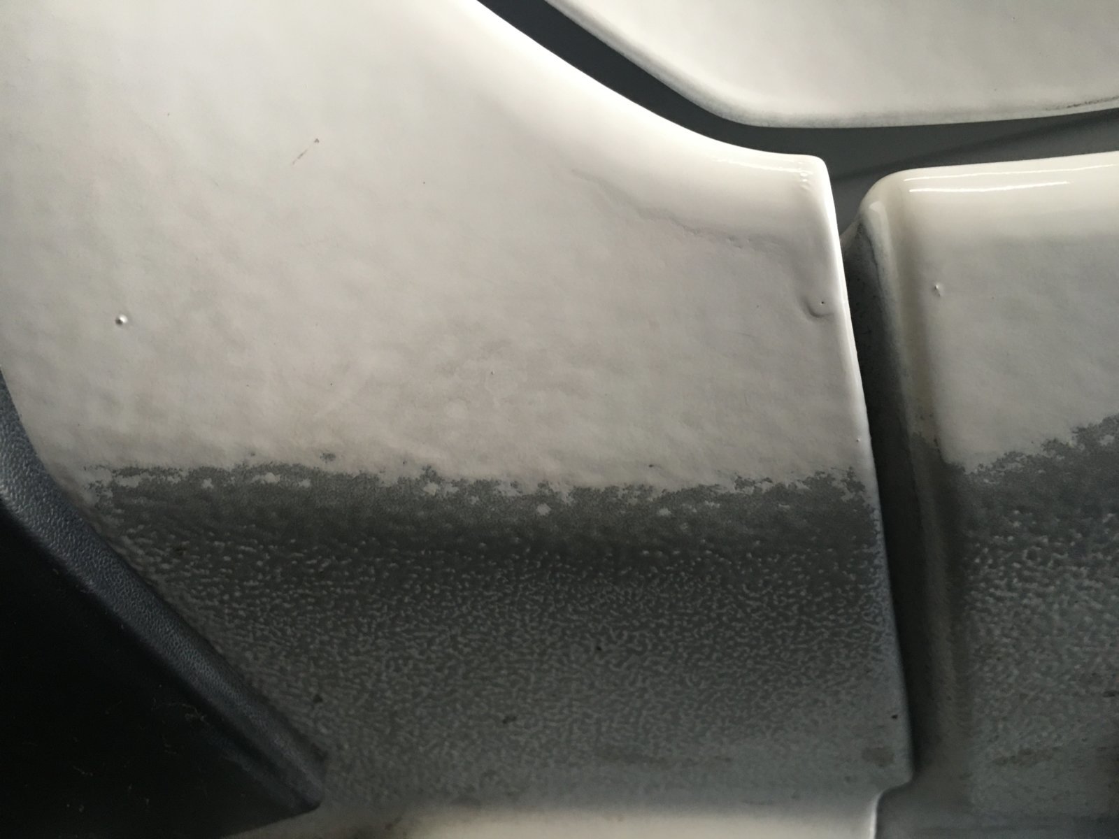

    I always post this when I see others having similar issues. I bought a new 2023 and when I got home from the dealership, I noticed a smudge on the bottom of the passenger's rocker panel. When I rubbed it with a rag the paint came off on the rag. Both rocker panels and the bottom of the front fenders. Use rubbing alcohol on a rag and see if the paint comes off. If it's like mine it will easily come off. Toyota repainted mine. I tried to get them to replace the truck, but they said nope, that's what the warranty is for.fender2.jpg

    Woa. Ok thank you. I just tried this in a small area and the paint rubbed off.
    Holy crap.

    It’s not just Toyota with white paint. Hyundai/ Kia, Honda, Jeep to name a couple.
    All colors can fail over time but white seems to be more common with delaminating for any carmaker.
    With that said there are white Toyotas that come into my shop which are 10+ years old with no paint issues. So I wouldn’t make a blanket statement that all white paint for Toyota is bad……it’s just more common on 040 white.

    Curious if you could hypothesize on how the paint could have been misprepared that would cause rubbing alcohol to make it dissolve? A mistake in the factory - forgetting to add hardener to the mix or something? Or would the mistake happen wherever Toyota gets the paint itself made?

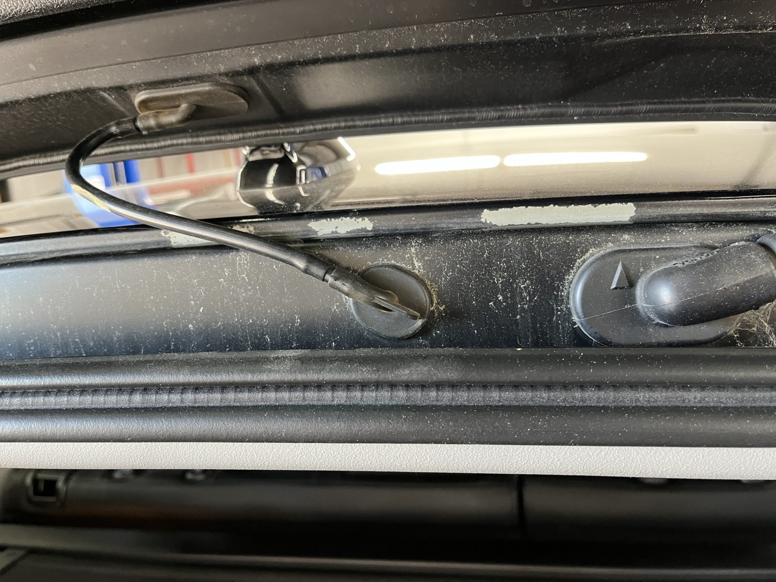

    As luck would have it I have a 2019 Honda CRV in the shop today, IMG_0311.jpg as I speak…..,just opened up the rear hatch and look! It’s starting at the back edge of the roof. Car is black.
